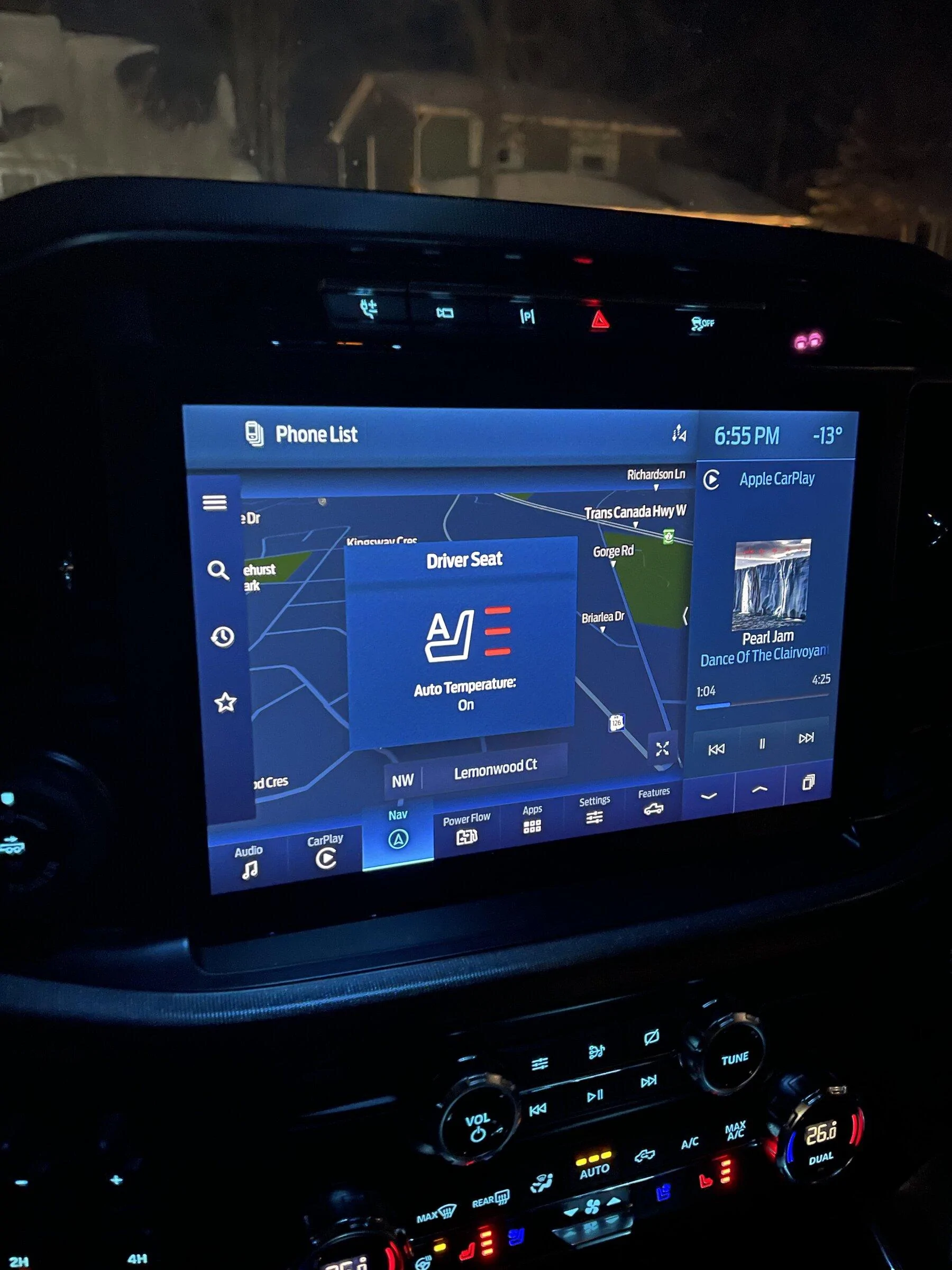

Can someone explain to me what auto seat temp actually does? I dont get what the purpose of this is.
