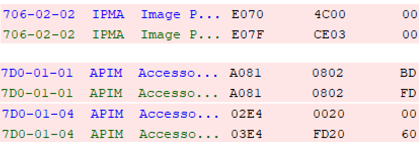

I’m wondering how I can get the same for mine. Because in Rock crawl I don’t get those options
If you are up for a little experimentation:
Blue is a random 21 Platinum FX4
Green is my 21 Tremor 402A
I think the secret sauce is probably within these lines. I would recommend you bounce your trucks values off of mine (green) and the spreadsheet.
Thank you for this!!

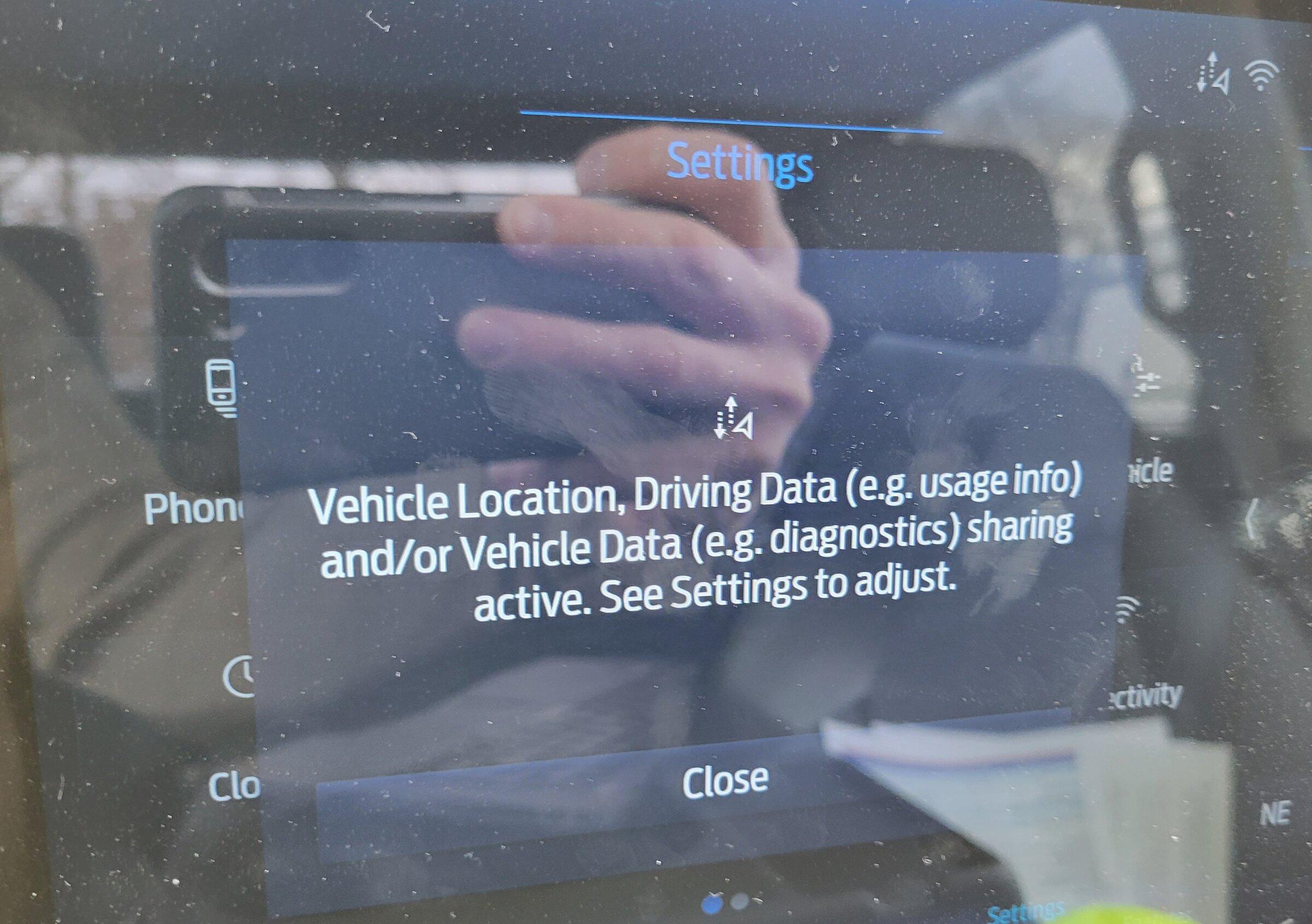

Anyone getting a message on the Sync 4 screen after unplugging the ODB adapter that reads,
"Vehicle location, Driving Data (e.g. usage info) and/or Vehicle Data (e.g. diagnostics) sharing active. See Settings to adjust."
It comes on about 8-10 seconds after starting the truck. It goes away on its own.
This message came on after FORScan did not load all the modules properly the first time I used it. I closed FORScan and unplugged the adapter. I have not made any changes to the truck.
That message is completely normal. I see it after making changes in Forscan. It goes away and doesn't return until I make changes again.
Mine only comes up if I don't have my phone paired to Bluetooth.
I will check that out. I did turn off Bluetooth before I connected to FORscan. I swear I have never seen that message before. Maybe I just missed it in the past. Thank you!
Okay. I will check that out. I know I have not seen that before. I was just a little nervous about it. I will see what happens when I try another change. Thank you!
