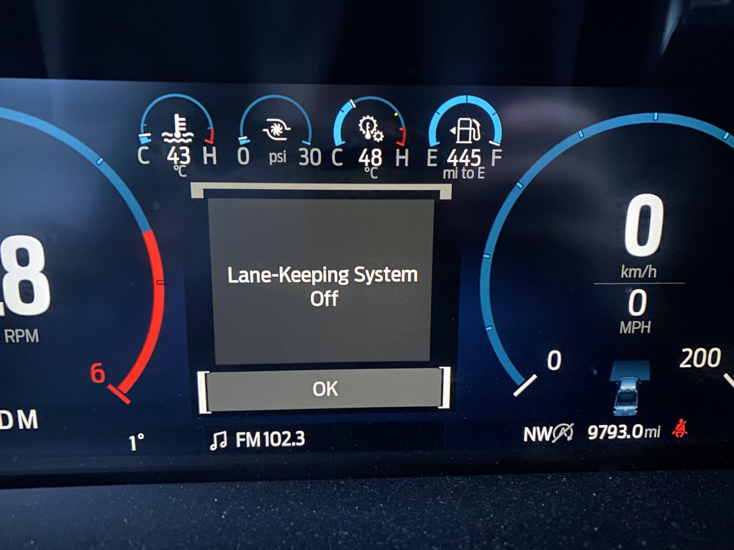

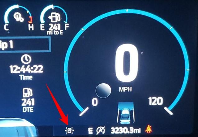

What is with the vehicle icon? I know when cruise and lane keep assist is on it shows it but mine is on all the time. I see some gauges without it. I think I enabled when I first got my truck but I cant remember, it's either that or its the adaptive/intelligent cruise being enabled but it is there whether I have cruise turned on or not.

It's lane keeping assist and you have it turned on; press the button on the steering wheel that matches this image telltale and it'll turn off

I pulled that picture from the interwebs and it looks slightly different, no lines on the side and the front sensing portion shows a vehicle and changes the colour from green to red when in traffic and I’m too close. It is definitely not lane keep assist. I just took these pictures.

The picture above is the Distance Indication feature is turned on under Features, Pre-Collision Assist Menu in Sync so turning that off will remove it.
