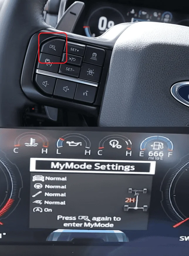

Sounds like Ford was listening and made it possible to save your vehicle modes (steering, suspension, exhaust, auto on/off) for the 2022MY. I believe that is the only major addition to the 2022 over the 2021. This feature fixes an annoyance in the 21's because the modes had to be set every time you started your Raptor.
Ford added a Raptor button to the steering wheel that opens a new menu on the dash (MyMode Settings).
Looks like a great mod for Forscan hacks to tackle for the 2021 Raptors!
Man, that would be nice to adapt to the regular F150 as well! Part # for the raptor steering wheel is ML3Z-3600-AB. I'd volunteer as tribute, but I probably wont have my truck until August.
