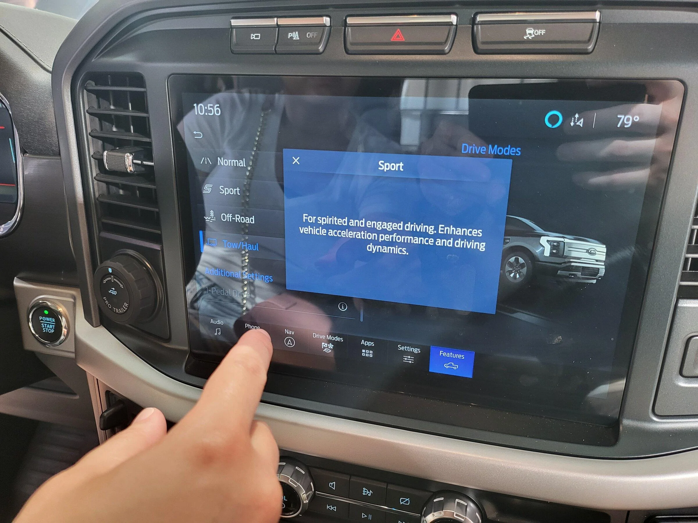

In the truck I saw an option for one pedal driving on and off. I did not see a sub-selection which changed the regen amount, like in my Tesla where there is three options.
I may have missed the feature in a sub menu, or perhaps it only appeared some place I already looked after one-pedal is set to on? I asked one of the workers at the event and they said the option was solely on or off, but maybe they didn't know all the details either? What are the options in the Mach-E?
One other thing, in off-road and towing drive modes, the option for one pedal driving is disabled. So if you're towing and hoping to save a few miles with regen, that doesn't appear to be possible.

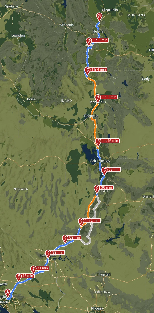

I was asking the same question as I go fishing in a lot in rural areas.
A Better Route Planner online map, I can see all my fishing destinations have some orange sections of the drive and specifies maximum speeds lower than freeway / highway speeds to make it to the next DC Fast charger (L3).
But when I add L2 charge stations, the map doesn't have as much restrictions.
There are some range anxiety sections of driving when only using L3 (EA) chargers when I drive from CA to MT:
Ford F-150 Lightning 2022 Lightning EPA highway + city range / efficiency numbers posted Screen Shot 2022-05-11 at 7.50.22 AM

Many people have mentioned this, but the 3rd party charging networks really need to expand to cover more interstate travel before focusing on urban areas since 85% of EV owners charge at home. This is another reason I opted for the ER battery.
Not sure what your ABRP settings are, but I plan for an 8% SoC arrival at all charging stops. I also only plan one day at a time and always try to stay at a hotel with a charging station so I can always leave with 100% battery.
ABRP is also in "alpha" planning mode for the Lightning since it is approximating what consumption will be under various conditions, so it may do better as they get more data on how it performs in different conditions. I notice that the ABRP estimated energy consumption @ 65mph is very high: 596wh/mi. Try adjusting that to 552 which is what the SR truck is rated for on the highway, perhaps even closer to 500wh/mi since I believe the rated window sticker consumption reflects a 10% charging efficiency loss which isn't important for range.
