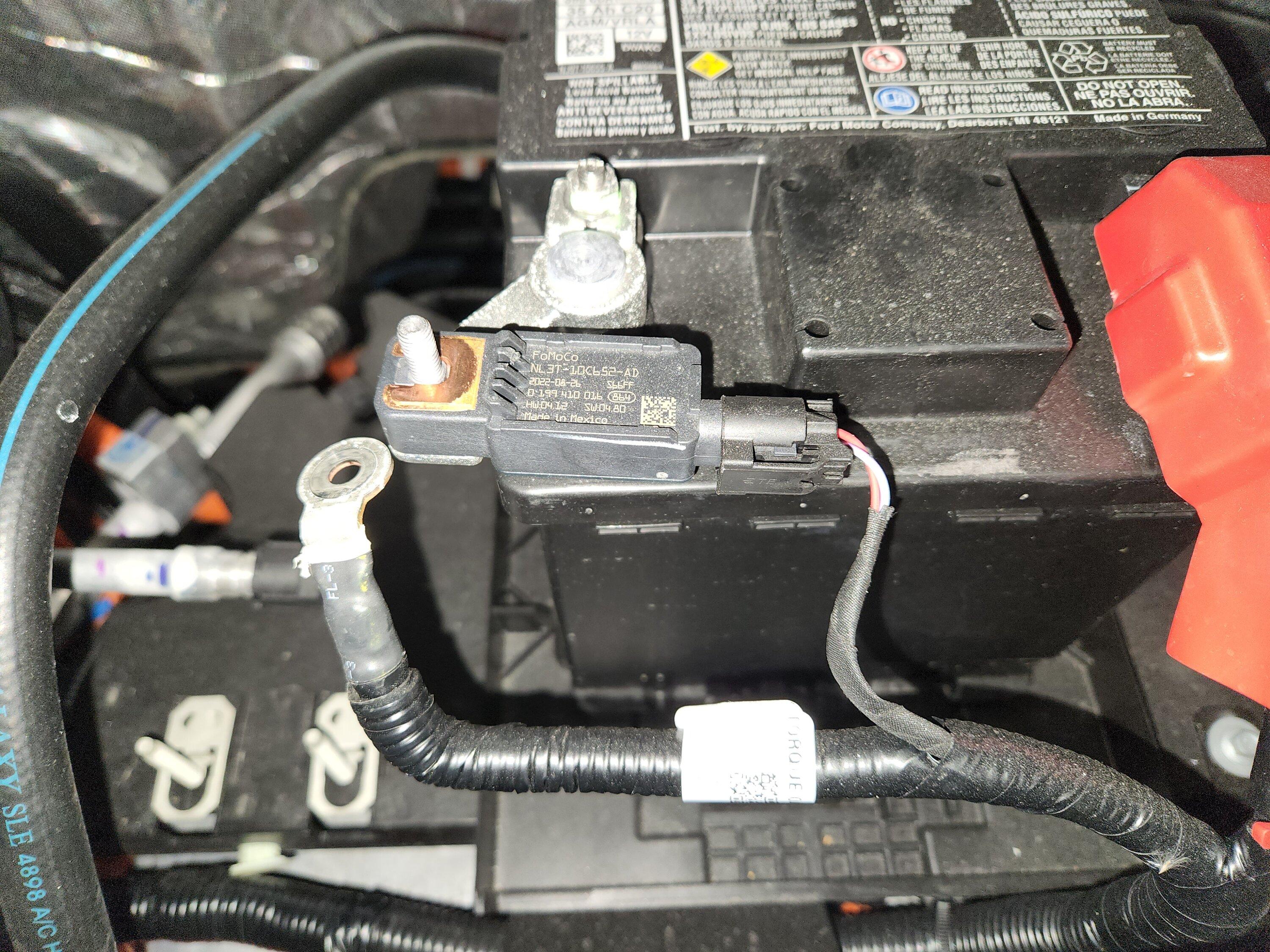

Interesting apparatus on the negative terminal:
Ford F-150 Lightning 2023 Fordpass outage - how not a big news story? 20230121_145013
Looks like a battery disconnect solenoid to me. Wonder how to activate it...
Edit: google tells me it is a sensor not a disconnect
