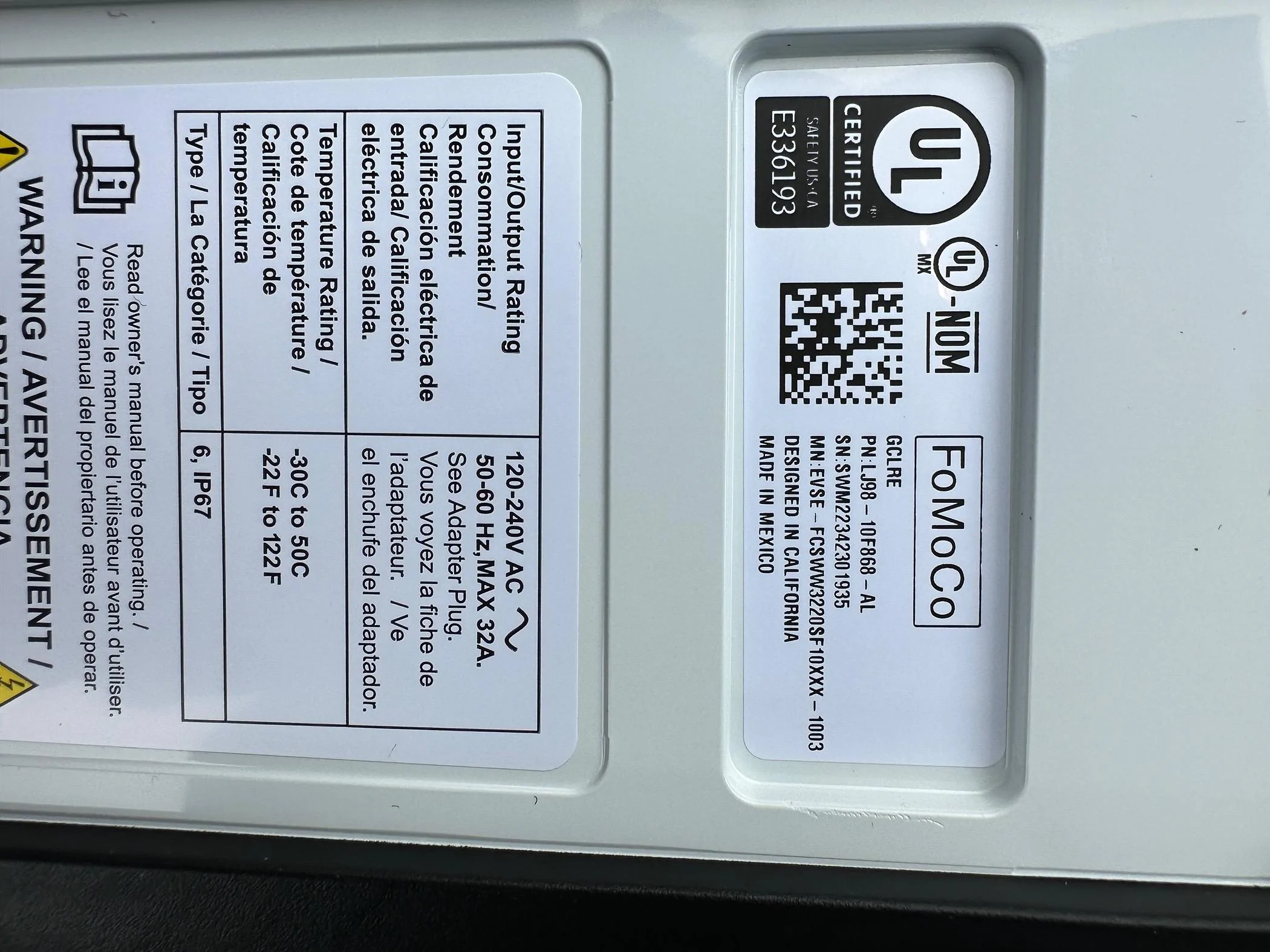

It’s my understanding the SR battery is limited by the truck BMS to max 32 amp max AC charging either using the Ford 14-50 dongle 240v (and 11 amp AC with the 5-20 dongle) OR any other EVSE even if the EVSE is set to deliver at a higher amperage capacity. Is this not correct? And with the ER batteries with two onboard chargers is it limited to 32 amps AC x 2?

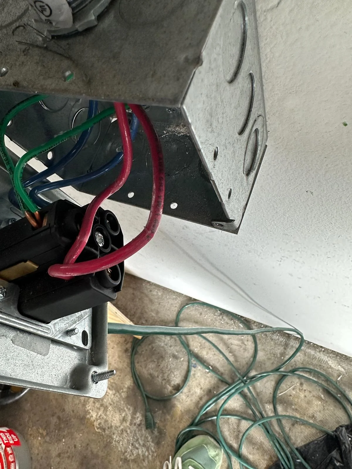

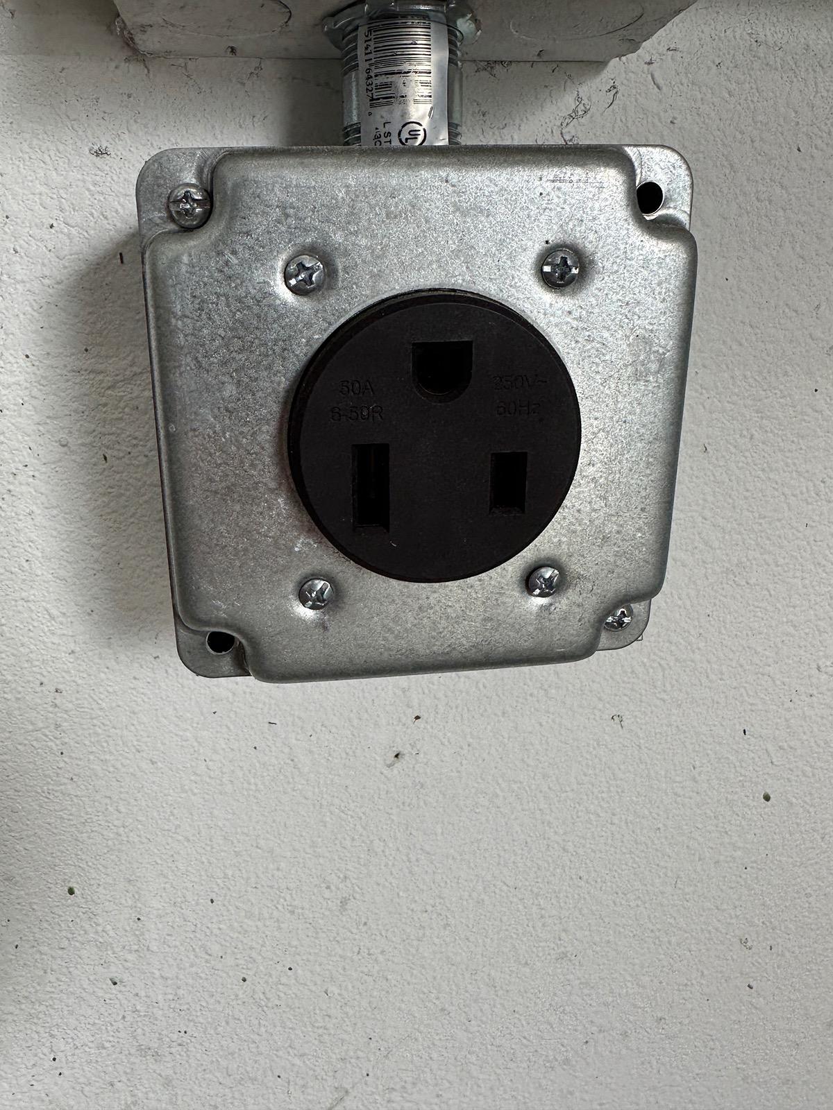

Update: I installed an outdoor rated outlet on my temp power pole and wired it using 6AWG and a 40amp breaker.
charging works fine.
I’m getting 236v across the two legs and 118v on single legs.
I forgot what a joy it was to work with 6AWG wire… so pliable… ?
Took some time to do it neatly and keep the box tidy. Results are good.
The SR can charge at 48A max. All ‘24 models will come with the single charger and be limited to 48A except for custom fleet orders. The dual charger ER will not be offered.
