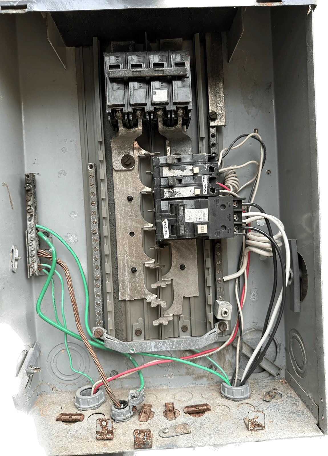

Thanks.
Had a look at job site box today.
30amp breaker and outlet fed by 10awg wire. Neutral wire run - tho everything bonded in box so perhaps it’s Really no more than a ground.
Pics below for the interested.
Box is well worn, but solid.
looks to be Eaton.
Makes picking up 40amp easy.
will combine with quality 14-50 outlet - and I’m plug and play here.
shop will be next at the weekend.

Thanks.
looks to be Eaton.
Glad we could help. One quick comment. There is no real downside to using a 50amp breaker and 6awg wire. The cost difference is only a couple dollars 6awg vs 8awg for such a short run, the breakers should be the same cost. A 40 amp circuit is adequate for the included Ford charger but if you ever decide to upgrade to something like a J+ Booster 2, which is an adjustable mobile cord that can charge at 40 amps, you will be stuck at 32 amps on a 40 amp circuit. The larger 6awg wire will also help wick heat away from the receptacles contacts keeping them cooler. Again, not necessary, but I like to futureproof any work I do.
You are correct, the Ground (Grounding) and Neutral (Grounded Conductor) are bonded together at the Service Entrance. This is the only point in the electrical system where they should be connected together.
