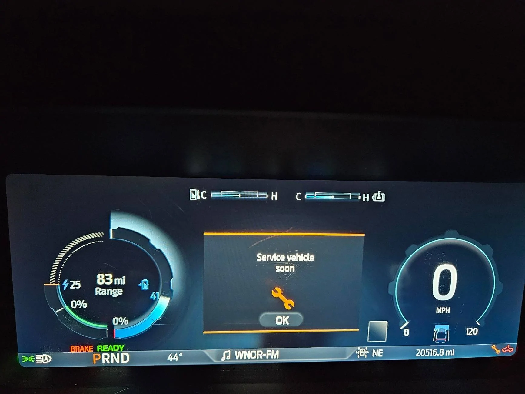

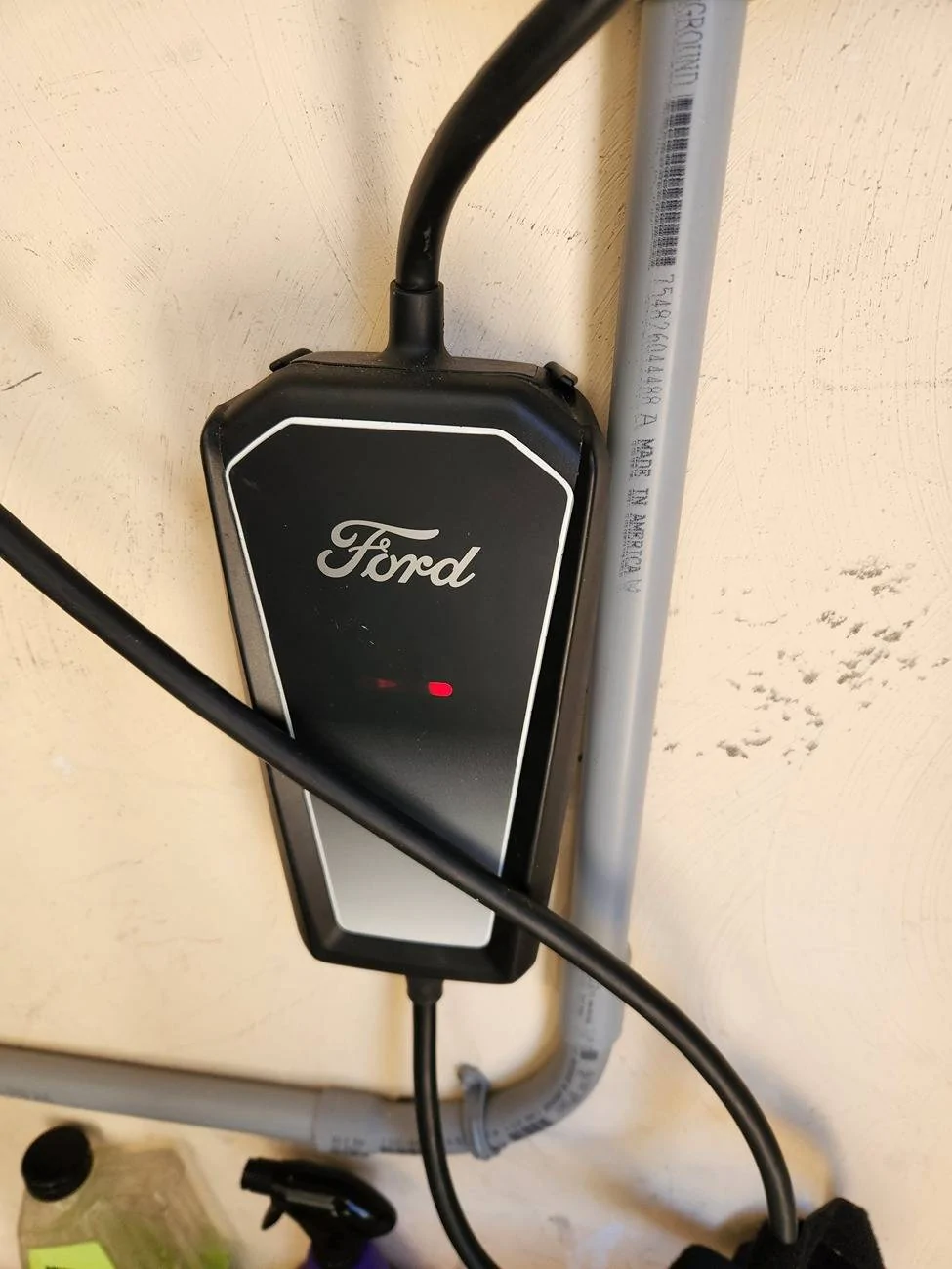

2 weeks ago my wall charger switch to a red bar and my truck did not complete it typical overnight charge. Since then I would charge to 85% but as soon as I backed down the driveway it would go to 83%.

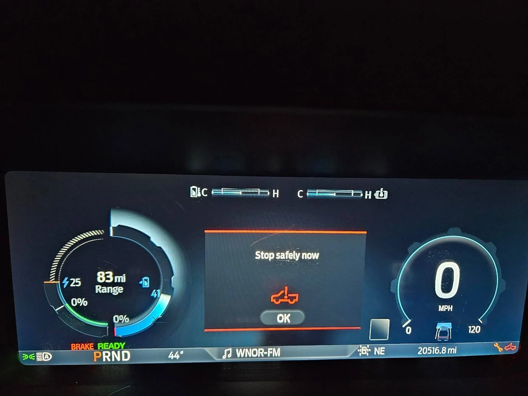

Yesterday I get a Service Now warning and a Stop Safely Now warn ing. Parked the truck and called dealer for pickup and tow.

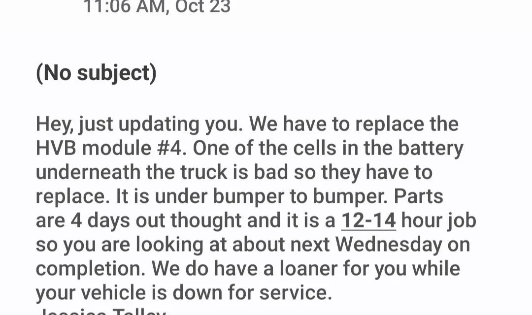

Today, get a message the High Voltage Battery has Bad cell and will need the truck for a week. (loaner F150 on route from dealer)

Did the charger screw up the Battery?
Did the Battery screw up the charger?
Does the Ford Charger has warrenty period or part of the Bumper2Bumper?

Today also saw the wall charger still has a red bar even when unplugged
