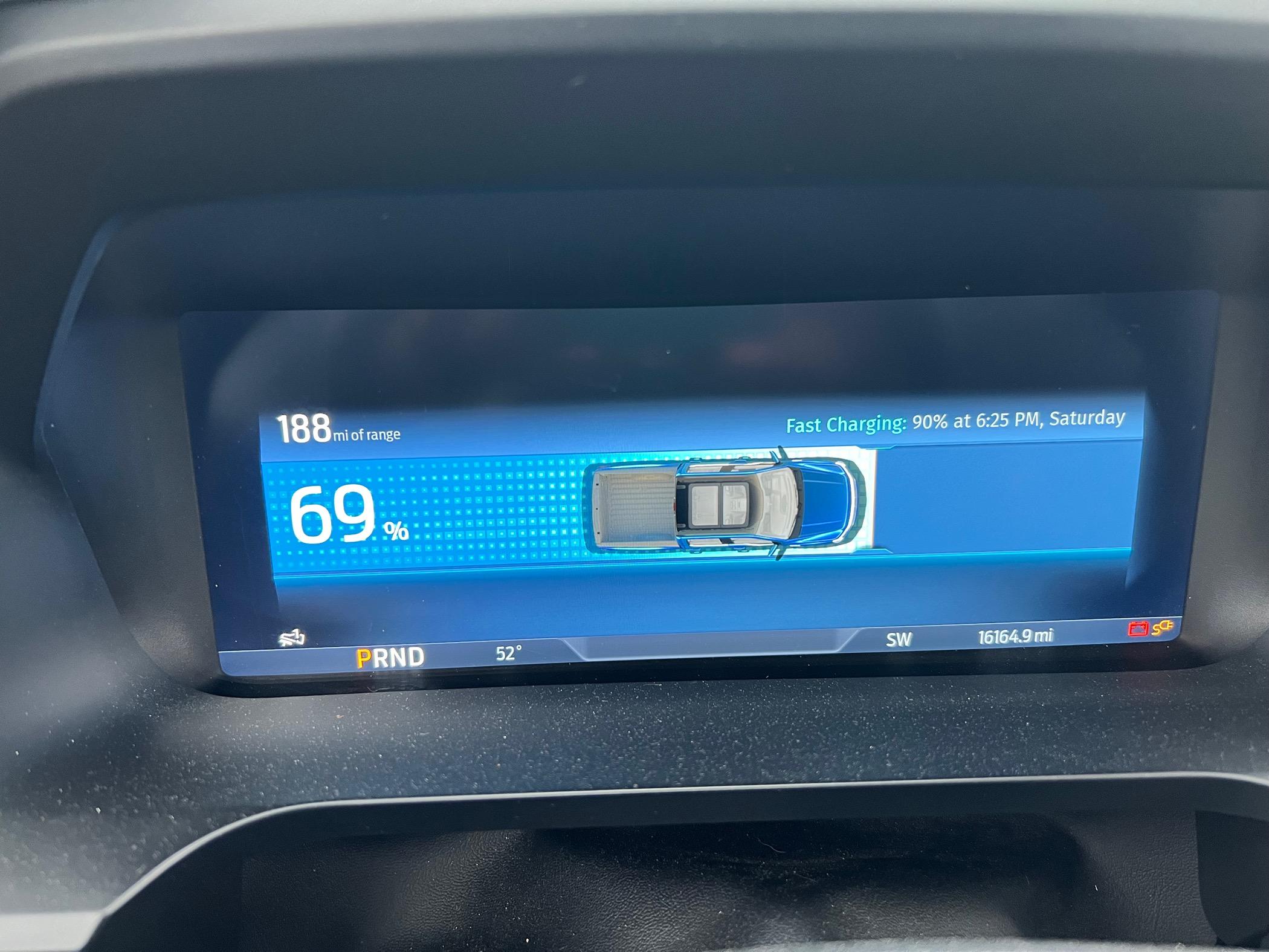

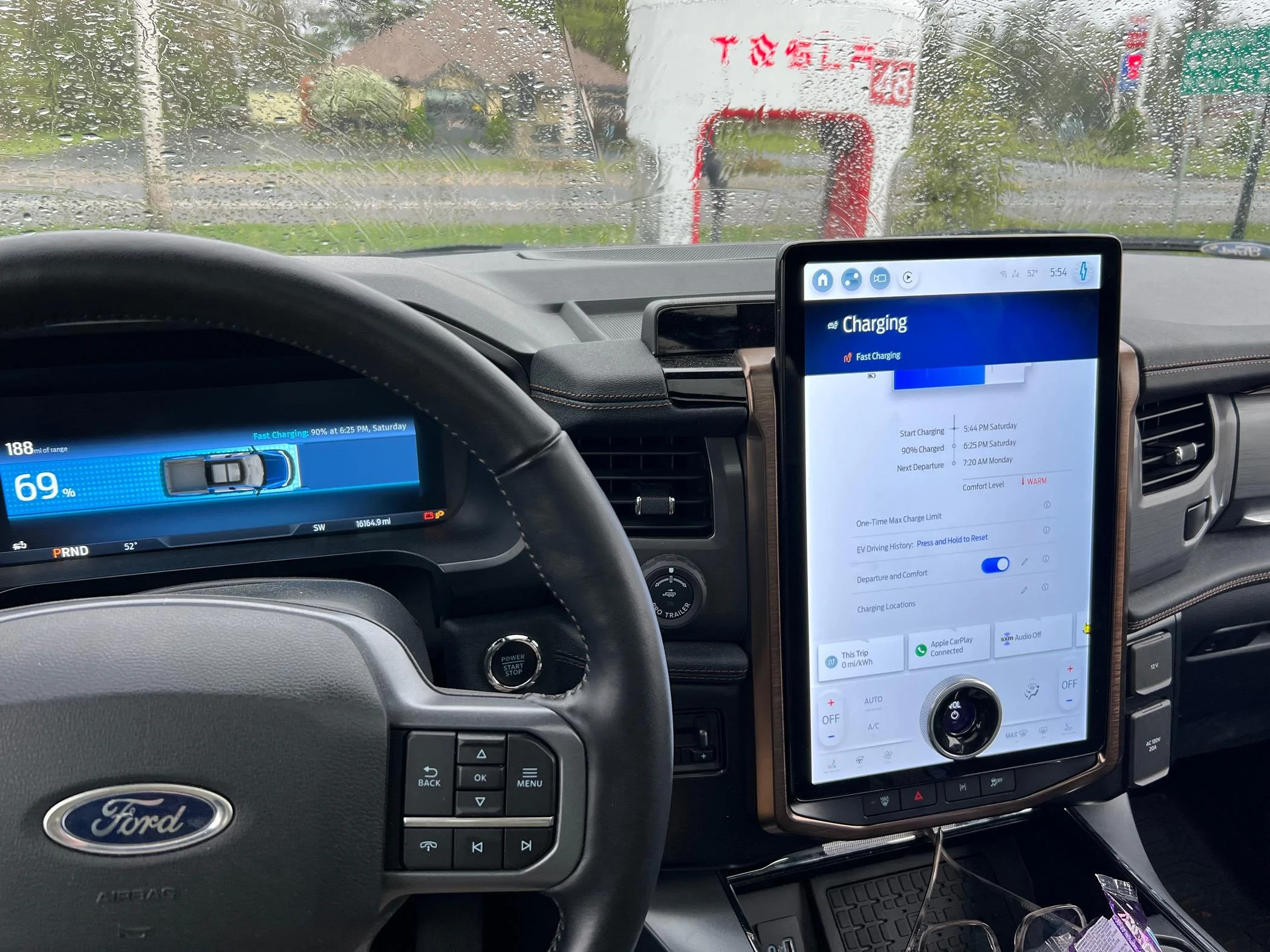

So I have an A2Z adapter and went to a Tesla charger for the first time to see if it would work. It's a bit fiddly to attach, but eventually I got it plugged into the car and it started charging with the blue lights. In a minute or so, the lights turned to red and on the dash it said there was a charge fault. Any idea what this means? I don't have trouble charging at home (Ford unite) or the office (level 2). Thanks.
I had the same problem today twice at two different Tesla stations. It eventually works but it’s pretty scary. The adapter has something wrong with it as it doesn’t show up on the Tesla app or the screen module for the lightning. There is a big challenge to unlocking it as well. I’m not sure I’m going to use this thing again and instead wait for my official Ford adapter to show up. Something is seriously wrong with the A2Z adaptor.

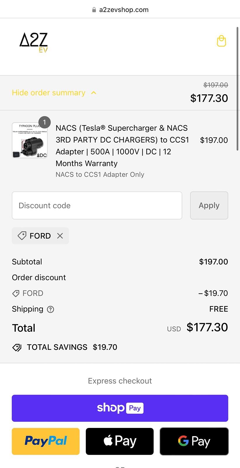

Looks like discount code “FORD” is updated to take 10% off and still gives free shipping.
Some folks on Reddit have called in to pay $15 extra for expedited overnight shipping if they need it a little sooner.
I got the Typhoon DC adapter / Stellar AC adapter bundle (25% off Stellar adapter).
Are you having issues getting charge faults on your dash during attempts to charge (also associated red ring) or are you failing to connect when adapter is plugged in and Tesla doesn't see the truck?
Most folks have the first problem because the lock can be really tough to secure on the Tesla / adapter connection. I had the second problem, where on a trip two weeks back (you can read a couple pages earlier on this thread) my adapter suddenly stopped making a connection despite being seated all the way. I called A2Z and we spoke for a while on video chat to troubleshoot but it ultimately ended with them sending me a replacement under warranty which works great. No idea what went wrong with the first.
I would recommend calling A2Z and listing what you did to resolve it in this thread so future readers can attempt the same steps should they have issues.
