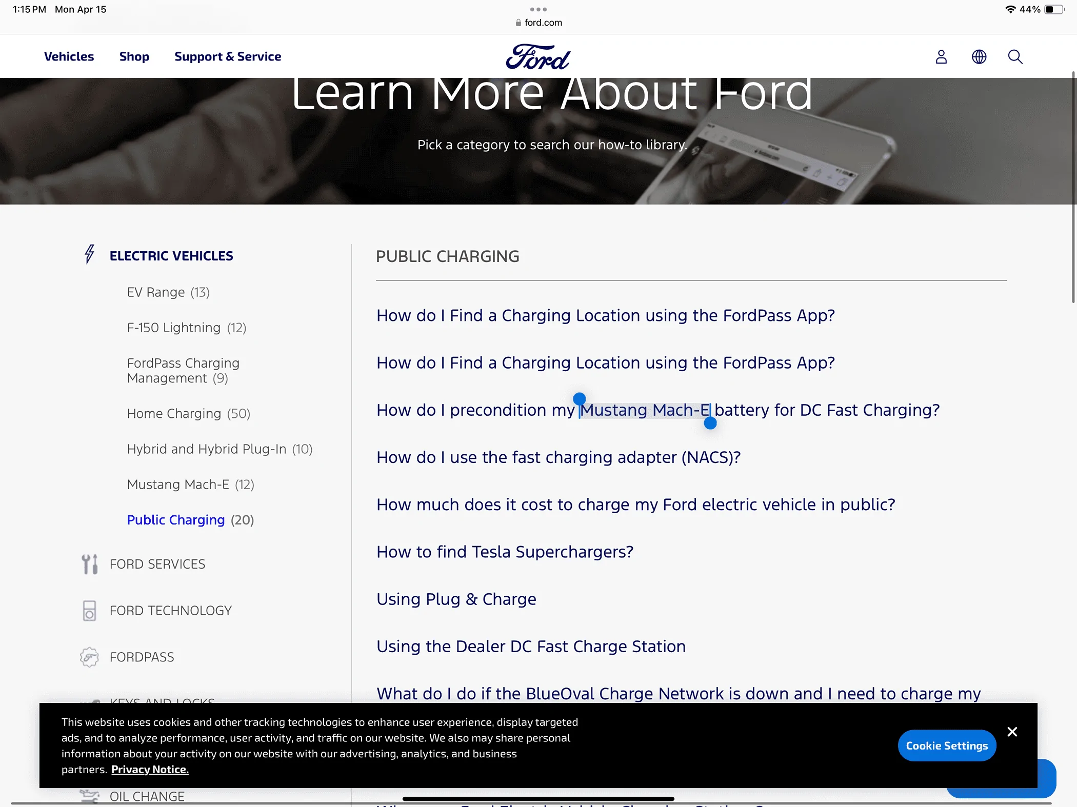

I remember discussing this in another thread. @TaxmanHog pointed out that preconditioning was only listed for the Mach E. In the Ford EV Q&A site, the Q is listed as ā€œHow do I precondition my Mustang MachE Battery for fast charging?ā€
If someone can point to something that suggests the Lightning is supposed to precondition, I’d love to see it.
Ford stated this multiple times. See #6 below.
I was talking about the graphic, they should have something to the effect {How do I precondition my [BEV vehicle] battery for DC Fast Charging}
