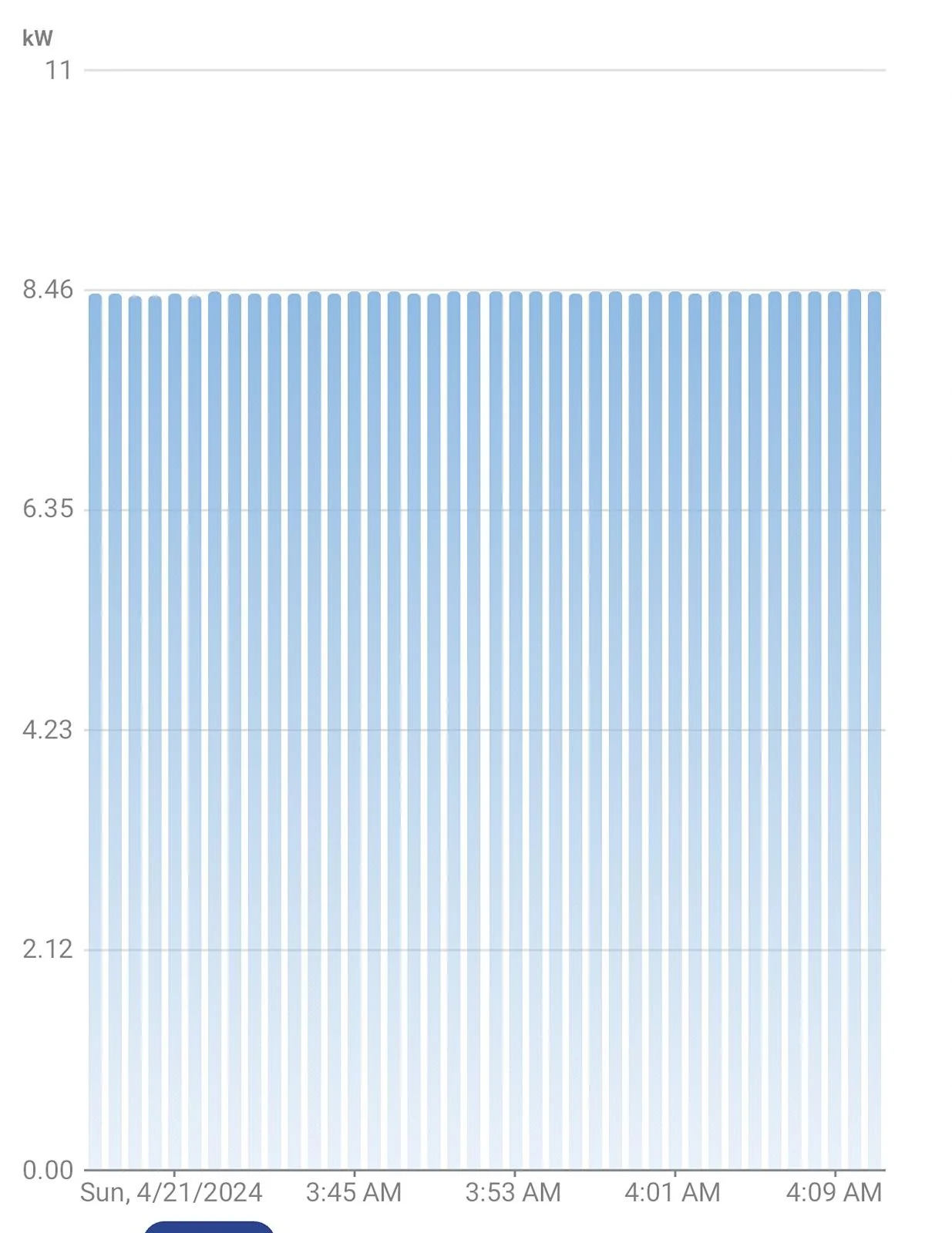

in the screenshot below we are charging at 8.4 according to emporia but truck is registering 4. I would like to add I’ve never seen the peak and drop every so many seconds before but the three chargers I’ve used have shown the peak / drop every couple of seconds.
the math I used was very rounded but truck was at 60 soc so I used 60/8.4 should be about 7 hours but it was closer to 15.
the truck is currently at the airport but at that charger it’s showing it’s a 6 kW charger truck is showing 3.
used a friends Tesla charger the day before and it was showing just a little over 3 as well
The Ford Pass, active charging data screen is severely inaccurate, I generally charge at 18KW indicated by my Emploria Vue2 energy monitor, while the Ford Pass application typically say's the truck is getting 16KW, one could interpret this to be NET energy to the DC battery vs. gross energy flowing into the AC/DC inverter.
Your 50% variance is outside my experiences, but others charging at the lower rate can chime in with their measurements.

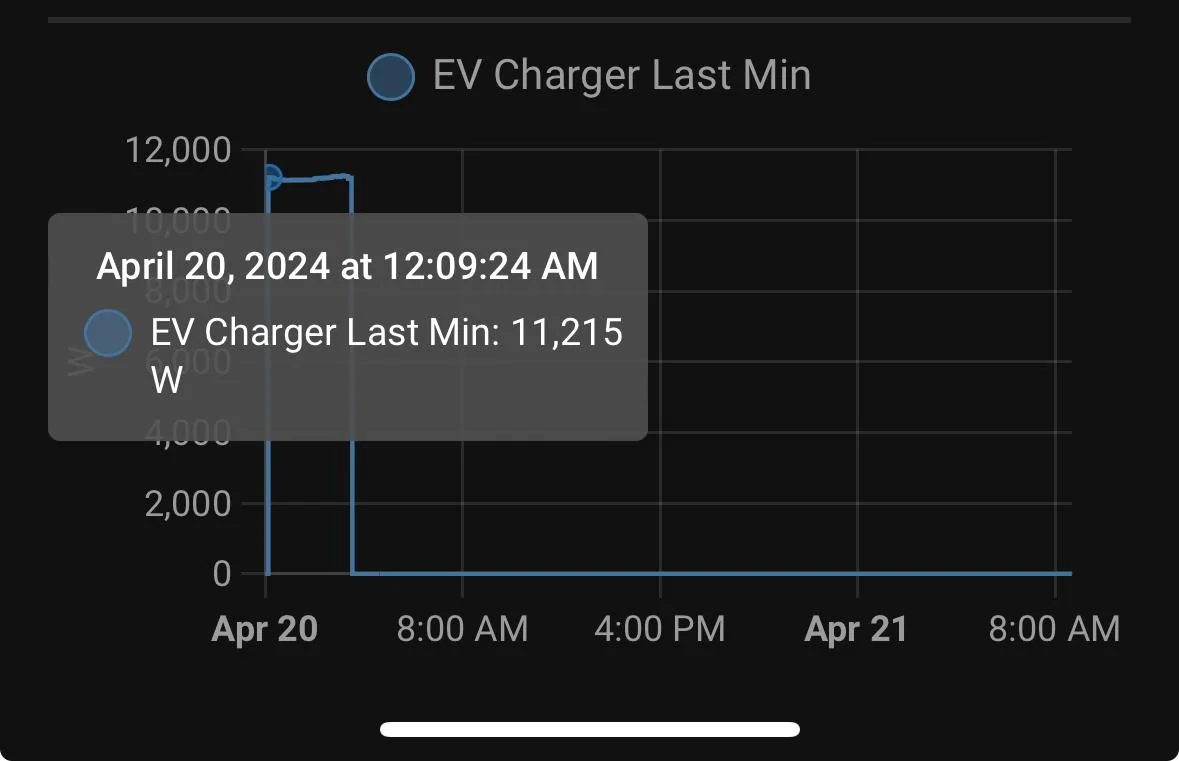

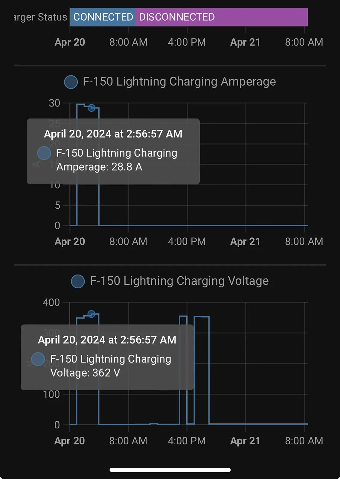

it’s confusing because The Ford Pass app is showing DC kW going into the battery - not AC kW coming from the EVSE.
So the app gives the view from the DC/battery side of the AC/DC charger/inverter
High voltage battery voltage ~365v
High voltage battery charging amperage ~28A
365v*28A=10.2kW DC (10,200w)
here is stats from Home Assistant
Ford F-150 Lightning AC Charging showing 1/2 of what is expected. IMG_2245
Ford F-150 Lightning AC Charging showing 1/2 of what is expected. IMG_2246
4,165
5,520
