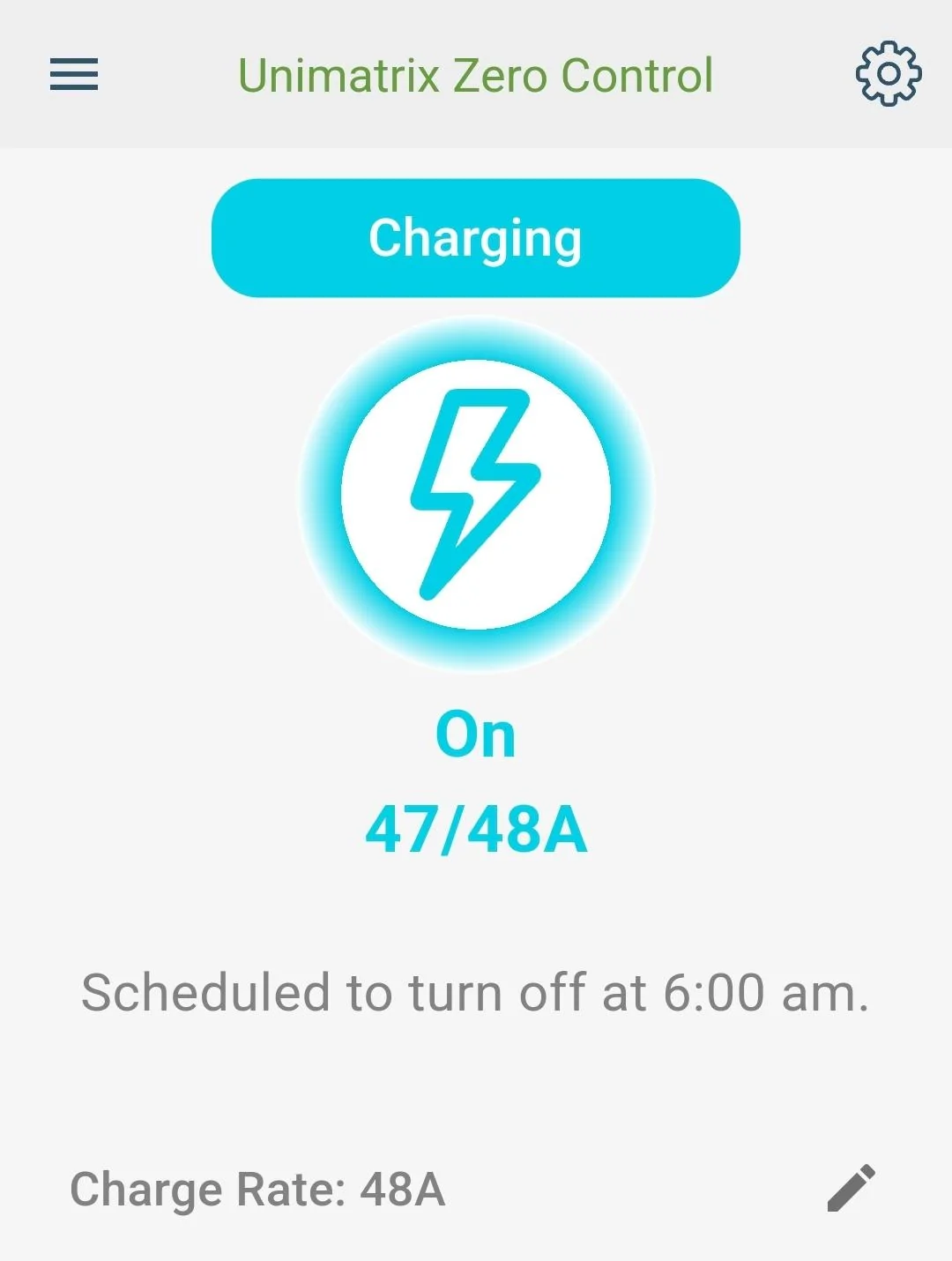

First time charging. Lariat ER. I ran the battery down to 50%. I have an Emporia EV charger hardwired on a 60 amp circuit, set for 48 amps. My Emporia app is only showing a 24/25 amp draw and the charge rate is fluctuating. Garage is in the upper 60's temperature wise, just got back from a 50 mile drive about an hour and a half ago.
Now, thinking I had a problem with my Emporia EVSE, I plugged in the mobile charger on a 50 amp circuit. I can't tell how many amps are being provided, because Ford, in it's infinite wisdom, doesn't give us any information about anything, treating us like mushrooms. I did, however, notice that the time the truck estimated the charge will be done moved over 2 hours later. That tells me the mobile charger was providing less than the Emporia.
Anybody have any ideas? This lower rate is no problem now, but in the dead of winter with a 100 mile round trip commute in the snowy cold of Southern Michigan, and with a 12 hour cold soak exposed to the elements while I'm working, I don't think this charge rate will recover enough range in my 7 hour off-peak window.

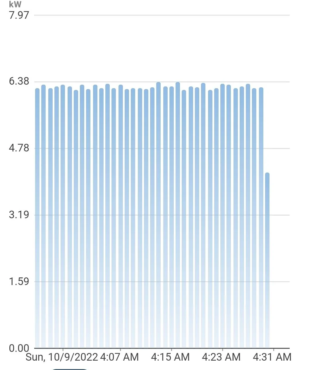

When I first plugged it in last night around 6:30, I was at about 45 to 50% SOC. The dash said the truck would complete charging around 1am to 90%. Checking my Emporia app, it took until almost 4:30am to reach 90%.

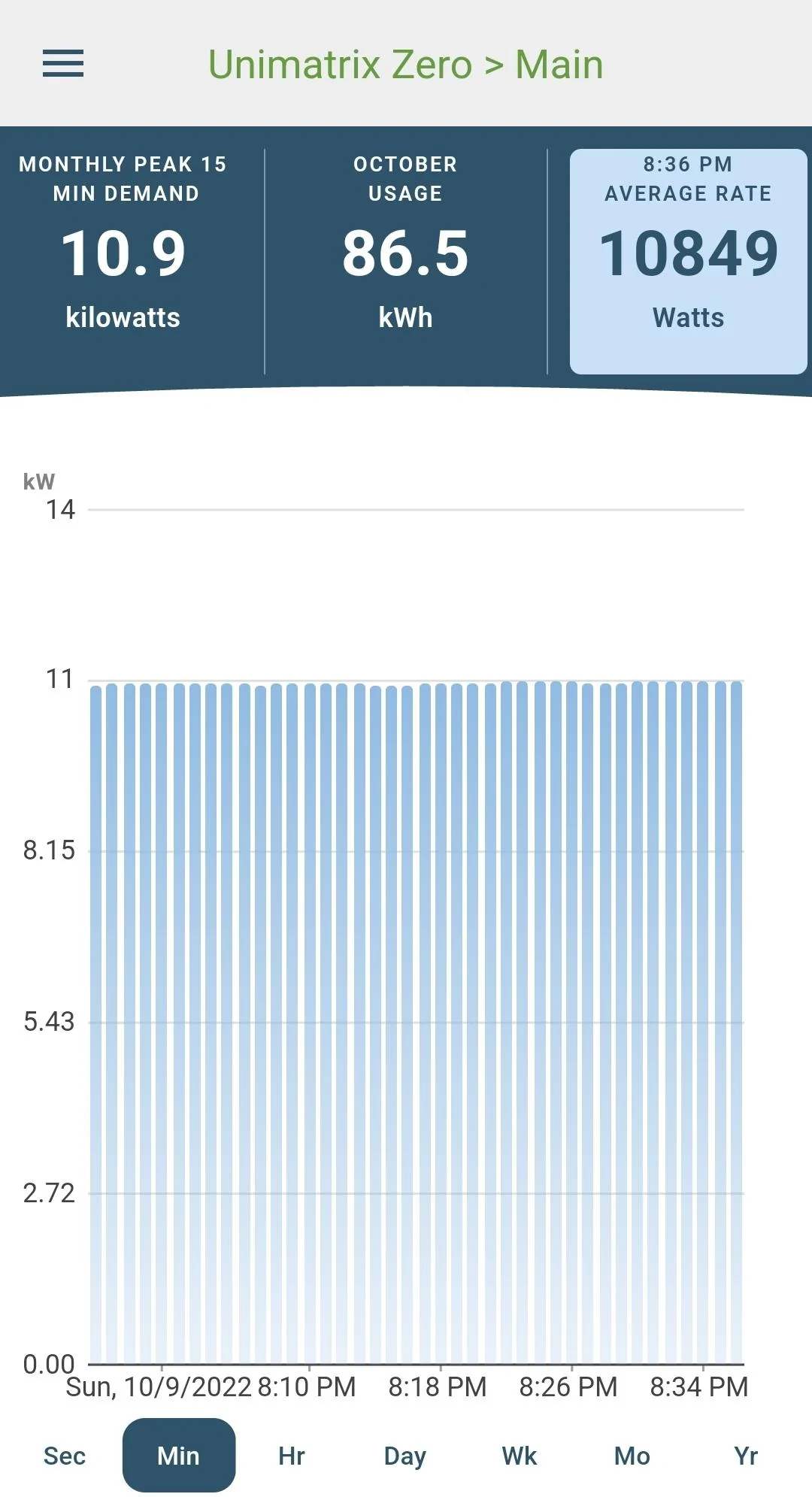

What was your trucks battery percentage when you started charging and reading ~11kw?
It was near 90%.
My local utility company is down the street from me with free 6kw level2 charging , so early morning I will take some juice from them. But it wasn't going to finish in time, so I bought it home to get my full 11kw speed.
