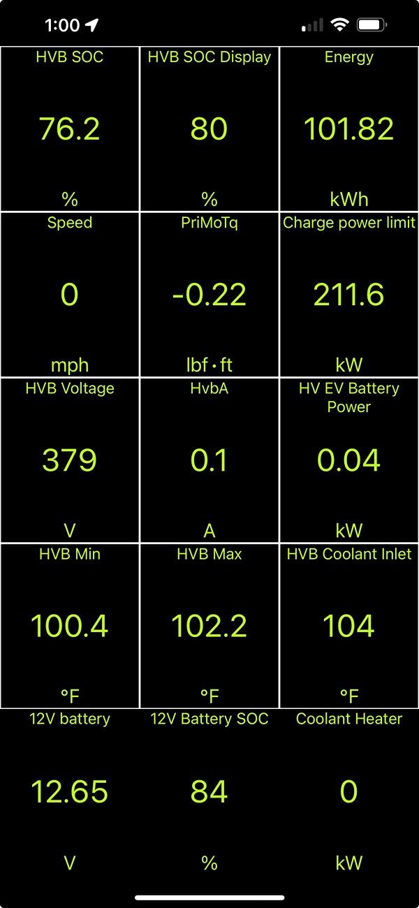

An update: Wife and I went on a 90ish mile drive today from home up around Carefree/Cave Creek and return.
Only 15ish miles around 70, the rest 55 and below. Ambient temperatures in the 108-111 range. Had an OBDlink MX+ plugged in and connected to Car Scanner on my phone. HVB temp slowly over the entire drive climbed to 102.2 at the end of the drive. HVB Coolant inlet was 87.8 at the end of the drive. Used about 27% battery during the drive with AC etc.
Battery temp indicator in the dash display went from the centerline at the start to halfway between centerline and the next tick to the right.
I checked the coolant level in the tank that sits under the drivers side fender cover and it was at the max fill line so I'm not low on coolant.
Question, at what HVB temp will the truck cool the battery when plugged in?

The HVB was not overtemp, it was simply higher than when I started. HVB battery temp at the end of the 90 miles was 102.2F as reported by the truck through an OBD scanner. I did not mean anything was out of tolerance, I stated what things were for me during one 90 mile drive. Ambient temp was the temperature as reported by the truck for the outside/surrounding air temp. You can read that in two place, on the driver display in the lower left and on the center display on the upper right for the 15 inch screen.

Since the thermometer (battery temp indicator) was still well below max even though it was right of the center, I believe the battery was warm but not over temp. Last summer the temp was almost always slightly above center. Since temps over 100 are the norm now this year, the temps are starting to run warm.

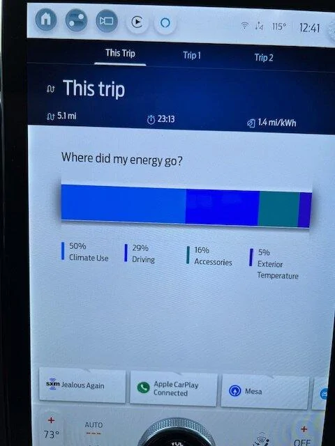

Some interesting information, or at least I think so.
I drove the truck today, it was an interesting ride. Only went 5.1 miles as you'll see. Two photos, one car scanner screen shot the other of my center display this trip page. Actual temperature was 109 not 115 the truck is displaying. The truck was using an amazing amount of energy to cool the cabin. The percentages are interesting for the amount of time the truck was on. I do have max tow. I don't think the system spends much energy cooling the battery when the battery is "only" 100 or so degrees. The HVB min value was the temp when I started the truck, it had been sitting outside for 5 hours. In shade for the first 2 or 3 then in full sun as it rose over the hangar.
I normally garage the truck when at home and based on some of the conversations in here and other research I've read, I have it plugged in when at home. I don't have the capability to plug in when not at home.

I noticed similar yesterday. After 30mile commute home (took a few detours) I had used almost 30% for the cabin and 9% to exterior temperature. Most I've seen in long time and first time I got home with <2.0 mpk. It's definitely hot outside.

I had a similar screen yesterday, after about 400 miles driving in 100 temps. I assume climate is the inside cooling, is it possible the max town compressor is considered an accessory? But what is counted as exterior temp?
