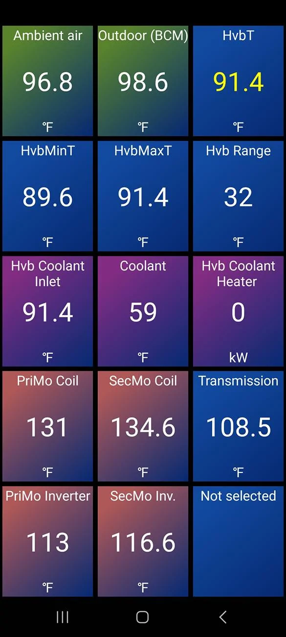

I still don't understand how my truck works. It has not seen AZ kinda temps but it has seen over 100F. I have never seen the fan running when the truck is off plugged in or not but I have seen the fan going bananas as soon as I turn it on. I have never seen the temp gauge move away from center in summer even when battery Temps go up by 40 degrees.
This is from a drive today during which the truck saw max of 102F ambient temp. Coolant inlet temp and Coolant temp did not change at all after I started the car and drove it very gently (power band never exceeded 20% and minimized regen) for two 10 mile segments but battery temp went up. I don’t understand with coolant at 59, why the battery temp is still going up? I got the max tow package for the extra cooling for the battery but I am not sure if there is any cooling going on at these temps.
I would love to see an animation showing what the car is thinking and how the fluids and electrons flow through the car.
p.s. I had the AC running anytime the truck was on. I am not sure if that takes away from battery cooling.

Cabin AC has no impact on battery cooling circuit and the battery exclusive compressor.
Yeah, don't know the decision tree the computer makes, but we know that these batteries LOVE 70-80F Maybe they don't actively cool till 100F as the energy spend cooling might not "pay back" in efficiency till after that point. Max Tow should mean cooling the battery won't steal "chill" from the cabin, nor vice versa.
From my experience, fan running when off is only in the most extreme heat. 115+F while the truck is in full sun. The fan kicks on when you have the AC on, that's why it goes full tilt when you start it up, it's trying to quickly chill the AC coolant for the cabin.
I'm sure the real secret is that there are many other sensors the computer uses to make decisions that we can't read, even on our fanciest of fancy OBD readers. Or maybe it's really a case we just have a hard time wrapping our heads around because there is no central computer, there's no central decision making, and even deciding to cool the battery might require 3 or 4 different steps along to way to all agree to sending coolant to it.

@Maxx. I've made similar observations with my truck. Two things to consider.
1. Maybe there is something wrong with the coolant temperature reading furnished by Car Scanner and the like. Or maybe it just reports the last temperature reading when the compressors were actually running?
2. I read somewhere that the ideal operating temperature of the Lightning battery from an efficiency standpoint is 90 to 100F.
To illustrate point #1, my truck has been sitting all day in a garage that is now 86F by several thermometers placed near the truck. I turn the truck on in full-accessory mode so nothing is running except a fan. The coolant temperature read by Car Scanner is 59F (15C). The battery temperature is 82.4F (28.0C), the engine temperatures 84.2F (29.0C). The garage has been slowly warming up from being 84F at 7 am (and the truck battery is the closest thing to my garage floor, which may be cooler than thermometers sitting 3 ft off the garage floor and exposed to radiant heat from the garage attic). How can my coolant temperature be 59F when no compressors have been running??? (and the truck has not been running for days - in the interest of full disclosure, it's been stuck in Inhibit Mode from a failed OTA update, but I've seen essentially the same as I describe running my truck in "full health"). So there is something funny about Car Scanner coolant temp readings or just the last reading when a compressor(s) were actually running is reported.
Relative to item #2, I presume the truck might run with its battery at 90F to 100F in the interest of getting maximum range from the kWh stored in the battery. Since most people are not driving all day and all night, the truck is spending most of the time with its battery at a cooler temperature, especially for the folks who live in northern climes during the fall, winter, and spring, even into early summer.
P.S. Whatever the real coolant temperature is, also consider that the battery is MASSIVE compared to the amount of coolant flowing through it. It's like the old high school algebra problem of a filled bathtub with the drain open (the coolant attempting to keep the temperature down) and the tap running, in danger of filling the tub to the limit (the heat generated by the battery). Is the bathtub going to fill up (overheat) or completely drain (become ice-cold). To keep the bathtub at the level you want, the coolant will have to be darn cold to counter the massive heating effect from the energy drawn. So the coolant temperature is always going to have to be way cooler than the battery cells themselves in an actively driven truck.

I've been checking out abrp and it gives battery temperature readings also. I can't run that and the carscanner app at the same time but the carscanner app seems to be missing something there in my opinion. I do know that battery cooling works or atleast it does and seems to do well when preconditioning for charging. What I don't get is if it can cool the battery down to optimal temperature during a route to a dc fast charger, why can't it stay ahead of the curve on hot days and keep the battery temp optimal any other time. I would think it would be better to draw even a minimal current to keep the coolant loop cool and get ahead of the game rather than saying oh things are too hot and have to try to work overtime to cool the battery back down after the fact.
2,277
2,395
The 59 degree coolant reading I don't think is applicable to the Lightning. When I looked through values on Torque, it's listed at Engine Coolant Temp and it never changes from 59. Makes me think it's bogus, some default value, and I ignore it.
I've been meaning to test out my A2Z adaptor, so I might see if I can trick the system by navigating to a nearby EA station but drive to the SC and see what the battery inlet temp does. My guess is that will indicate if the truck is actively cooling the battery.
