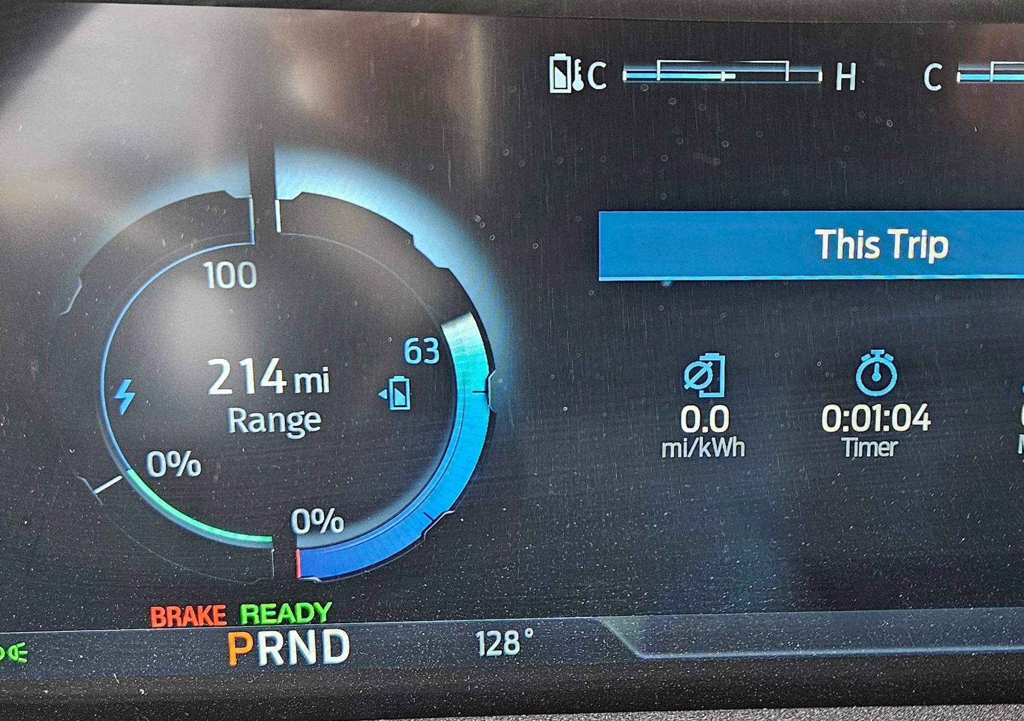

Ford F-150 Lightning Ah summer is here in the valley of the sun 1000005604
Google says it is 105, sitting in full sun for 9 hours. This is with departure set to cool truck.
My display looked similar to yours except 123 instead of 128. Same battery temp also.
