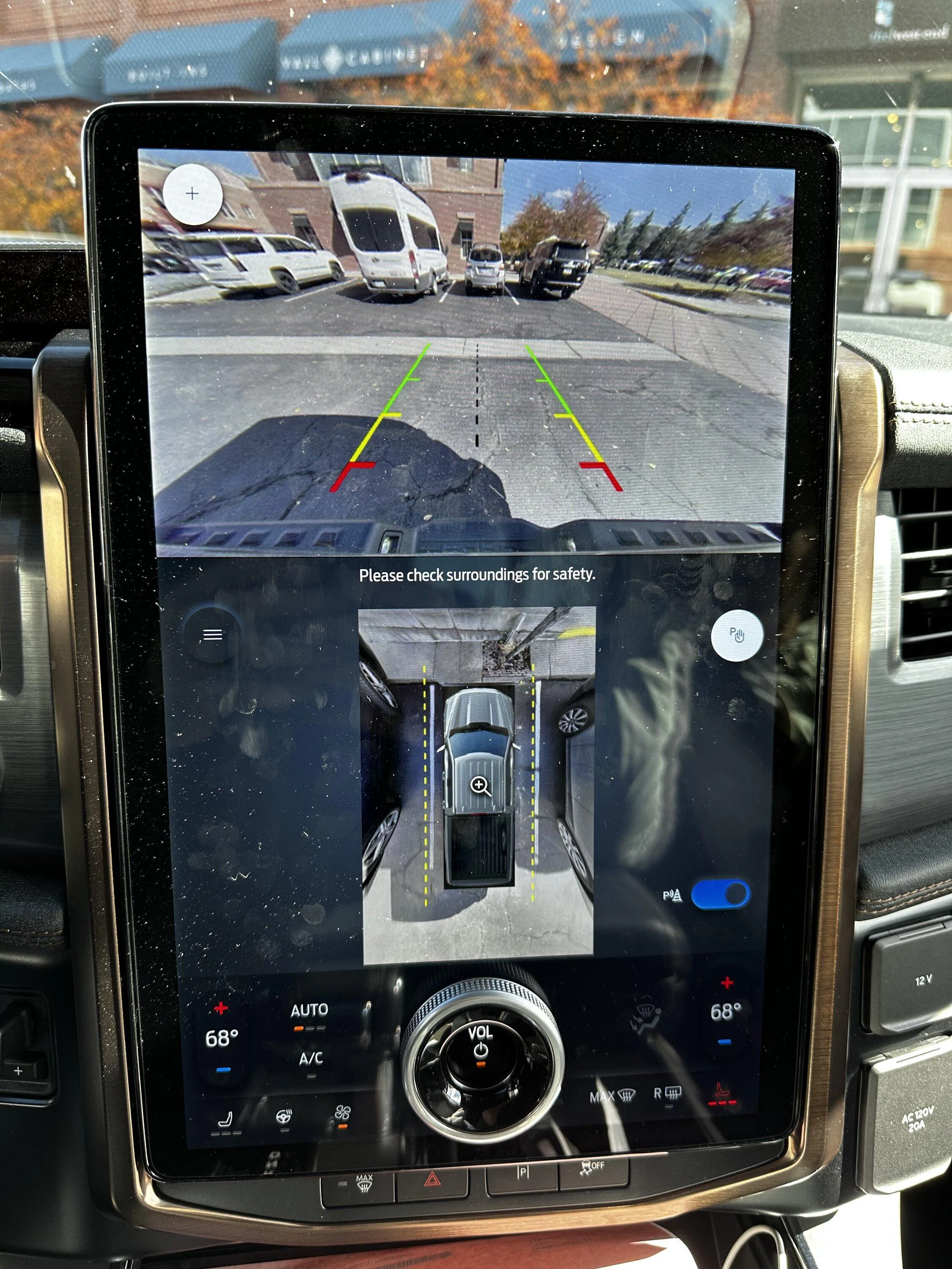

Almost backed into a car because i didn’t realize the screen had frozen when i started backing up! Thankfully the parking sensor audio alerted me I was getting close to something and I looked out the rear view mirror.
Totally my fault for relying on the camera but I’ve never had a car with a camera where the camera just freezes while reversing. Had to do the two button reset to get the screen working again.
23 Lariat ER that I got a week ago.
Not confidence inspiring. Wonder if I can use this as a way to try to get Ford to update my software to the latest versions…

I’m inclined to believe it’s a software issue since the entire screen was frozen until I did the two button reset.

Sometimes my backup camera should come on but instead the entire screen goes black. After I drive forward for a few hundred feet, the screen turns on and all is normal. But the problem doesn’t happen most of the time so how am I supposed to get it fixed?

This happens to me frequently. About 50% of the time, when I first start the truck, either the camera freezes or the whole display goes black. This has been going on for months. It resets itself after about 30 seconds but that doesn't help me when I'm trying to use the camera to back up. This never happens except right when I turn on the truck. Would love a solution for this.
Also, what's the 2 button reset secret? Maybe that would help me reset the screen more quickly when this happens to me.
I've also noticed it takes 30 seconds or so for Sync to initialize on start. Until it is completes it's initialization, it is very laggy. If I need to back up, I pause until things are "warmed up".
The Sync reset - press and hold the Volume-Down and the Skip-Right buttons on the steering wheel for 10 seconds - this restarts Sync. It can be done while driving as well if Sync hangs up for any reason.

Just got the truck back from its second battery module replacement. Only 21 days this time. Went to back out and the screen was frozen. Have never had this happen before. I’m on 6.1 release (updated while it was in for service). Had to restart system.

Hi Jesse! I can look into your Lightning's camera concern on my end. To get started, could you please send a private message over with the name/location of your local Ford dealer and your Lightning's VIN?
