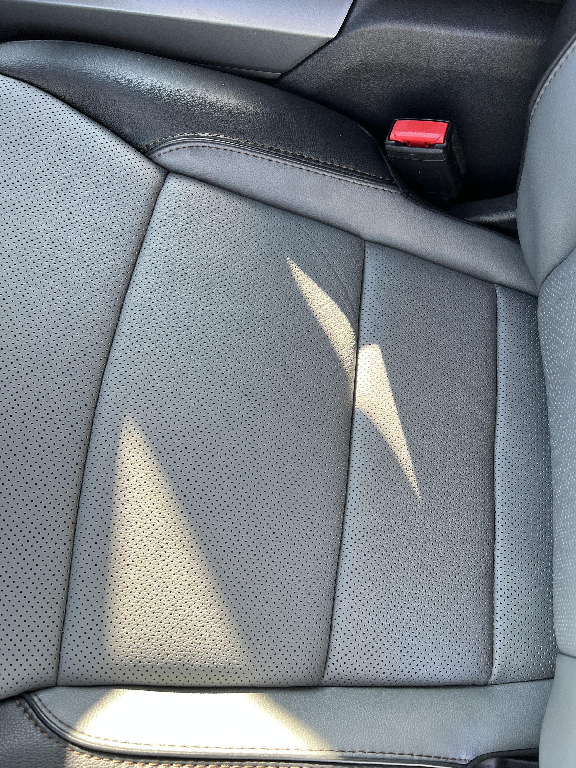

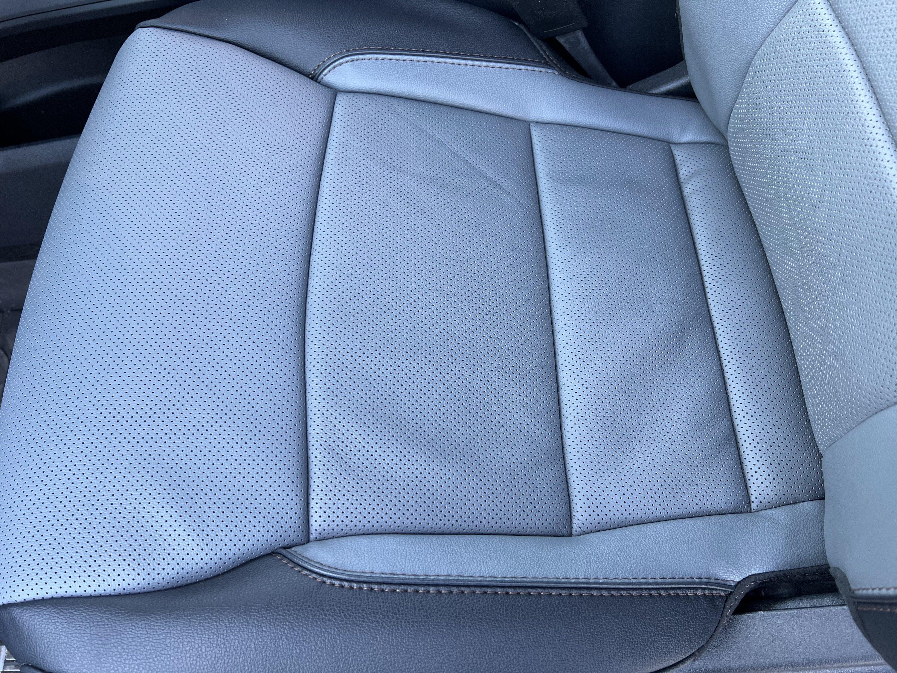

Welp, can't say I'm surprised.
So not only do every single one of us have this weird crease in the same location, but my replacement (which did end up being the entire seat bottom) looks worse...
before
Ford F-150 Lightning Anyone else notice the leather seats in Lariat trim wear poorly? befor
after
Ford F-150 Lightning Anyone else notice the leather seats in Lariat trim wear poorly? after
someone stood there, looked at my brand new truck, looked at that seat, looked down at the one in their hand, and then changed a visibly worse seat into my truck somehow with more creases in it than the original creased one.

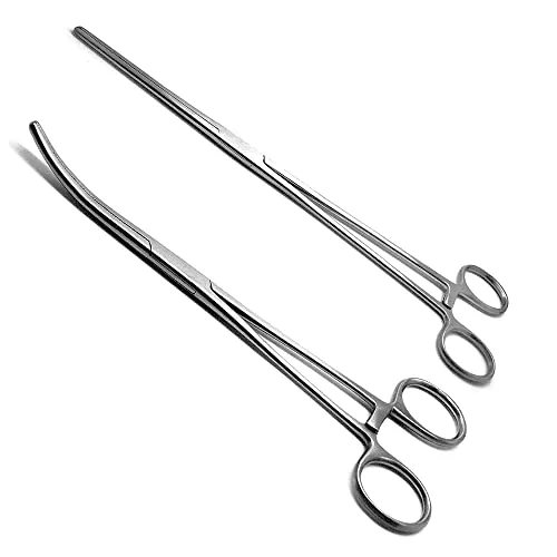

That's what I want to try, but I can't get my fat fingers in there to do it. Not really wanting to remove seat and since last time the truck went in for repair it was 35 days before I got it back. So I'm living with the wrinkle for now 😁.
To cure fat fingers, get yourself a set of hemostats. Very useful to have around for multiple things.
