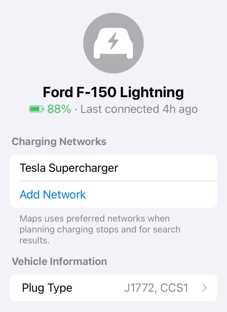

If I were to create a new thread, this would be labeled: Getting iOS 18.4 Apple Maps to Use Tesla Supercharger Stations
I upgraded to 18.4 and was excited to check out its ability to route me using compatible Supercharger stations. So, I sat in the truck, connected via CarPlay and made sure that the Tesla Superchargers we chosen as a preferred network. Then I asked it to give me some routings that took me by one or more known Tesla sites. Huh, it was still insisting on using EA or EVgo.
After a bit, I decided to just delete my F-150 Lightning from the Maps settings and create a new vehicle (only took a few seconds); I set Tesla Supercharger as my preferred network.
Voila, now Maps was using the compatible Tesla sites, and that behavior persists after disconnecting from CarPlay.
I hope this experience might help others; meanwhile, I think it's interesting that this feature only works with Ford EVs.

I did discover a flaw in this recently. If you’re already mapped to a destination and driving and then you think, I’m gonna add a stop to this route to charge up a little. When you tap Add a stop and then choose Chargers - it ignores Tesla chargers. Which is kind of frustrating.
