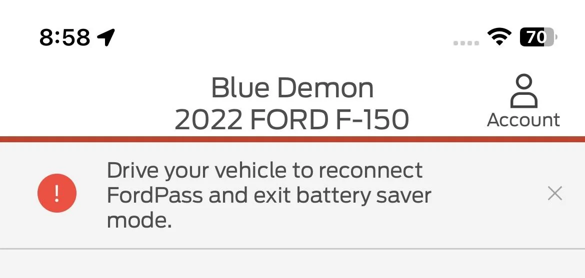

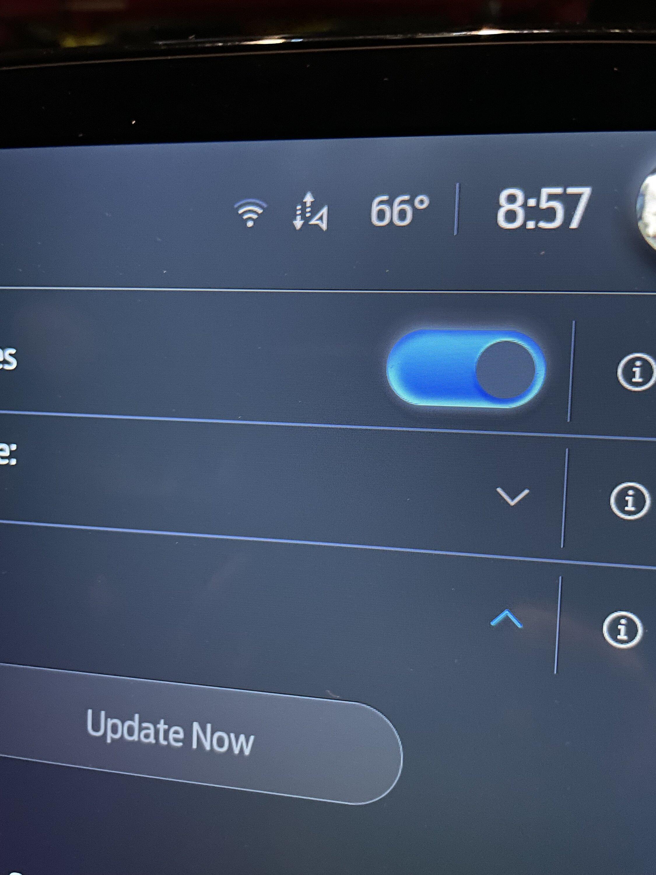

Further investigation - I went to the truck - it didn't wake up when I approached or after opening the door. This tells me my LVB SOC may have dropped again overnight. No reason it shouldn't wake up after opening the door.
To say the least - it does start after brake/push button and comes to life and connects to Wifi (although the app knew to tell me to drive to reconnect services). It will check for SW updates, but nothing will get the truck to update the app (still says last connected 3 hours ago) and the LVB SOC will not update Ford. So there are definitely certain processes that only work over the cell signals.
With full wifi on both truck and cell there are still communications that are nerfed.
