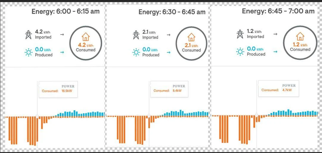

If you are confident your spend is truly 8kwh then yes in your scenario it does not make sense. Unless the automatic schedule of the cabin being warm is worth it. (For me it is, because my electricity is extremely cheap at that time)
Also you could reduce your 8kwh Precondition "spend" if you time your charging to be immediately prior to our precondition time.
See attached example. My charging started at 3 am to 4am (paused for an hour based on my schedule) and then started again at 5am finishing at ~6:10. Since my battery was warm from the charging my precondition "spend" was only 3.2 at max (Since this graph show whole home use) between 6:30 and 7 (7am Departure). Probably more like 2.0 to 2.5 if you back out typical house usage at that time.
