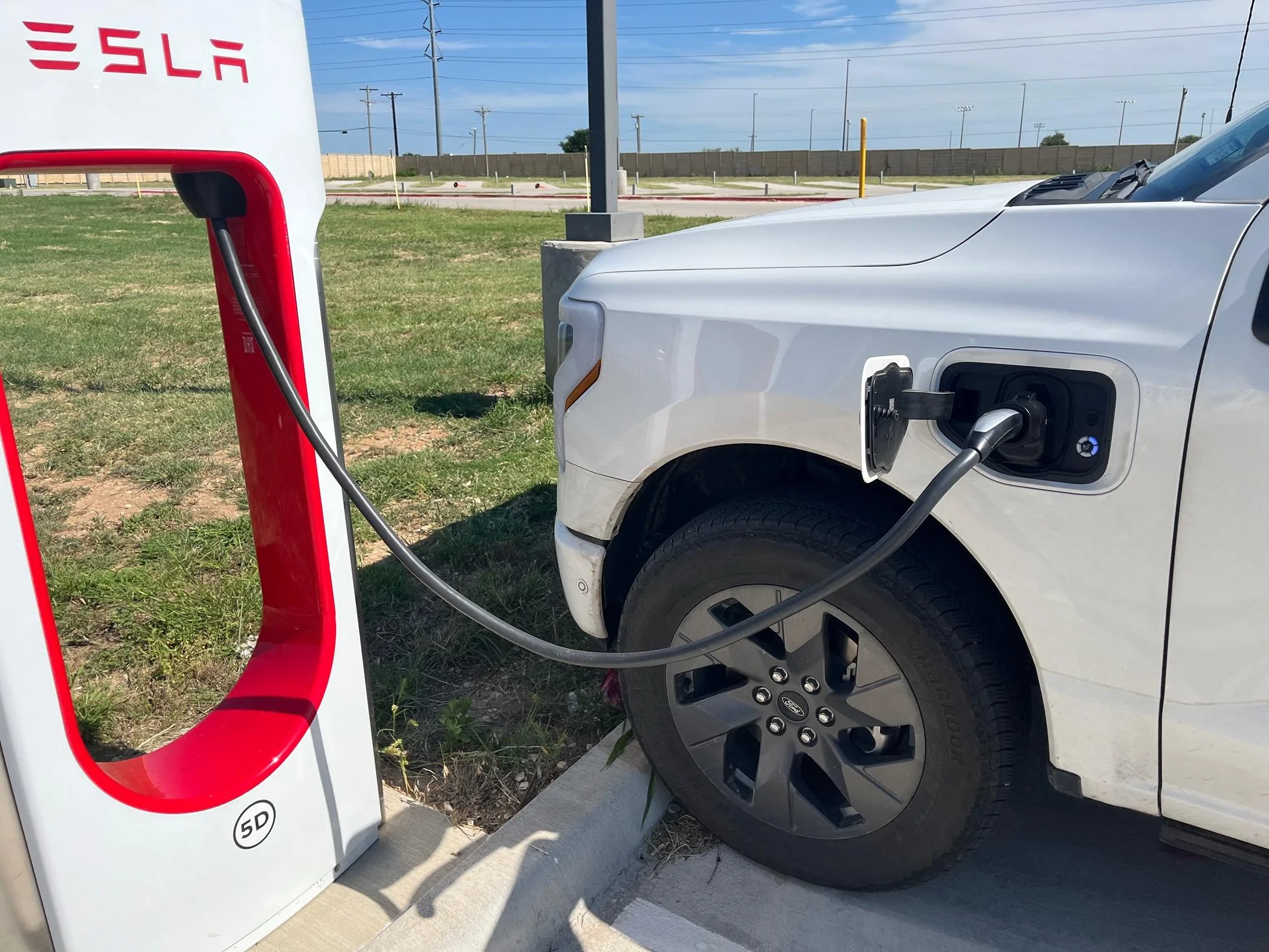

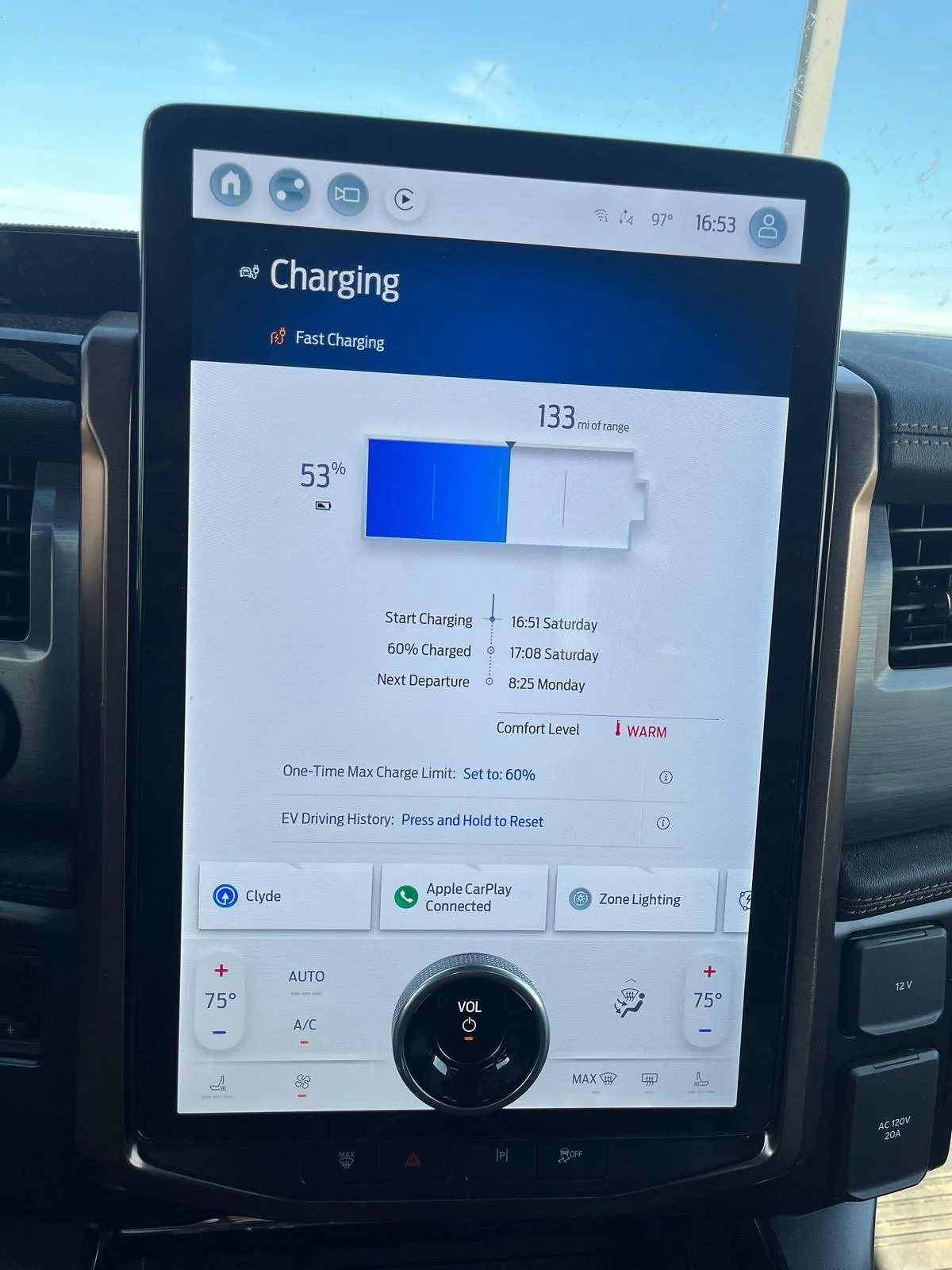

first use with new Lectron adapter - the news is not too good.
I just received my Vortex plug supercharger to CCS1 adapter. On its first use, we were successfully able to charge the vehicle. However, after charging, we were virtually unable to unlock the charging cable by pressing the NACS UNLOCK BUTTON. FINALLY, ONLY BY USING A CROWBAR, WERE WE ABLE TO DISCONNECT THE LINE.
I KNOW THAT PREVIOUSLY They WERE HAVING PROBLEMS WITH THE UNLOCK BUTTON, NOT HOLDING, BUT NOW IT APPEARS THAT IT IS HOLDING TOO FIRMLY I’M NOT SURE IF THIS IS ONLY A PROBLEM WITH MY UNIT, BUT IT DOES MAKE IT ALMOST IMPOSSIBLE TO USE THE DEVICE.
We were almost ready to simply leave the adapter connected to the charger when someone with a crowbar came to help us. we placed the unit on a towel and pushed the release latch with the crowbar, which finally finally allowed us to remove the adapter from the charging cable. When I got home, I could see some etching on the the relase latch and could only get it to fully retract using some heavy pliers. Clearly the spring is just too strong in this unit
Contacted Lectron, but so far only got a routine response advising proper usage technique

Received reply from Lectron with return shipping label. Will return it in the AM hoping for a quick replacement. Other than the latch release, it is sturdy and seems to work well. Keeping my fingers crossed after waiting so long.
