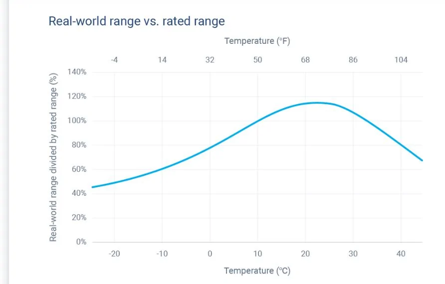

What about charging the Lightning in a hot garage on a hot summer day? Maybe 110F in the garage?
Does a fully charged battery under the 110F ambient conditions have less range than a battery that was fully charged with an ambient garage temperature of say 80 or 90F? E.g. what effort should be made to keep the garage cooler? (Attic fan? Air conditioned garage?)
Both heat and cold impact the battery. As someone noted, if the truck is plugged in, then it will run cooling efforts if it needs to. Even if it's not plugged in, it will run cooling efforts if it needs to.
What you learn, is that setting a departure time before driving allows the vehicle to warm, or cool, the battery as needed to get the most efficiency out of it. Same when you're driving - it diverts heat, or cooling, as needed, to the battery.
Of course for some people, they'll have peak electric costs at some point during the day, and won't want the vehicle to pull house current. Buying an "intelligent' charger allows you to prevent the vehicle from pulling house current if you don't want it to, leaving it to either use its battery to do so, or not.
Keep in mind that you can simply "drive" an EV, and plug it in only when you want to charge it, and charge it to 100% each time. The difference in battery efficiency, and battery longevity, will be noticed at some point in the vehicle's life.
If I don't precondition and it's 20 degrees out, I get much worse miles per kWh then if I precondition.
Keep in mind that Ford's warranty says that for 8 years / 100,000 miles, they guarantee that you'll have at least 70% of the batteries capacity available. They ensure this by limiting the usable battery (on the Mach-E extended range model, the usable battery is now 91kWh, but the battery is actually 98kWh), and monitoring how you're using the vehicle. They've stated publicly that if you use it wisely, they'll give you more capacity and faster charger curves, and if you don't, they won't.

Thanks for sharing the graph again. Two questions:
1) Does the Lightning (or MME) therefore run battery cooling when the vehicle is in use (or battery being charged) anytime the battery temperature exceeds 75F or so to keep it at maximum range?
2) The battery is fully charged in the hot garage (and the charger kept the battery cool during the charging process). Then the Lightning sits and consequently the battery heats up in the hot garage. When the Lightning is used, what range is lost while the cooling system cools the battery down to the ideal operating temperature?
1) The vehicle has features to prevent the battery from freezing or being way to hot. However, it does NOT keep it at optimum temperature. That's why your range in cold weather is severely reduced. If you pull into a high speed charger in the summer, and plug it in, when it ramps up you'll see the front louvers open and the cooling pumps kick in. It can sound like a jet aircraft ready for takeoff. In fact, it was doing this in people's garages, including mine, when charged at the 48amp level prior to Ford doing a software fix. I could hear it in the family room when it did that.
2) No one has any math to show you what range is lost to cooling or heating the battery. I can tell you that heating uses much more energy than cooling, because the Mach-E has a 7kW heater. That can use 20% or more of your energy on a trip. That heater is the same heater that heats the battery, so if you don't run the heater, the battery warms up more than if you run the heater.
You should expect a loss of 30 - 40% of range in the cold weather, possibly more if you live in Alaska or northern Canada. Mach-Es that got 3.0 - 3.5 miles per kWh in the summer are getting 2.1 - 2.5 miles per kWh now if they don't precondition.
Ford knows that ideally, the vehicle would start preconditioning the battery as you approach your next high speed charger while on a trip (and the nav knows your going there), and has heard from owners they want this feature and/or the ability to manually kick in the precondition mode while driving.
Anyone that decides to heat, or air condition, their garage for the purpose of maximizing EV range or battery life is foolish. You'll never recover that cost in your lifetime.
Remember that these vehicles transmit a lot of information back to Ford.
Great post, but I will offer that we are seeing bigger hits in cold weather than you listed (in upstate NY). We are seeing 2.1-2.2 miles per kWhr when preconditioned and 1.4-1.5 when not preconditioned on our MME GT. Only had it about a month, so we can't wait for the warm weather!
For us, this is fine, we planned around this kind of range reduction so no impacts.
Sorry, I should have included Northern NY state, and Northern Minnesota, North Dakota, Wyoming, ... ;)
