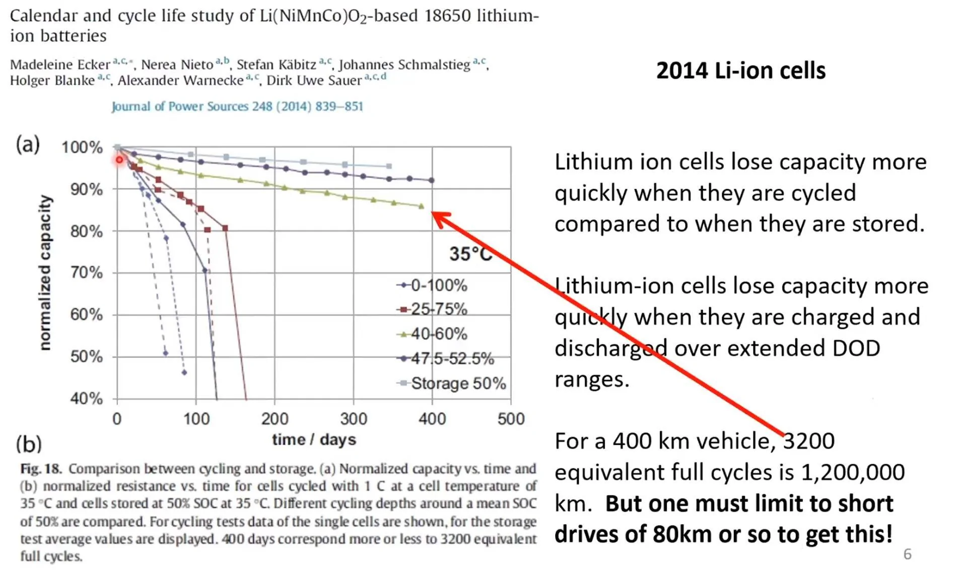

Ten year old info, but perhaps still applies? Limiting HV battery charge cycles Delta to extend HV battery life:
Ford F-150 Lightning Ideal Charging Practices ? Battery life short charge range cycles better 1706369574260
