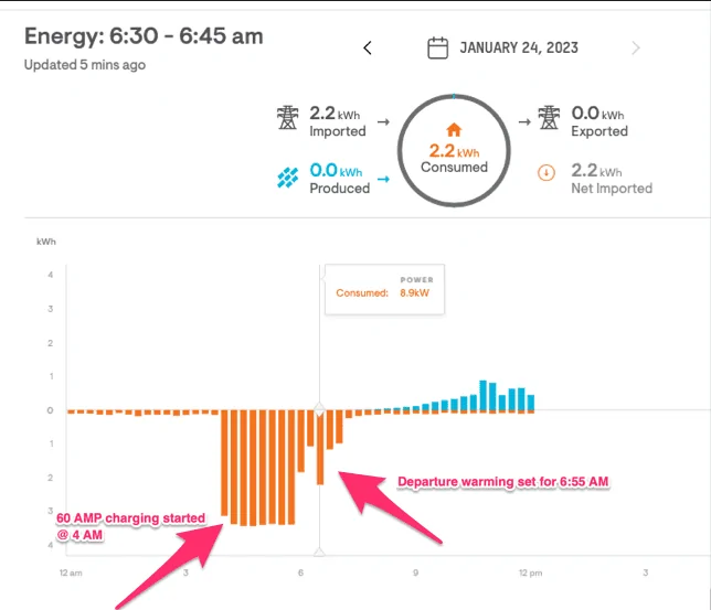

Test #4 - FCSP set to 60 AMP - with Preconditioning
- Charging set to start at 4:00AM (54.5% SOC, 57.8 kWh)
- Temp: HVB Min 39.2 F/ HVB Max 41
- Charging finished at approx 6 AM. (80.5 SOC, 96.38 kWh)
  • NOTE: I did not get the temp checked at the time in which charging technically stopped at 80.5% soc.
- Preconditioning set for 6:55 AM
- Battery temp at completion of preconditioning at 6:55 (HVB Min 57.2 F/ HVB Max 62.6)
- Garage temp per Truck reading was 39 F at start and Finish.
Summary added ~19 to 20 F in 180 minutes. 38.58 kwh added
Hypothesis? 60F is perhaps the target battery temp for Preconditioning? I will test 80 AMP with preconditioning and see how warm it gets to validate.
I also attached my energy graphs from solar to show the "blend" from charging to preconditioning

Nice Enlighten Screenshot :)
