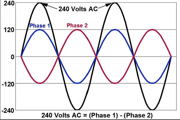

You get zero volts. The same as not even plugging in.

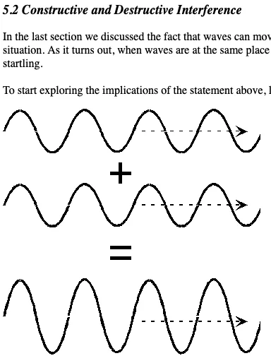

Can you explain this? I've always been under the impression that signals (rf, electricity, light etc..) in phase are additive ie constructive interference, and signals that are 180 degrees out of phase are destructive. So if the two outlets were 180 out, I could understand a zero voltage, but if they were both in phase, wouldn't that double the voltage?
You have it backwards.
2-120vac 180 degrees out of phase measures 240vac

I don't understand it as it goes against what little I know about physics, but I will take this as a learning point and hopefully will understand it one day.
I’m not sure if interference is the same but I’m going off the peak and bottom differences.
You are t using the terms “in phase” and “out of phase” correctly.
Post 18 is the technical explanation, but in simpler terms, you asked “What if both are fed from the same phase…?”
That basically means that both “hot” wires originate from the same place. It’s the equivalent of measuring voltage between both ends of the same wire!
