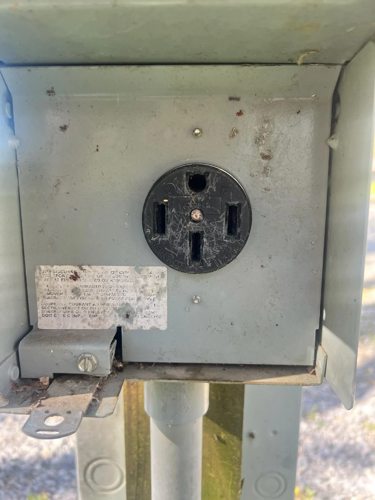

Hi folks, I've had my lightning for 3 months and have only charged from my home charger (Pro provided by Ford).
I'm about to take my first trip from Austin, Tx to Mountain View, Arkansas so my first experience with using 3rd party chargers.
The area in Arkansas is somewhat remote and doesn't have many charging options other than RV spots with 50 amp plugs (see pic).
My question is if there are any risks associated with using the Ford provided, mobile charger, at this 50 amp RV site?
If it will work, how long should I expect to charge from say 20% to 85%?
Many thanks in advance! Oh, and I will be pulling my bike (see pic) so any advice on towing longer distances would be appreceiated.

That is not true. The NEC specifically has sizing for RV park receptacles based on known demands for the use they are being designed for and they allow the service to be quite a bit smaller than if it was not an RV park. EV chargers on the other hand are in another section and you have to take the charger at 125% the connected load.
This means that if you try to charge your EV and you're sharing your receptacle with a couple RVs, you are way more likely going to cause that circuit to trip.
Yes, I've charged overnight at 50 amp rv sites across California without any issues. I never asked for special permission and never got any negative feedback about it.
