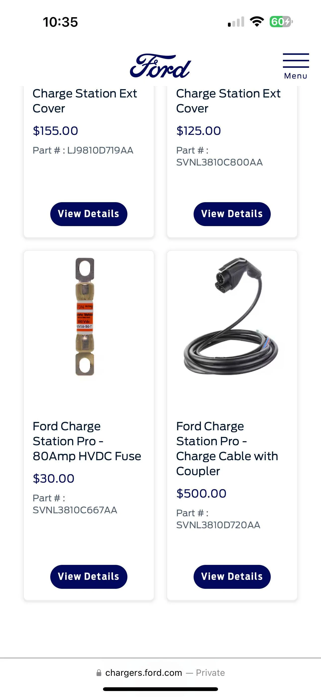

Chargers on the Ford website also offers replacement parts
