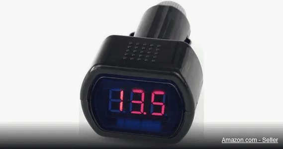

A OBD isn't required, only a $7 volt meter
What is the SOC at 13.5 volts?
You have to be careful which one you buy, though. I had one that routinely measured about 0.3 volt lower than the voltage read across my Honda battery terminals with a multimeter. I forget whether I checked the voltage across the auxiliary power outlet connectors, but I always just added 0.3 volts to whatever the plug-in device read.

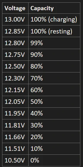

Find a table or graph of voltage vs. charge for your AGM battery model and interpolate if necessary:
Just an example. Not a table for Ford batteries
Ford F-150 Lightning LVB on Ford Website? 1722900559865-wo
Source: https://shopsolarkits.com/blogs/learning-center/agm-battery-voltage-chart

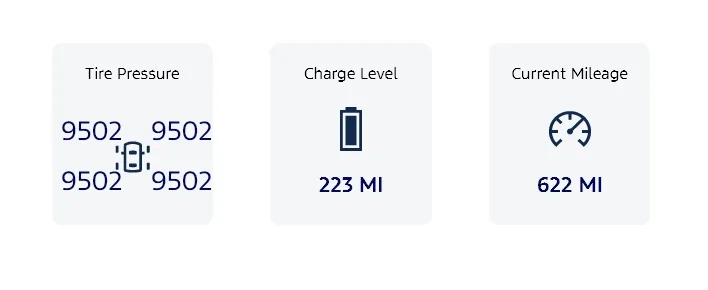

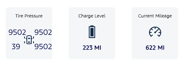

My account dashboard has been showing the HVB since the end of July 2024.
From other posts I thought it was the LVB, but it corresponded to the HVB level.
I was having issue getting an update too. So I charged to 90% with the FCSP while the truck was on, locked, lights off, etc., overnight, and that got the LVB up high enough for the update.
Afterwards I got some crazy info from my on-line account dashboard about tire pressure!
Ford F-150 Lightning LVB on Ford Website? tire pressure - OMG
I looked outside to be sure my truck had not been blown sky high by the tire pressure - still firmly planted on planet earth.
A little while later, one of the tires had come back down a bit:
Ford F-150 Lightning LVB on Ford Website? tire pressure 2 - OMG
Weird science!
Weird science!
Did you get an update?
Take her for a drive around the block .... all will be well.

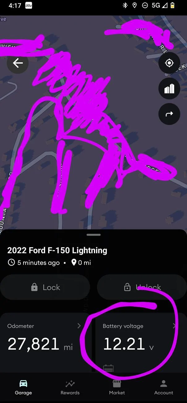

Now, of all things, my only real-time LVB level is shown in the DIMO app, which seems ridiculous. Why on earth would they change the LVB to the HVB SOC in the account page on the web Ford app? What could be the motivation?
Ford F-150 Lightning LVB on Ford Website? 1000007396
