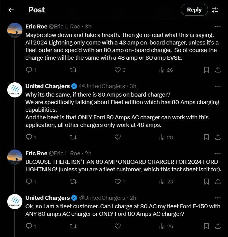

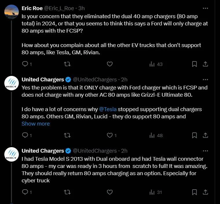

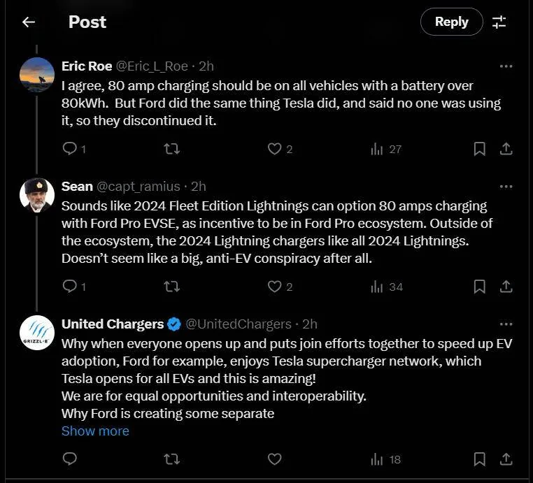

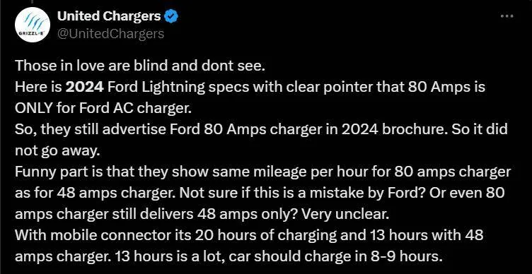

United Chargers, who makes all the Grizzl-E EVSEs, is claiming that Ford Lightnings can only charge at 80 amps on the Ford Charge Station Pro.
Has anyone charged at 80 amps (or more than 48 amps) on an AC/L2 EVSE other than the Ford Charge Station Pro?

They are claiming it on their X account in the comments. It is a horrible post, trying to use the '24 as an example, without knowing none have it unless spec'd out in a fleet purchase.
Just a questionable post from a clearly uninformed person mad cause it makes their evse look bad.

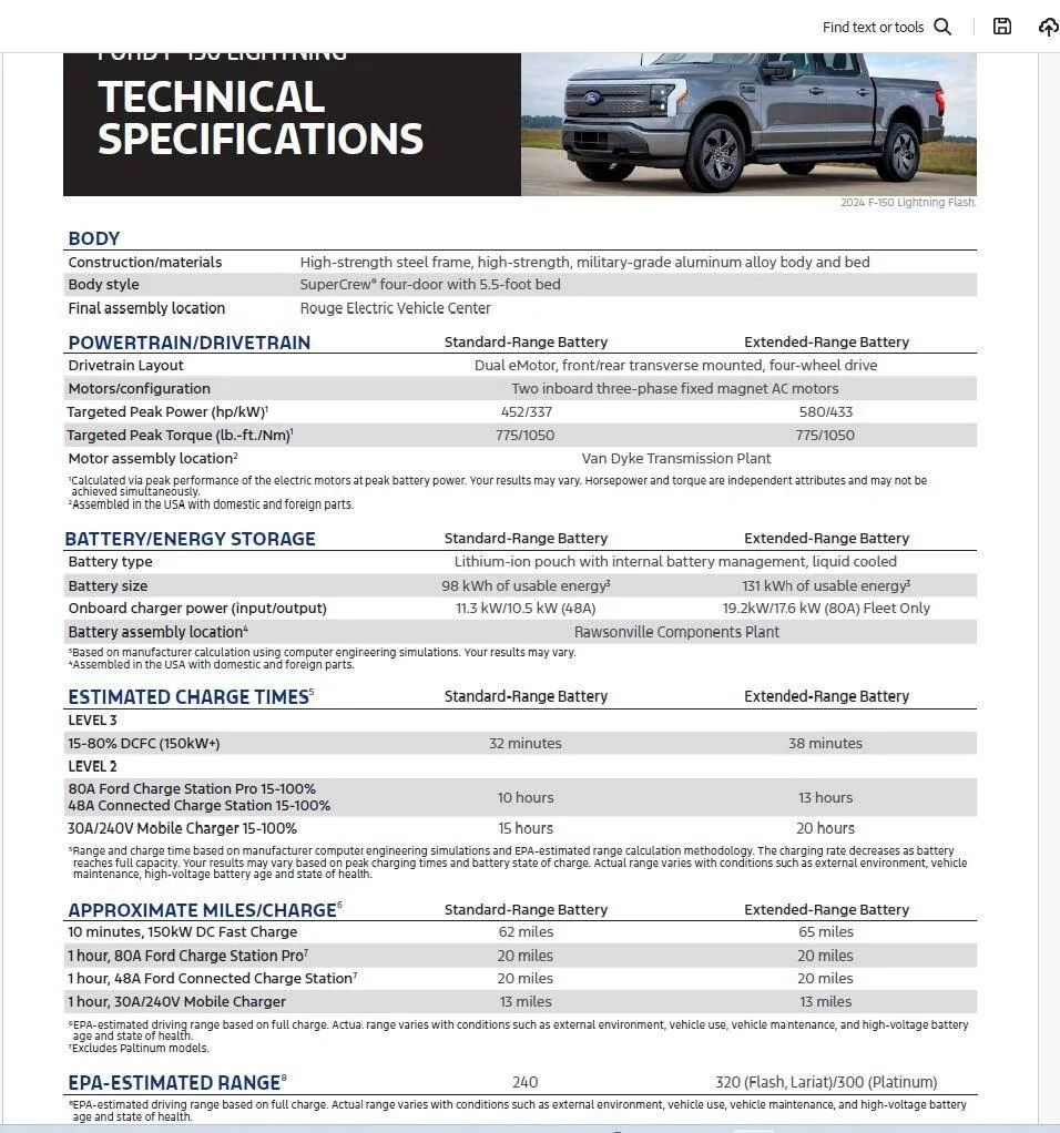

capt_ramius,
I found out the hard way that the 24s (including our Platinum) only have a single on-board charger which limits ANY EVSE charge to 48A. However, Grizzl-E gave me the same (wrong) info that a Ford Charge Station Pro would work (up to 80A) because Ford limited other, non-Ford, EVSEs to 48A.
There are are couple of discussions already on this forum about this issue—one of them started by me.
Bottom line—if you have a 2024 Lightning, you’re limited to 48A, unless you have a “fleet” model with dual on-board chargers.
