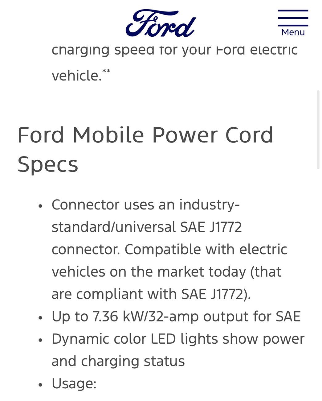

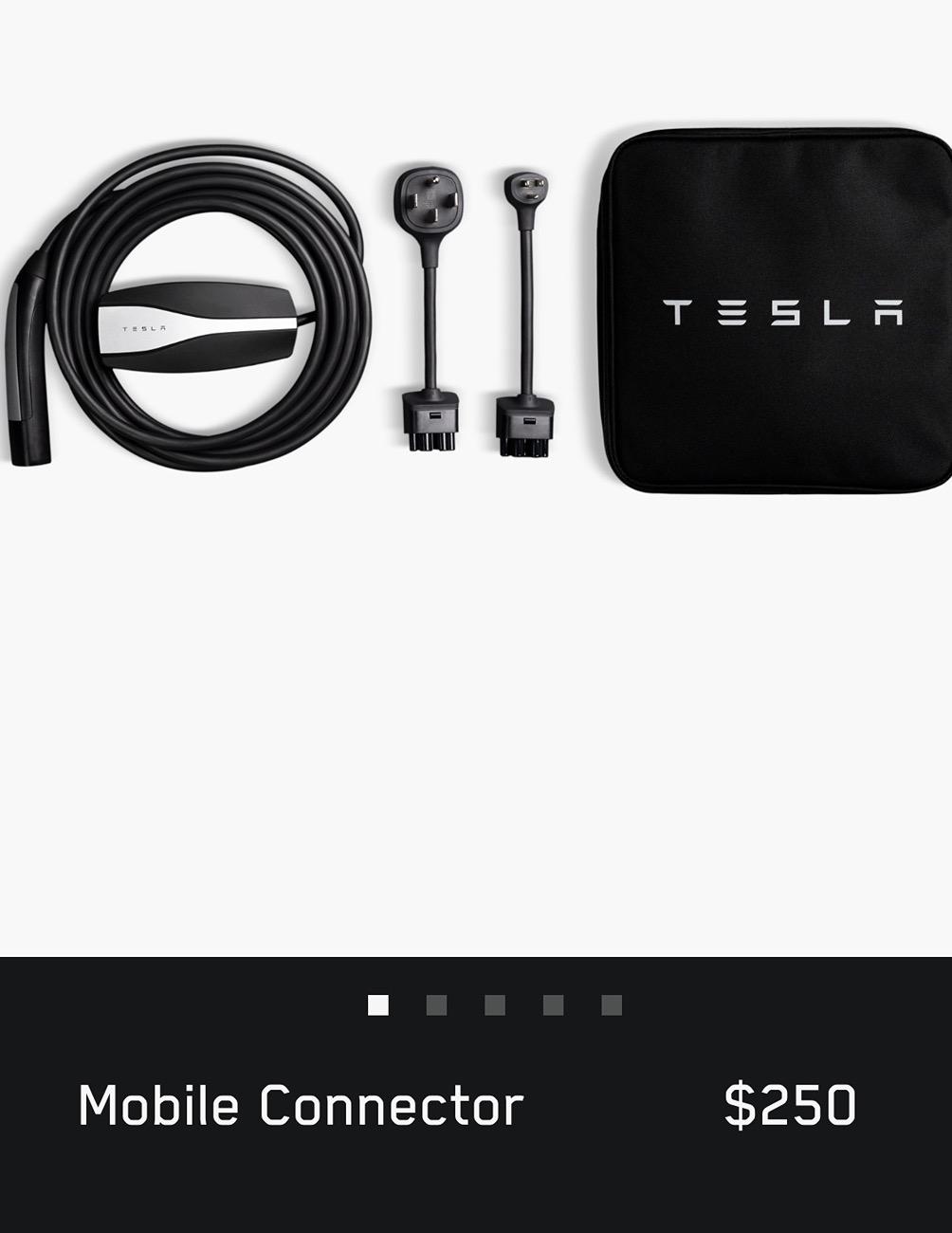

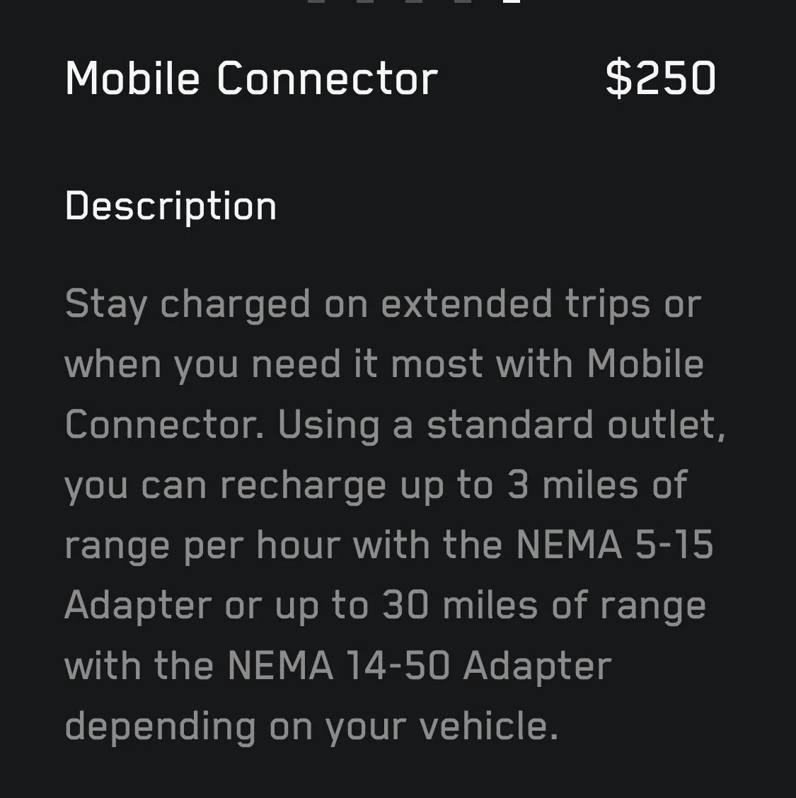

Aren't both 32 amp units?
No. The Ford mobile connector is limited to 30 amps while the second-generation Tesla UMC is limited to 32 amps. The first generation Tesla UMC will go to 40 amps.
Unfortunately the 120V current limitation is a vehicle firmware issue, not something imposed by the mobile connector. This means that even if you have a Tesla adapter and a Gen1 UMC in your truck, as I do, you cannot charge at 16A on a dedicated 20A 120V outlet, nor can you charge at 24A on a campground TT-30.
This is an idiotic restriction in the truck, a bug really, but it seems likely that demand for Ford to change it is low enough that they never will.
