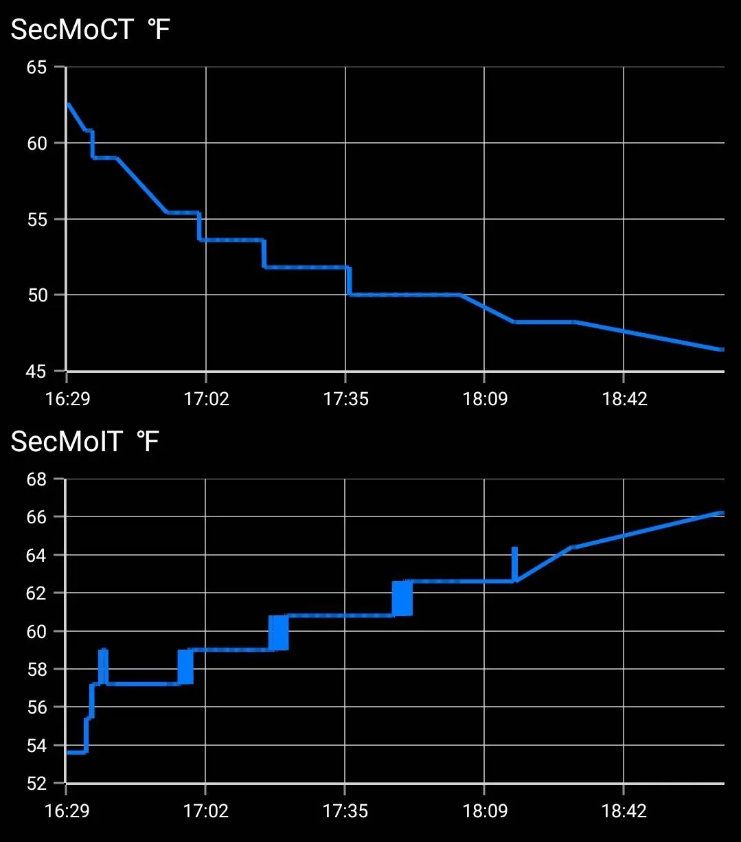

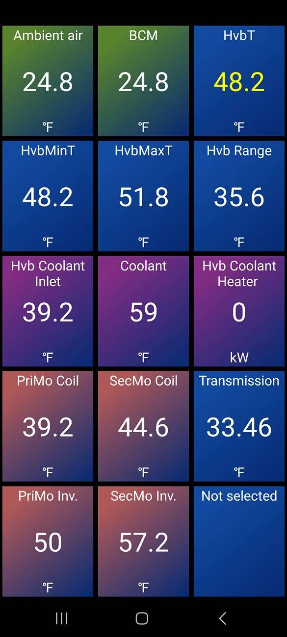

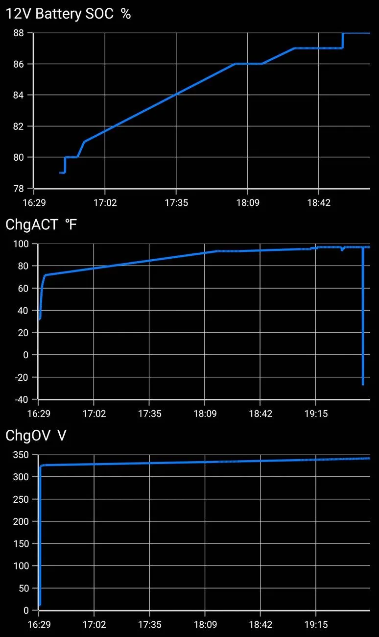

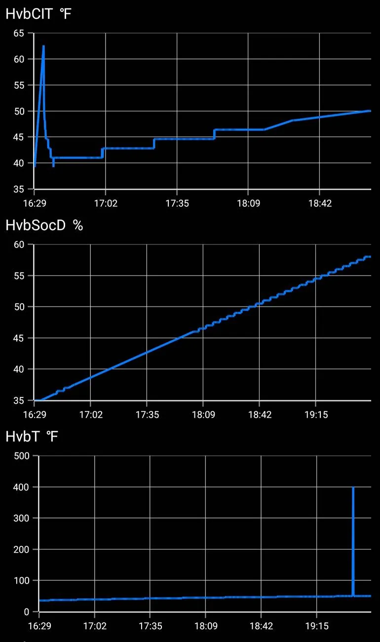

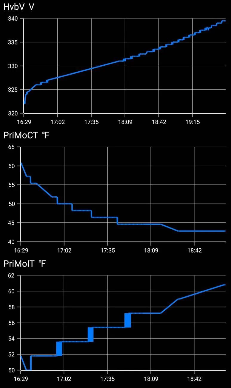

I went out for a 7 mile 20 min drive and raised the battery temp from 23 to 30. Ambient temp was between 20-30 for much of what is noted here. 3 hrs later on the way back raised it from 32 to 35 (not sure how it got from 30 to 32). Then plugged it in to charge at 32 A. Monitored the vitals with car scanner but phone got disconnected before I got to target 70% SOC. What is recorded is before SOC hit 58%. I thought some folks may be interested in a few of these charts:
In order:
12V SOC, Chargers Coupler Temp Location1, Chargers Output V
Ford F-150 Lightning Cold Cold Weather tips Screenshot_20241223_230450
Charger Temp L2, Charger temp L3, Average Module Voltage
Ford F-150 Lightning Cold Cold Weather tips Screenshot_20241223_230503
Coolant Inlet Temp, SOC displayed, HV Battery Temp
Battery temp went from 35F to 48F in this period. I am hoping that spike is a data glitch and hopefully it was not an exploding cell.
Ford F-150 Lightning Cold Cold Weather tips Screenshot_20241223_230511
HVB Voltage, Primary Motor Coil Temp, Primary Motor Inverter Temp
Ford F-150 Lightning Cold Cold Weather tips Screenshot_20241223_230520
Secondary Motor Coil Temp, Secondary Motor Inverter Temp.
Ford F-150 Lightning Cold Cold Weather tips Screenshot_20241223_230551

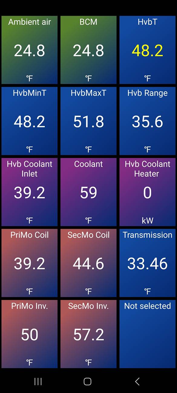

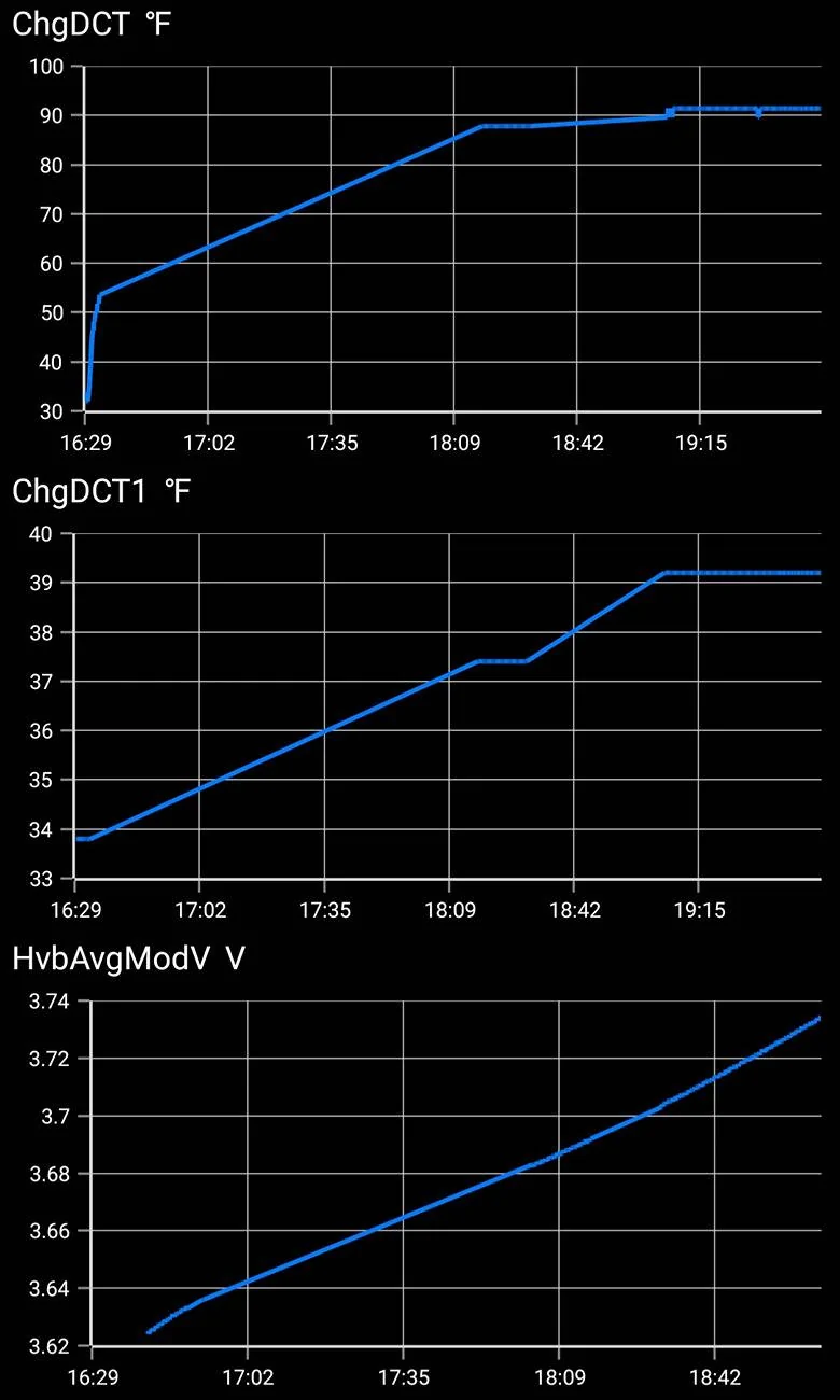

2 - What is the easiest way to get the battery above freezing before my unplanned departure? I have my driving info sharing off so I don’t see a lot of features including departure times in the app but I don’t mind walking to the truck to do anything I need to do. Is there a secret β€œprecondition now” button somewhere?
I have found that to "precondition now" all you have to do is fully start the truck while it is still plugged in. You do need to make sure the HVAC is off though or it will just preheat the cab. You also need to leave the keys in the truck or it will turn the truck back off when you walk away.
I have done this a half dozen times in the last few months and it works great. You can double check it with Car Scanner and you should see the coolant heater ramp up to 9 kw and the HVB coolant inlet start heating up.
See the bottom right cells on the image.
This rocks. I will definitely try this. Thank you.
