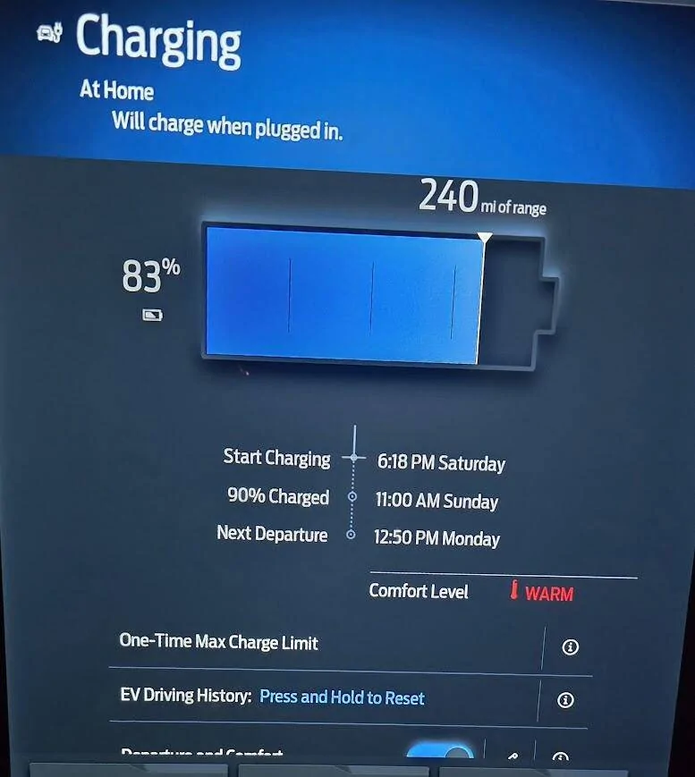

One important note on Departure Times/Preconditioning: It appears the truck prioritizes charging to SOC over preconditioning. Make sure you have enough time to get to your SOC before your preconditioning window hits or it may not precondition. The preconditioning window can be up to 2 hours before your departure time. This is most noticeable when charging to 100% since it does a cell/pack balance between 99%-->100% SOC. If you are unsure if you have the time for 100%, set SOC to 95% for more reliable preconditioning.
These screens confirm the concept, this is before plugging in the truck, I am only 7% below my goal of 90% and my FCSP running at 80 amps has the capacity to restore the deficit in about 30 minutes.
After plugging in the truck & EVSE exchange data, this informs the truck that it can reach SOC goal well before the set departure time at 12:50 pm, charging on Sunday will start at 10:00 am, should be done by 10:30 am and the departure time is 12:50 pm. The first screen shot assumes the possibility of needing to start charging immediately with the capacity unknown at the moment.

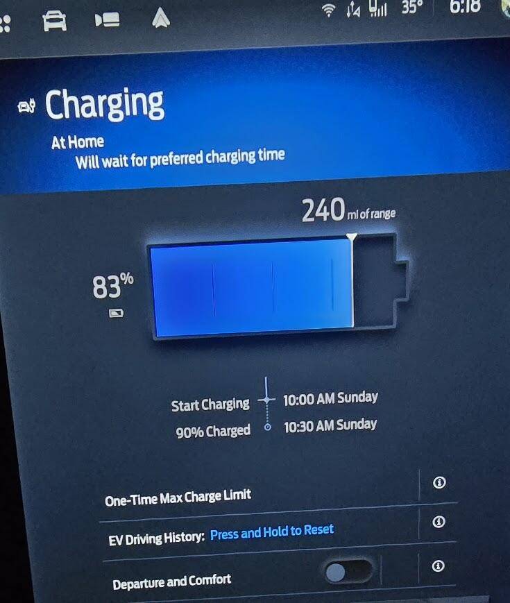

Notice the impact on the scheduled charge time when the departure & comfort is switched off.
Given worse variables, such as a lower SOC or a tight scheduling of events, I've seen the charging commence immediately after plugging in.

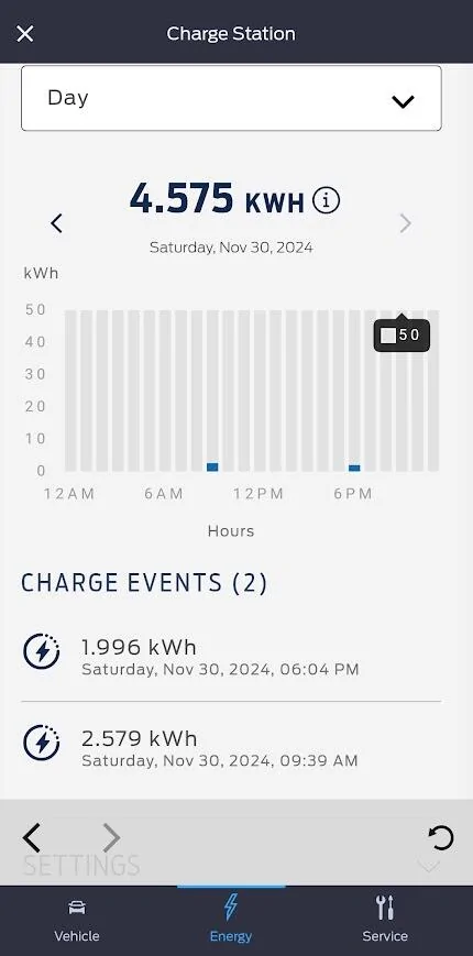

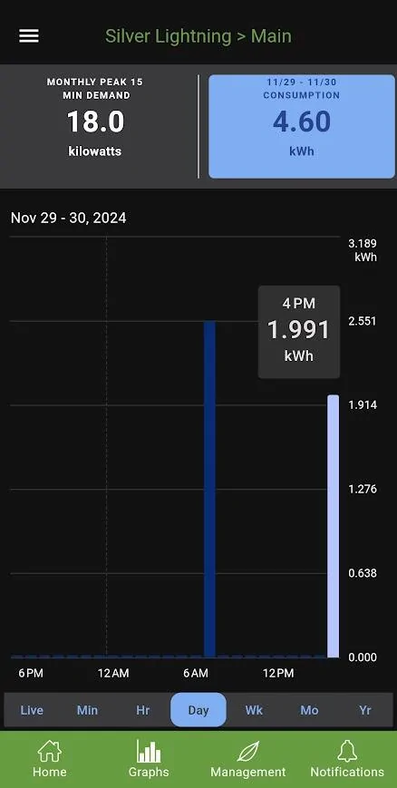

I did a second departure time test this afternoon, again with the charging SOC goal shorted to below present SOC to block possible charging energy, I also switched off cabin conditioning.
The purpose of the test is to see how much of the morning warm-up was lost to the environment. Simulating a work schedule where one is to prepare for homebound commute, only factor that may negatively affect the results is the heat created during a morning commute, the motor inverters, gears and battery create heat, I'm not creating any by leaving the truck parked in the cold garage all day, actually have not driven the truck for over 32 hours, Temperature was high 30's peak temp mid day was ~41 degrees.
Departure time goal is 4:50 pm, battery conditioning phase kicked off at 4:08 pm, ran 11 minutes finishing at 4:19 pm, total energy to get the temperature to spec. is 1.991 kWh

FCSP proves the energy needed, 1.996 kWh to warm up the battery again.

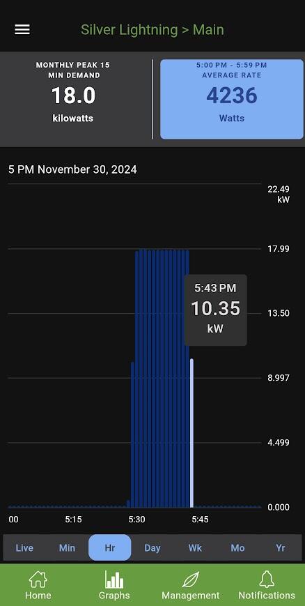

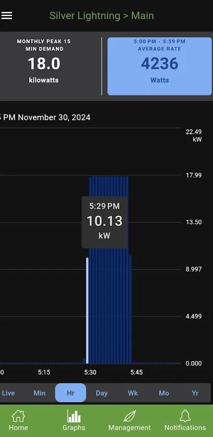

Then after letting the truck sit for a while, I did a remote start to warm the cabin, seats and steering wheel over a period of 15 minutes. This is the power flow to warm up the cabin only.
Ford F-150 Lightning Cold Cold Weather tips 1733013275008-2i
Ford F-150 Lightning Cold Cold Weather tips 1733013294906-6b
Ford F-150 Lightning Cold Cold Weather tips 1733013326706-ai

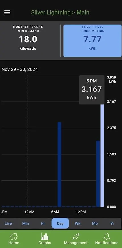

The FCSP energy for remote start / cabin climate conditioning, shows 4.222 kWh, a bit more than the Emporia measured at 3.167 kWh
The times on the chart are encoded from the most recent FCSP setup that I did in the fall before the change from EDT to EST, the FCSP does not automatically change DST value, the Ford cloud takes the date stamp at face value.
Total energy for the day's battery warming phases and one cabin warming phase consumed 7.77 kWH, if I had done a cabin warming phase in the morning similar to the afternoon event, grand total energy for conditioning would be about 11 kWh, or about 300 kWh per month, at my local energy rates @ 33.3 cents a kWH that's $100.
Again, for my driving conditions, moderate speeds, low loads, short trips, battery warming is not super beneficial, YMMV.
