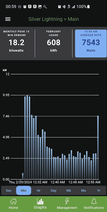

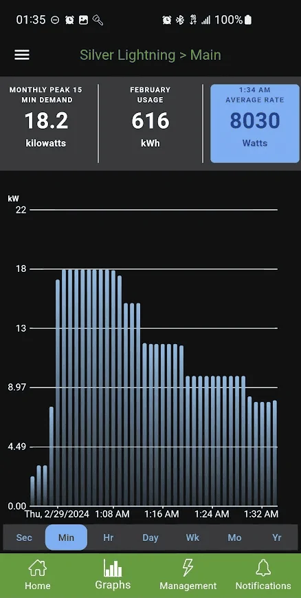

Here is an example of the PTC working, note that at this point the battery had gone through a departure time pre-conditioning process to warm the traction battery and is not working to warm the cabin, note how it steps down by apx 2.5 KW.
When you see it jump up at 12:58 am, that is me clicking the Charge to 100% button to enter the top up phase of my pre-tripping preparations on 2/29

You can see the heater current draw with an OBD dongle. I've only looked at it during charging (no cold weather since I got my OBD dongle) but it draws 8.x kilowatts while heating the battery, so ~9 kW nominal sounds right. 23 XLT ER
