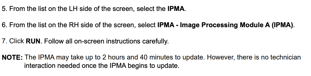

Sweet. Let us know how long it takes. The TECH instructions says it can take 2 hours and 40 minutes!
I find that hard to believe though

Just dropped off the Lightning and they showed me on their screen it takes 12+ hours just for the 24B56 update. They're also accomplishing 23B57 & 23B70 so indicated it may take several days if there's any issues.
sfringer
Scott
Nov 13, 2023
127
186
NC
That's interesting as in the tech note attached to the start of this thread it indicates it could take 2 hours and 40 minutes.
