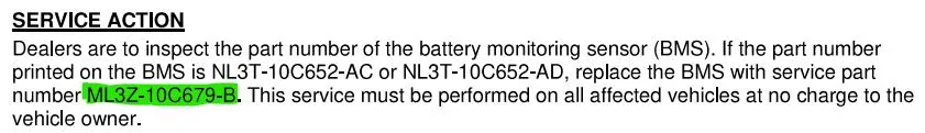

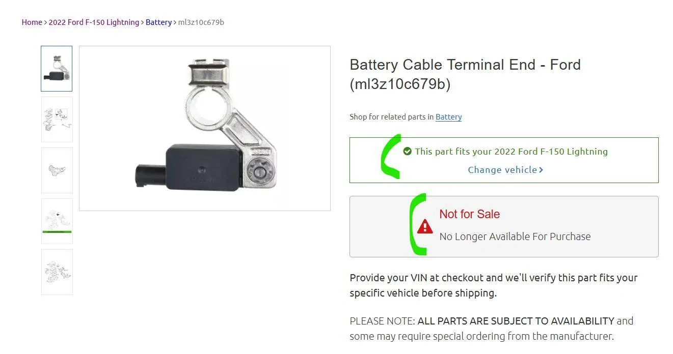

Yes, but Tasca put a retail sale block on the part after and a few other members bought them, this may still be in place, easiest thing is to go to your dealer parts counter and have them sell you one directly, now that the CSP has expired I see no reason to embargo retail sales, Tasca should release the hold as well.
https://www.tascaparts.com/oem-parts/ford-battery-cable-terminal-end-ml3z10c679b
Ford F-150 Lightning CSP-23B70 Certain 2022-23 F-150 Lightnings - BMS Sensor Replacement 1736685373149-40
https://www.f150lightningforum.com/...tning-csp-23b70-bms-repl-dealerbul-pdf.77576/
Ford F-150 Lightning CSP-23B70 Certain 2022-23 F-150 Lightnings - BMS Sensor Replacement 1736685121843-ws
https://ford.oempartsonline.com/oem-parts/ford-battery-cable-terminal-end-ml3z10c679b

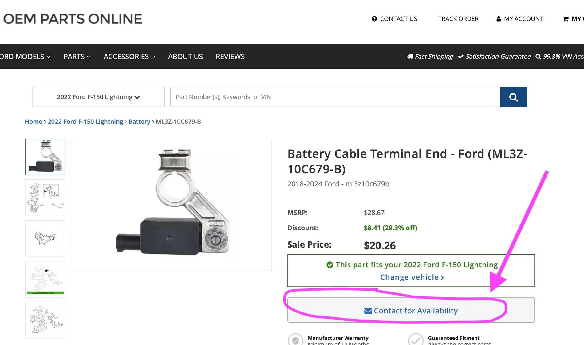

mrau
Feb 2, 2024
386
526
23 Lariat⚡ER
Site says to contact for availability.
