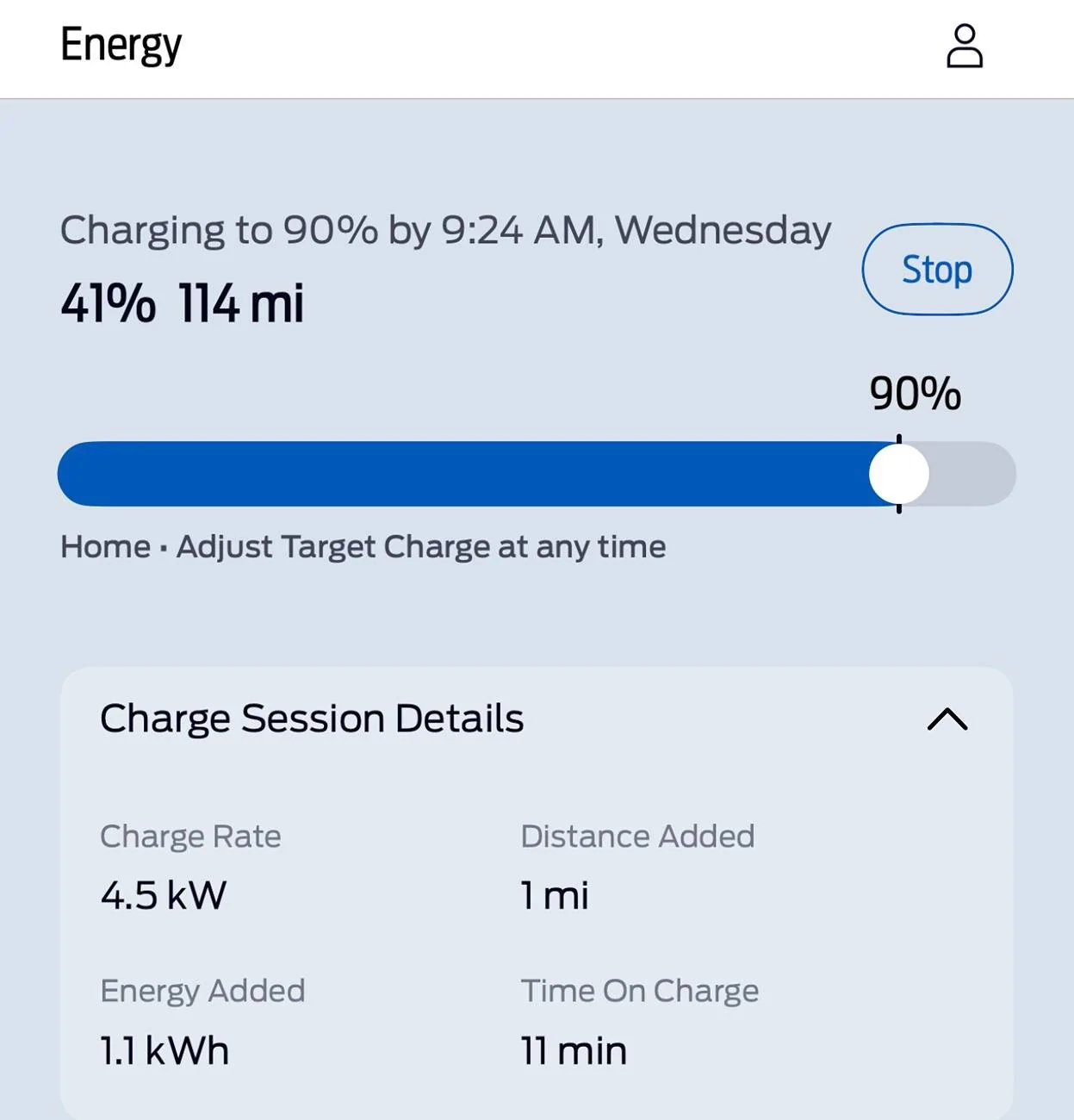

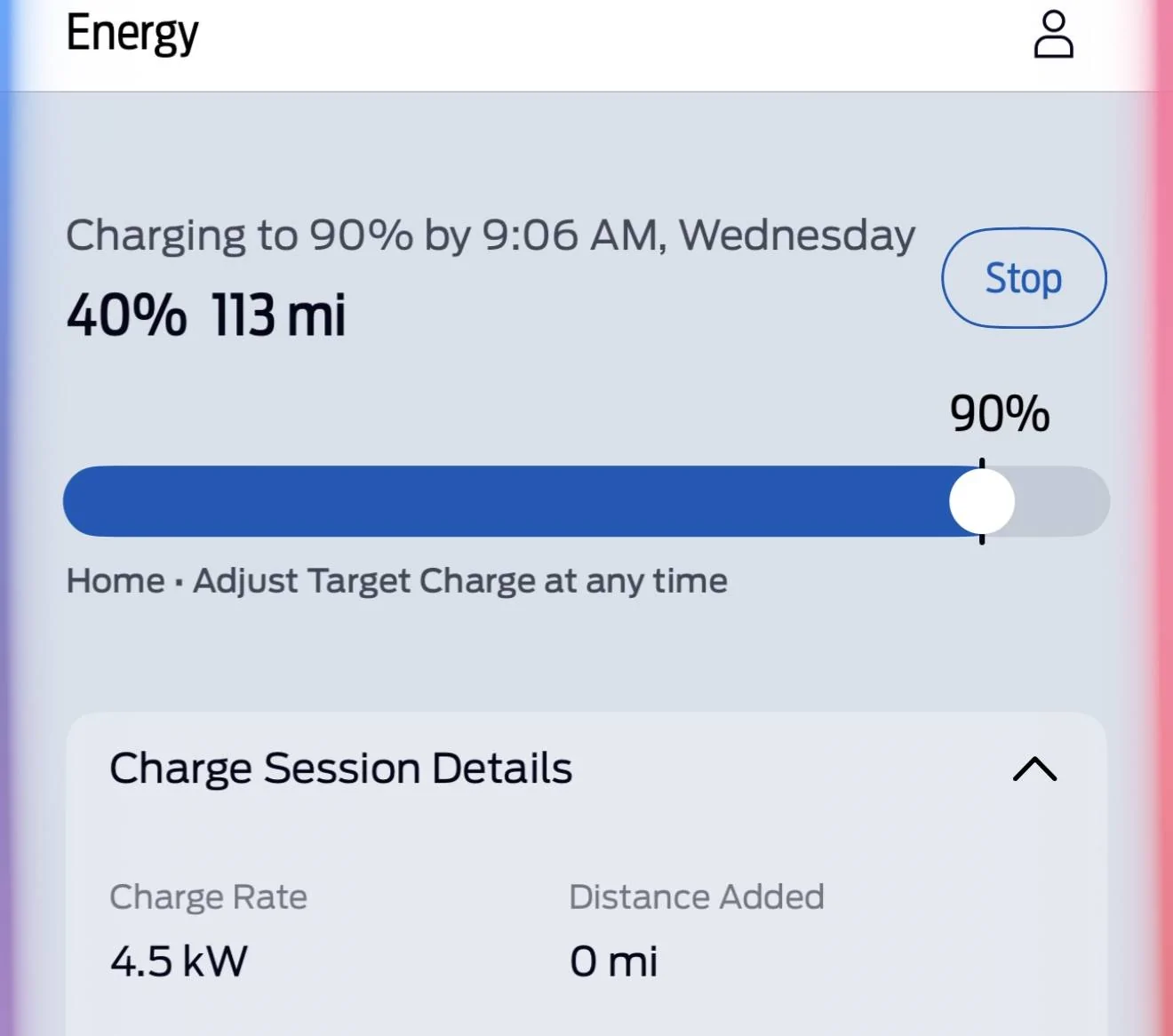

CSP is de-rating upon plugin after 2 years. 100 A circuit.
problem free 15 to 16 kWh charging. Now 4.1-4.4 upon plugin.

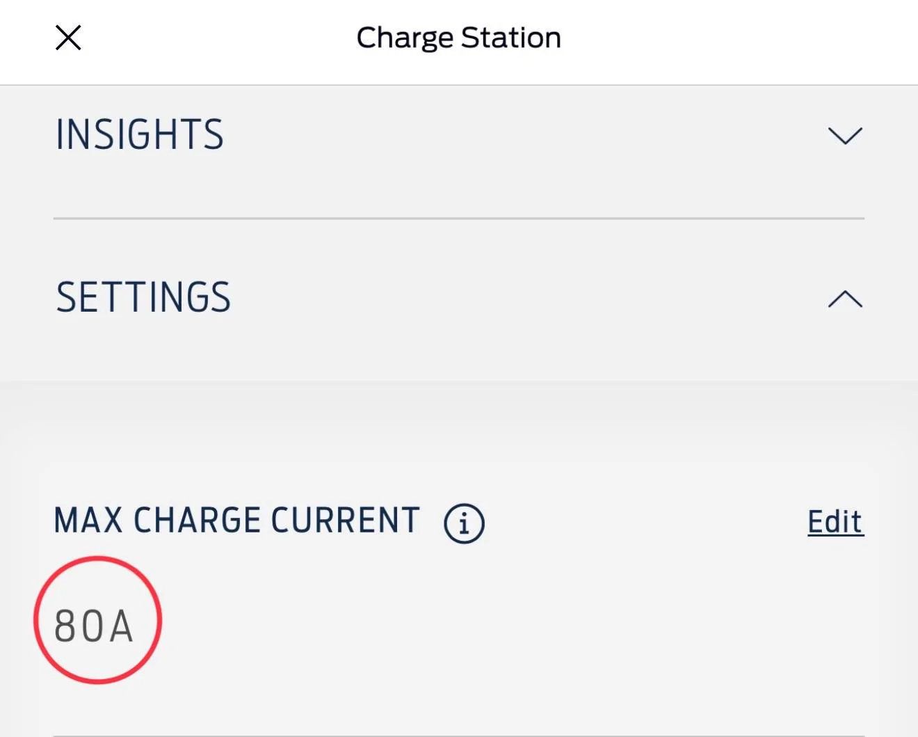

Environmental and battery temp not an issue. problem for past 2 months, though for a bit I could get it back to 15 by re-saving 80 amp setting.
can connect to charger with Ford Pass(FP). 1) set to 30 amps > save. Set back to 80 amps > save
briefly rises to 16kwh, then derates back to 4.4 ish
checked lugs at all points of installation. Rebooted CSP
question:
any troubleshooting suggestions?
warranty, is that 3 year/36k?
haven’t pulled out the manual, but is there a number for Charger dept?

You say your environment and battery temps are ok. But what about the charge port temp?
12,152
12,805
Hopefully it's not an overheating issue due to loose lug on the 240 volt power lines inside the cabinet.

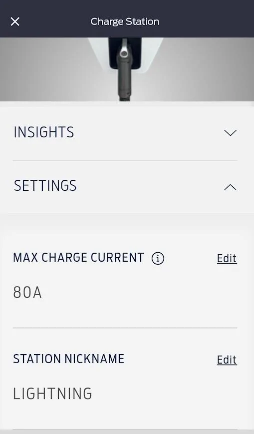

Several month's a few of us tried adjusting the FCSP amperage rating, the adjustment would not always stick, but I tried changing the device nickname and that seemed to make the value change post to the device.
Add a character to your device name and also lower value to 70 amps to see if it has an effect, do this while it's not plugged in and charging.

The truck will throttle the charge rate if it detects an overheated charge port. It could even be a faulty charge port temperature sensor. The quickest way to isolate the problem is to try another EVSE.

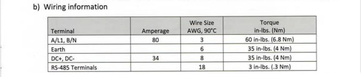

Also, the terminals for the power to the FCSP need to be torqued to the correct amount or else amperage will be reduced due to heat. That could be your issue - they can come loose over time due to heating up and cooling down.
60in-lbs for the power lines (hots) and 35in-lbs for the ground.
Ford F-150 Lightning CSP: auto de-rating to 4 ish kWh after 2 years (see photos) charge Station Pro wiring information
