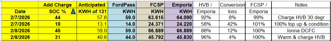

The truck knows the capability of your charger/evse, so let's say you need to charge 80 kWh and your EVSE is capable of 9kW, then just start the charge 9-10 hours prior to departure, no energy wasted heating things up and letting it cool, only to heat it back up again.
I charged everyday last week, timed to be within an hour of leave times, the trucks thermal management system still decided it needed to spend energy on warming the battery every charging session, my net efficiency plummeted, normally it's around 92% energy consumed goes into the HVB, while this very cold week had the value drop to 50-60%, and this was not using any departure times.
So intentionally eliminating the warming phase might lower battery health & longevity over the long term.

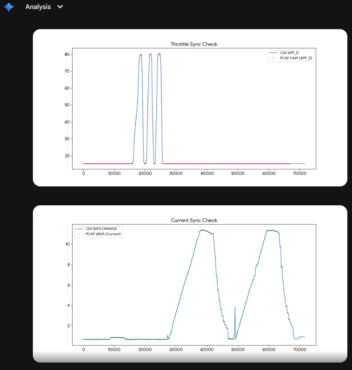

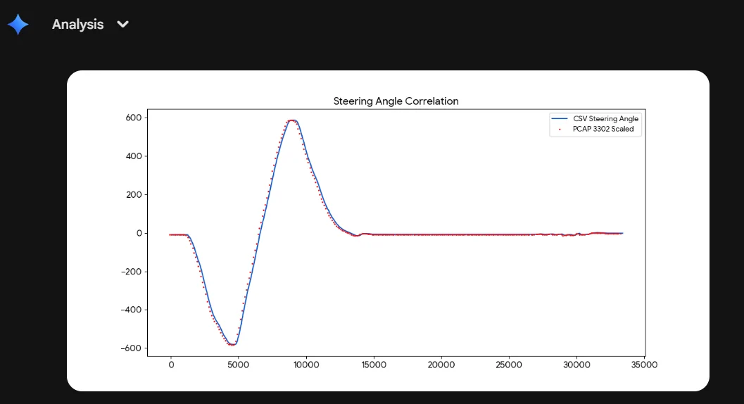

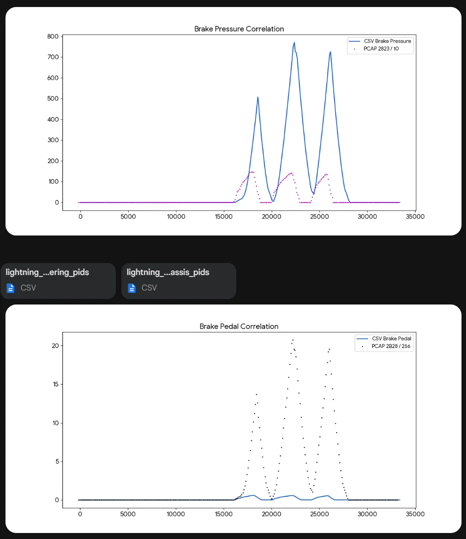

I’ve been working on getting better data visibility for my F-150 Lightning. While FORScan and Car Scanner are the gold standards for seeing what’s going on, they are not always the most convenient tool for long-term logging or custom dashboards. I wanted to move that high-level data into Torque, but that requires knowing the exact hex PIDs and the specific math formulas Ford uses—and the current PID list is inadequate.
To solve this, I used Google Gemini Pro as a data science partner. By feeding the AI raw Bluetooth packet logs and comparing them to live app data, I was able to bridge the gap. We aren't "finding" PIDs that didn't exist—FORScan already sees them—but we are deconstructing them so they can be used in other applications.
The Breakthrough: AI-Enabled Correlation
Typically, matching raw hex values to real-world sensor data requires significant experience in signal processing or software engineering. You have to account for clock drift, filter out thousands of background messages, and solve for linear equations (Scale/Offset) manually.
By using Gemini , I was able to upload the raw .pcapng packet logs and the CSV logs from the diagnostic apps directly. The AI performed the time-syncing and regression analysis automatically. You still have to validate the results, in one instance it switched brake pedal travel and LF brake pressure, but to be honest it also identified that the brake pedal travel PID had unusually high precision. This mistake is not surprising, brake pedal travel and pressure exactly matched (truck was parked) so the plots looked near the same.

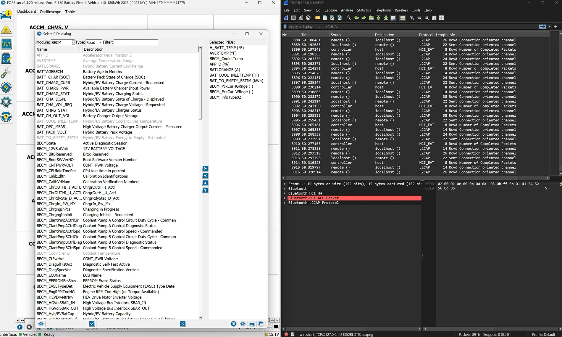

1. The Sniffer Setup (Windows)
Standard Wireshark on Windows can’t see Bluetooth traffic without help. You need the Microsoft Bluetooth Virtual Sniffer (BTVS).
  • Download: Get the "Bluetooth Test Platform" from Microsoft.
  • The Shortcut: Navigate to the folder containing btvs.exe. Click into the Address Bar of your File Explorer, type cmd, and hit Enter.
  • Launch: In the command window, type btvs.exe -Mode Wireshark. This will open Wireshark and start piping your Bluetooth traffic into it.
2. The Capture Session
  • Laptop Method: Run FORScan and select 5–10 PIDs you want to map. Start your Wireshark capture and perform a specific action (e.g., sweep the steering wheel or plug in a charger).
  • Android Method: Enable "Bluetooth HCI Snoop Log" in Developer Options. Run CarScanner or similar, do your test, and then pull the log via a Bug Report.
Ford F-150 Lightning Deconstructing the Lightning: Using AI to Map PIDs for Torque {filename}
3. The Analysis
Once you have your logs, you can use an AI like Gemini to do the math. Tell it: "I have a Bluetooth log (hex) and a sensor log (decimal). Match the timestamps and find the hex PID and the formula for [Sensor Name]."
What We’ve Mapped So Far
Through this process, I’ve already moved several high-fidelity sensors over to Torque:
SensorPIDEquationHeader
High-Res SOC224801(A*256+B)/5007E4
Brake Pressure (LF)222B28(A*256+B)/6.89760
Charging Power (W)22484E(A*256+B)*57E4
Energy to Empty (kWh)224848(A*256+B)/5007E4
Call to Action: Let's Build the List
This is just the start. There are hundreds of PIDs available in the different modules. Tons for the IPC, IPMA, APIM, etc. If you have a favorite sensor or trigger in FORScan that you wish you had in Torque, use the pathway above to capture a log (or give me a shout).
Post your logs or your findings here, and let’s see how large of a "community dictionary" we can build for the Lightning.
Torque values extracted (copy to torque csv).
Name,ShortName,ModeAndPID,Equation,Min Value,Max Value,Units,Header
Battery SOC (High Res),SOC HR,224801,(A*256+B)/500,0,100,%,7E4
HV Battery Current,Amps,22480A,(SIGNED(A*256+B))/100,-500,500,A,7E4
Charging Power,Chg Watts,22484E,(A*256+B)*5,0,20000,W,7E4
Battery Energy to Empty,kWh Rem,224848,(A*256+B)/500,0,150,kWh,7E4
Accelerator Pedal Position,Throttle,22F449,A/2.55,0,100,%,7E4
Steering Wheel Angle,Steer Ang,223302,((A*256+B)-7810)/10,-900,900,°,760
Brake Pressure LF,Brk Press,222B28,(A*256+B)/6.89,0,2000,psi,760
Brake Pedal Position,Brk Pedal,222823,(A*256+B)/2500,0,2,in,760
Lateral Acceleration,Lat G,222B0C,SIGNED(A*256+B)/100,-2,2,G,760
Battery Coolant Inlet Temp,Clnt In T,224846,(A-50)*1.8+32,-40,150,°F,7E4
This week I'm not charging daily, and expect to use ~40% SOC for my week day trips, I will recharge Saturday the 7th to 100% and include intentional departure warming on the HVB for another NH trip.
I expect the savings of lost energy to be worth the change especially at my high utility rates.
Off Topic follow-up, I only charged at the end of the week for my daily short trips, much less lost energy to battery-conditioning which isn't important for such short hauls. Then saturday I had a long trip to make where full departure time conditioning was used
Ford F-150 Lightning Deconstructing the Lightning: Using AI to Map PIDs for Torque 1770559945249-mv
Improved the overall MPK for the week, to 1.1 with the help of discounted energy from Ionno at 20 cents a kWh as compared to home charging at 35 cents and many commercial DCFC much higher (with-out membership consideration).
Ford F-150 Lightning Deconstructing the Lightning: Using AI to Map PIDs for Torque 1770560350413-r7
I now return you to your regularly scheduled pid discussions.
