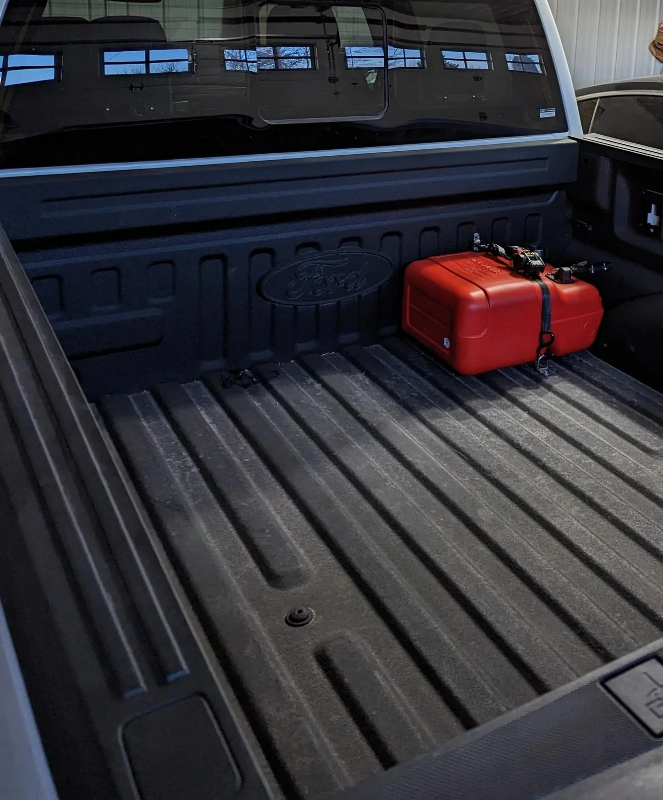

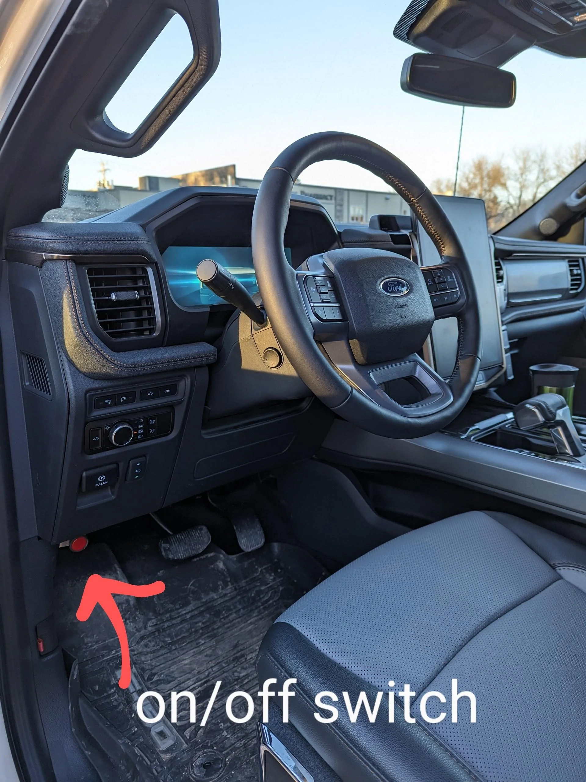

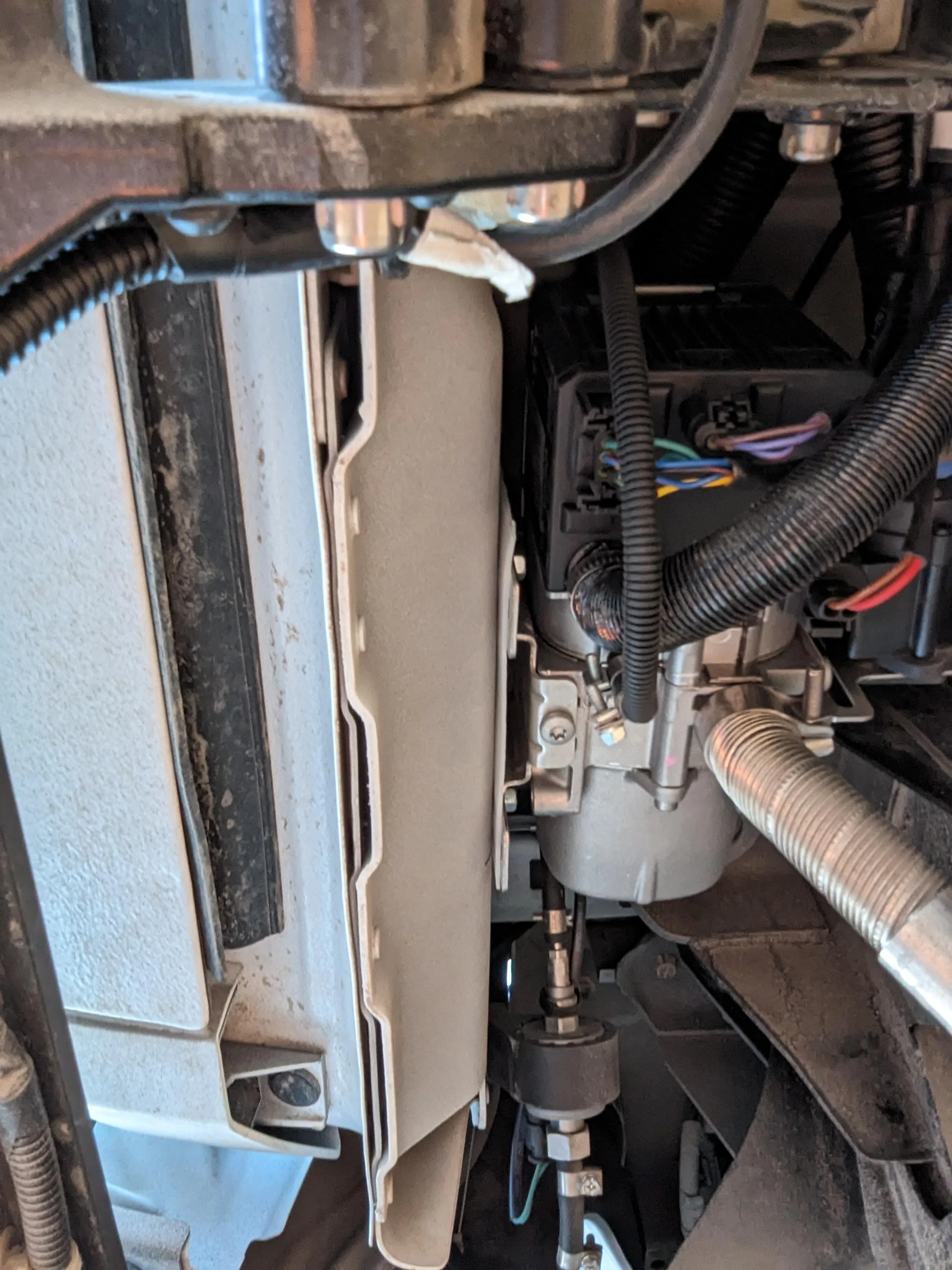

Can't put a thermostat if the pump fluid goes to slow it throws errors and shuts off
Just got this done.
Espar coolant heater (2-5kW).
Switch in cab with thermostat where the output line from the gasoline heater ties into the heater core.
Working very well so far.
Thanks for the inspiration!

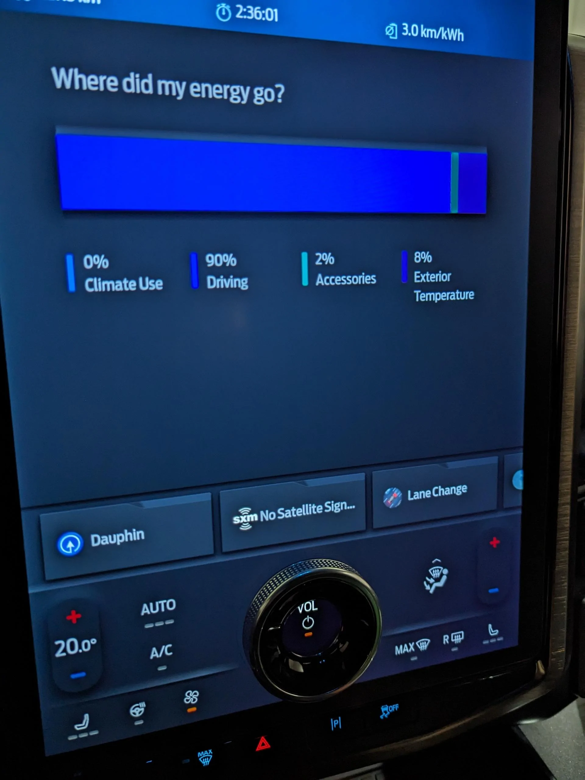

How are you finding your cold weather mileage with this mod?
MVO
Matthew
Nov 5, 2023
Manioba
F150 Lightning Lariat ER
As always, depends on many factors, biggest of which is speed/head wind.
Recent trip at about -10 C, 100 km/h with a 14 km/h head wind, I got 3 km/kWh.

This is great! If you wouldn’t mind, could you share some pics of how/where you spliced it into the heater lines?
