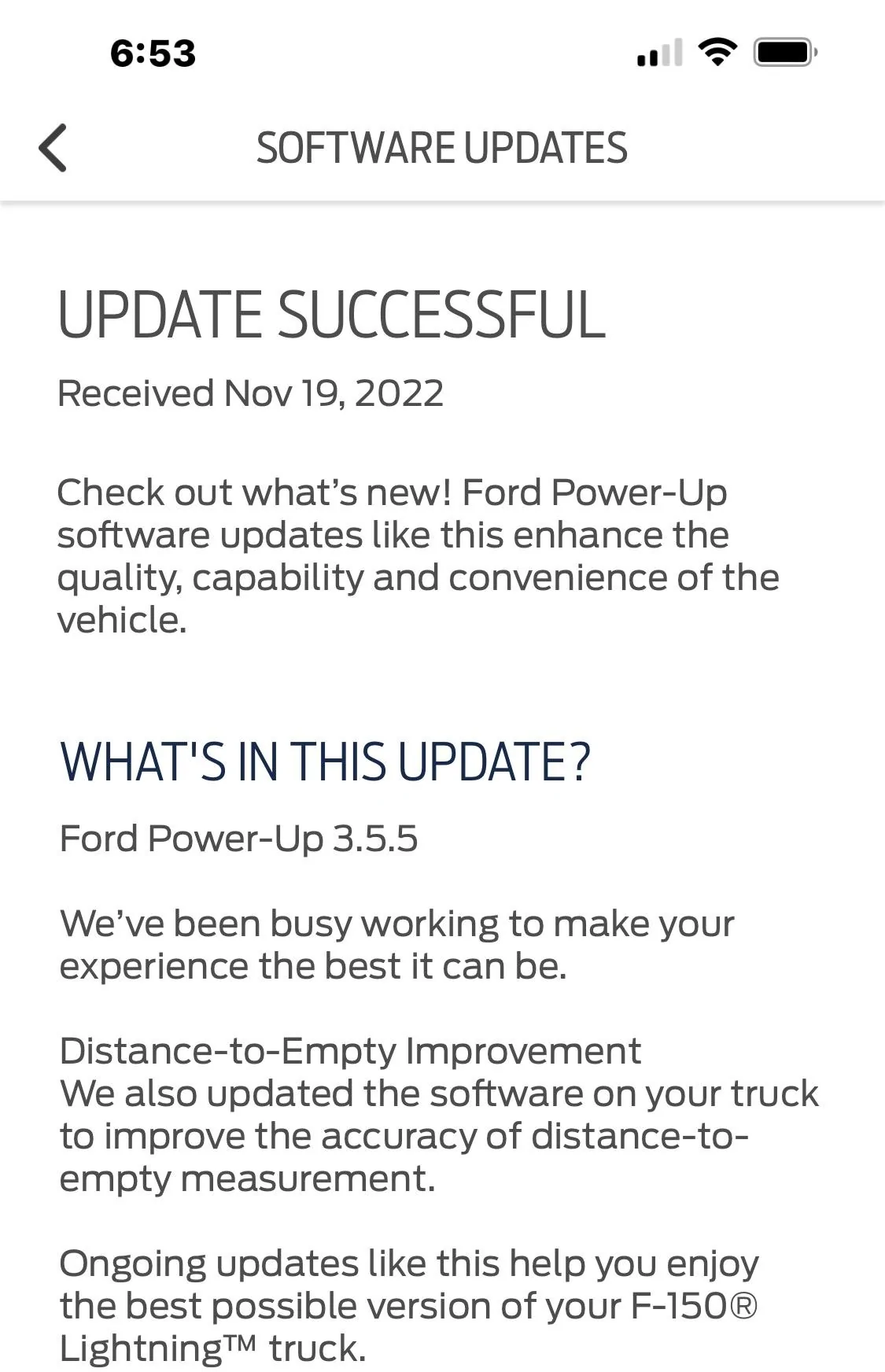

My experience so far is the GOM is on the conservative side. Today the temperature was in the mid fifties and I was getting around 2 M/KwH. The GOM was still giving me a range based off of 1.3 / 1.4 M/KwH which is what I was getting when the temp was 30F and I was hauling a ton of feed.
Yup, correct!
That's why Ford recently came out with Distance to Empty improvement OTA.
The MME owners are starting to see the update and they are seeing more realistic numbers than the super conservative GOM of the recent past...

Yup, correct!
Just to clarify this - Ford tested an improved DTE for a while, and this is rolling it out. In doing this rollout, it basically resets EV history and people see a very high number. On my Mach-E, I went from a range of around 190 - 200 at 100% to 284, is around the highest I've ever seen. This morning I'm at 262 because I haven't driven much and the temps haven't dropped back down to the 20s yet.
