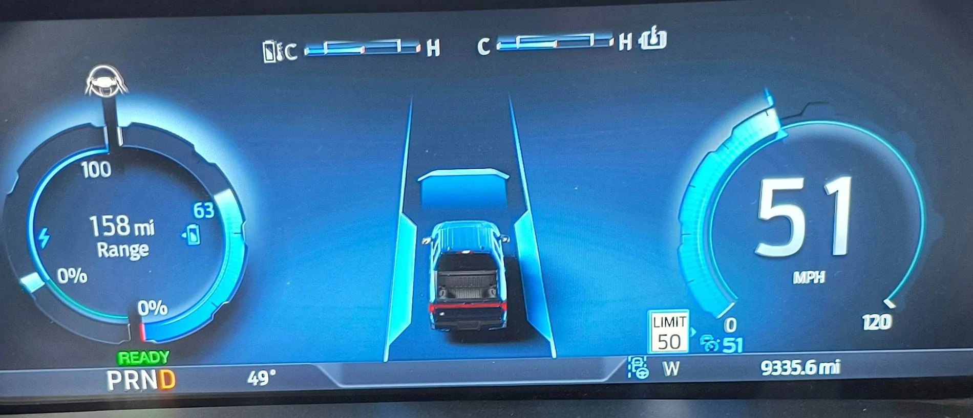

Just got home and did this. Regular cruise is working again with the new switch. Thank you.

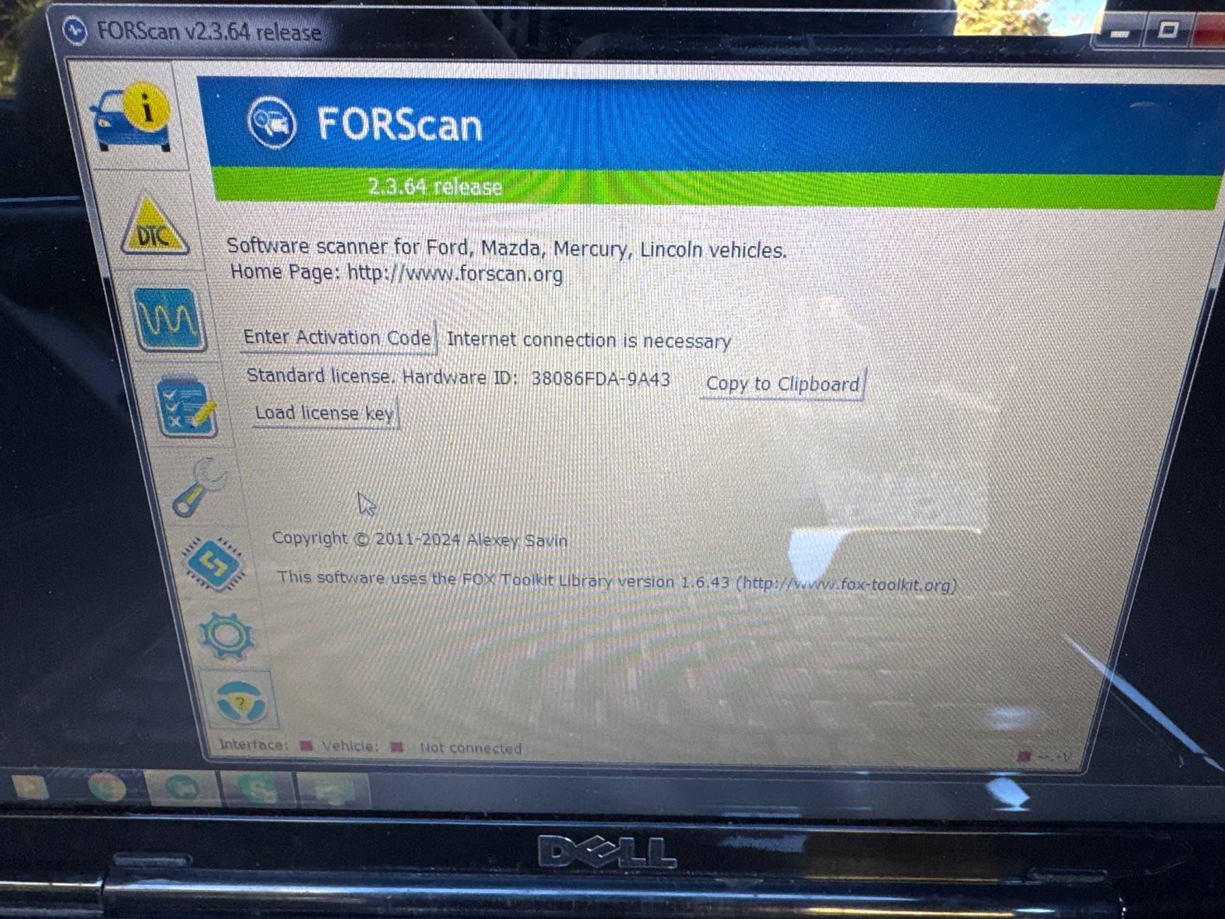

I have narrowed down what I think may have been a cause of all of the errors I was receiving after making all of the Forscan changes last night. Any forscan advice will be greatly appreciated.
When I initially tried to write the changes to the IPMA, I got an error message on forscan that said "incompatible configuration unable to write" or something like that. It was in red lettering, which I have never before seen in Forscan. After that, I tried writing the changes for each section individually. There are two lines that I think may be causing my issues:
IPMA
706-02-01 *xxx xxxx xx-- (3 to 7)
Mine was a "2" and this is where I got the incompatible error. I programmed the rest of the IPMA without issue, and left this as a 2 because there was nothing that I could do otherwise, it was getting late, and figured that I would give it a shot see what happens. Well, I saw what happens, not good.
There was another IPMA line that is different but it didn't cause the incompatible configuration error when I tried to write.
IPMA
706-16-01 xxx* xxxx xx-- (9 to B)
Mine was "A", I changed to "B" and it wrote without an error, but I wanted to include this in case it is relevant.
All of the other Forscan changes matched the change sheet by @hturnerfamily and in the OP.
One or both of these lines are my best guess for what caused all of my error codes. I was getting "Front camera error, service required", "Lane keeping unavailable, service required", and "Pre-collision assist not available" messages on the dash every 2-3 minutes. I even got the Pre-collision message on my FordPass app.

Programming went much better this time! Everything seems to be working correctly and all error messages are gone after the CCM calibration. I still get the "Adaptive cruise not available" message when trying to engage, but I'll try again in 90 minutes or so after the rest period like others have had to do.
I learned a ton about forscan under the guidance of everyone, thank you for your help and patience.

Success!
Ford F-150 Lightning DIY: Installing ACC (Adaptive Cruise Control) and LKA (Lane Keep Alert) to 2022 F-150 Lightning XLT ACC
Two weekends, lots of stupid mistakes, and then finally ACC and LKA success with all of the credit given to this community.
Go slowly, double and triple check you work, don't rush, and make backups of all of the Forscan modules before you start tinkering. I made backups, but I need to heed the rest of my own advice :facepalm:
I did not have any existing wiring to complete this, so I used the method of running 4 new wires from the IPMA to the new CCM ala @Azgunguy , @ZSC100 , @tannerk89 , & @rio .
I have attached the forscan values that I needed to use for my truck which are highlighted in yellow, in contrast to the OP from @Brotato . In discussion with @ZSC100 it seems like the 2024's have some different values. Please learn how to use the master forscan spreadsheet from @Livnitup . This is what I skipped on my first attempt at programming and I then needed to revert everything with my forscan backups.
I learned a TON about the truck and forscan from this mod. It is a PITA, but it's really rewarding when it's all finished and working correctly.

Forscan no longer works, i ordered the obd link ex and ask for a license. Forscan no longer has license
