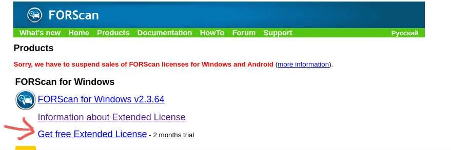

Does this option still work?
"Get Free Extended Licence"?
I am waiting for them to reply back i put the info in and said it can take 30 mins, we will see
Nothing it does not work and they don’t send any license info
I feel like there have been a few other forum members that have run into this and said that the free licence still worked for them. The only thing I can suggest is to be patient and see if you get any response, or try to find someone close to where you live with an active licence that doesn't mind helping you with a forscan session.

Note that I don't believe they "send" you the free license. After requesting it you are then instructed to refresh the confirmation page after about a half hour. Did you try that?
i can try it in a bit,

Yep I just did this the other day. You aren't sent anything. But when you refresh that page or visit it again and click submit, it will either tell you there is already a request pending (and wait) or give instructions for downloading and installing the license key it generated.
Just read the page carefully and follow the instructions.

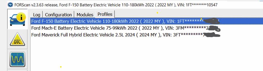

k everything was installed the only thing that doesnt pop up on forscan is the c-cm. is there something im missing?
1,890
2,661
o
Haven't read the whole thread - but if this is a new module you've recently added then you need to not use your stored profile in FORScan. It caches the modules you have and won't scan for new ones. You need to delete the current profile and rescan from the start.
Go here:
Ford F-150 Lightning DIY: Installing ACC (Adaptive Cruise Control) and LKA (Lane Keep Alert) to 2022 F-150 Lightning XLT 1736907792488-7s
Highlight the Lightning profile and then click the trashcan icon at the bottom. Then do a connect. It will prompt to create a new profile for that VIN.
