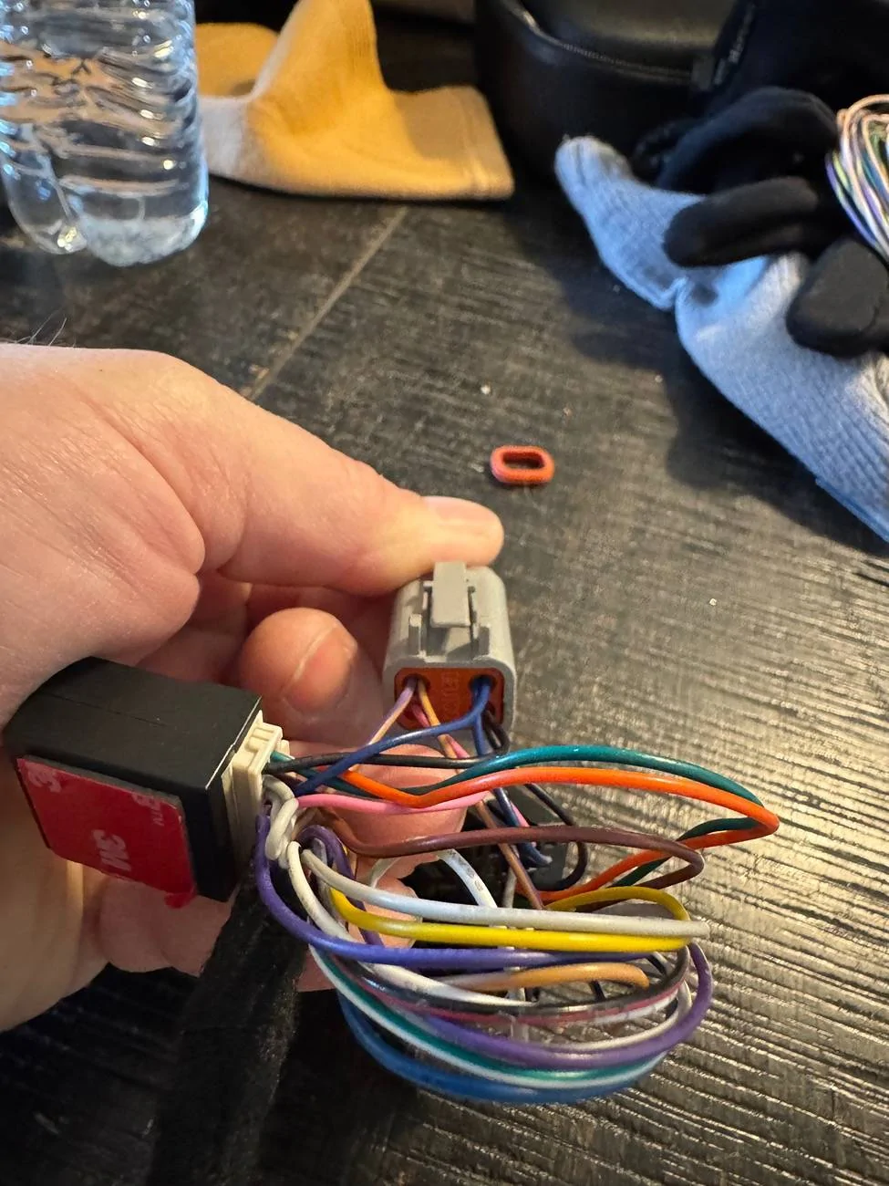

get a 24 ccm and the wiring for the ccm and then you can get a deutsch connector to attach it to the ccm wiring, get rid of the other parts of the wiring and what wires you have in it match to the closest color and simply drill a hole put a rubber plug in the firewall and inside you dont have to cut your wiring fold it over and put a deutsch connector in it. and then on the other end put a connecting deutsch. essentially there is one under the hood and under the interior

also go to the comma ai website and order a q4 harness, its 90 bucks but you dont have to cut your factory wiring. its in the experimental area, here is a closer look at mine since i know it works im going to redo it to tie it all together.

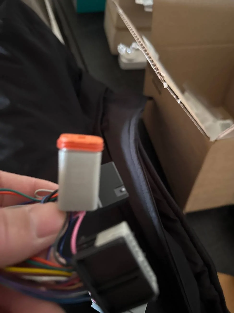

as you see mine had all the wires and i just eliminated them and built it because it had the right plugs to use for the truck wiring from the comma ai website. If you get the harness from them let me know i can tell you what wires to cut and splice into

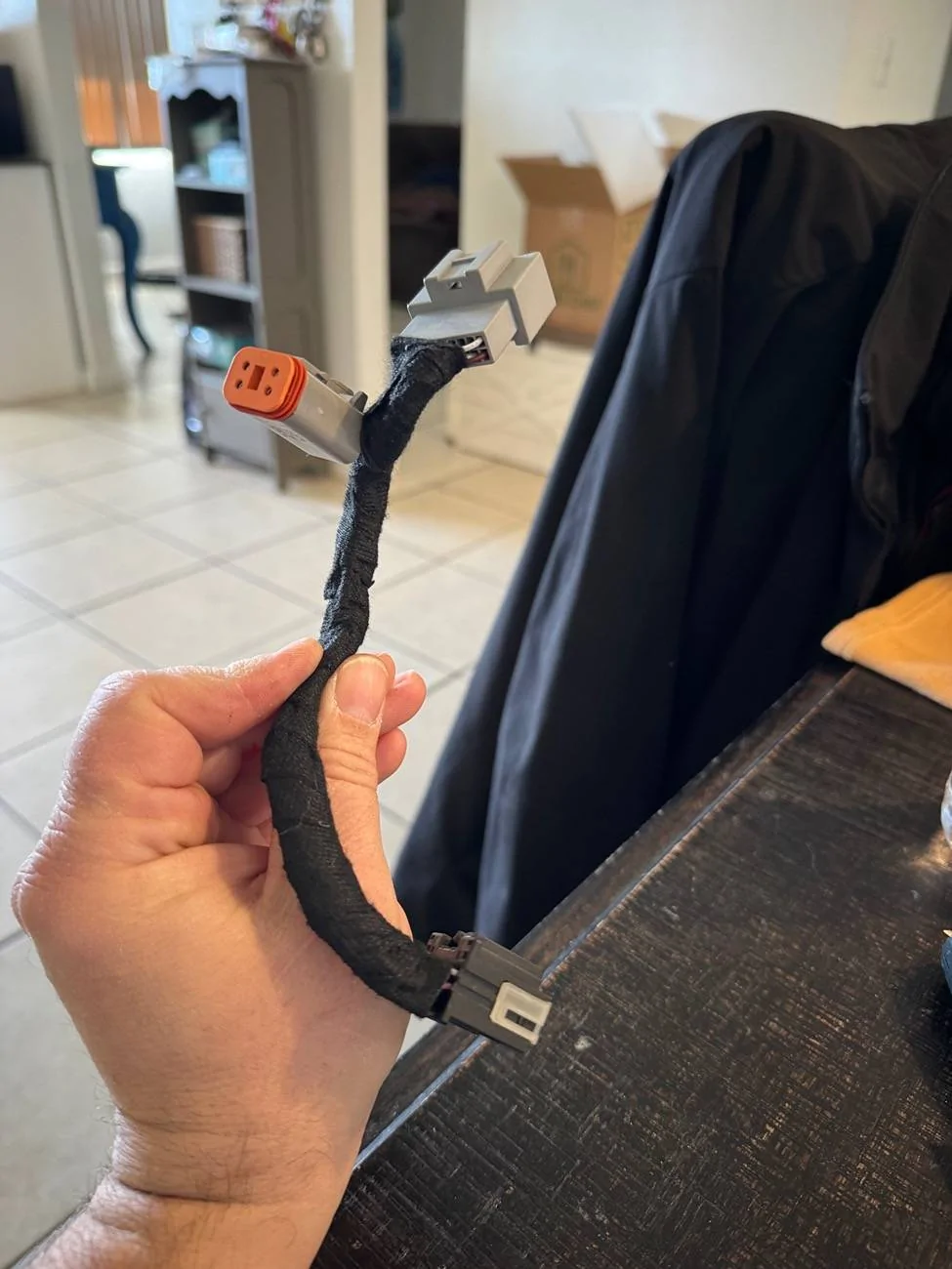

like @B177y you don’t necessarily need the harness but does make it easier to plug into the ccm and then strip it and use the scrap harness for your harness and all you have to buy is ccm, harness, deutsch connectors, and the comma ai harness (if you don't want to cut up your factory harness) programming is easy. just like all the information in the forum, makes it easy. don’t get thinking or it’ll freak you out. there is another forum too that shows what numericals your truck is that is a good guide just in case you change the variables on your asbuilt and can’t get back to square one if there is an issue(ask i will tell you i hankered it up pretty badly and had to resort back to this because i tried to go the easy route on forscan🤦‍♂️.) https://www.motorcraftservice.com/AsBuilt

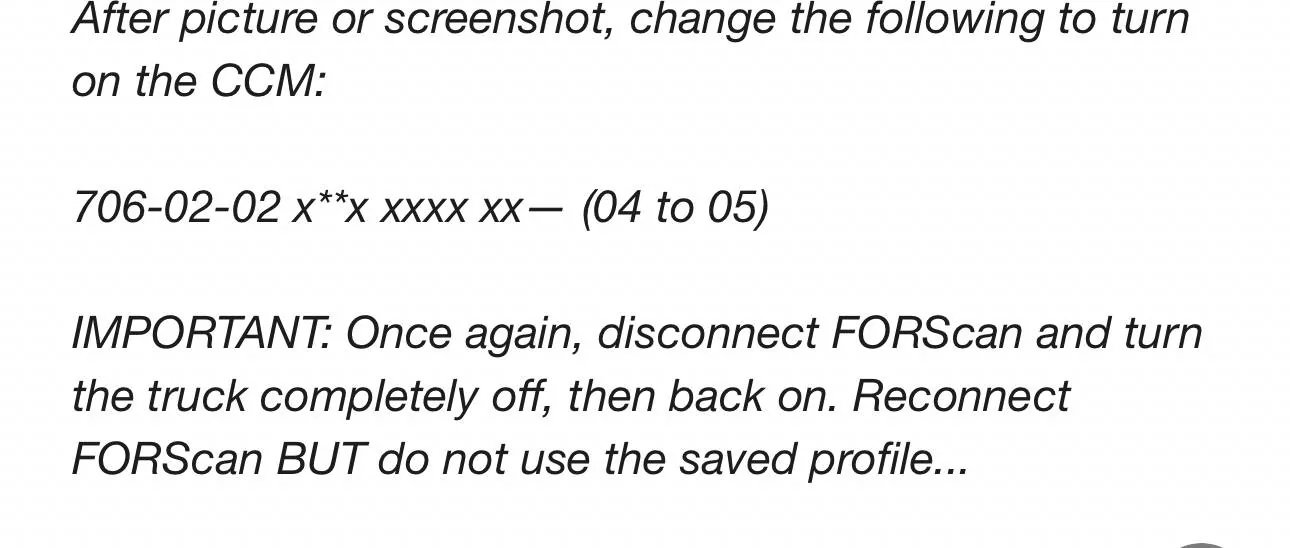

also ensure when you get in there if you do to first to see if your values in the ipma is turned on to power up the ccm. I had to look through all the forums and found it. So with just these two pages minus the programming which i have screenshots of i can send aswell, it will take you less time maybe 3 hours. then all of 5 days it took me🤦‍♂️

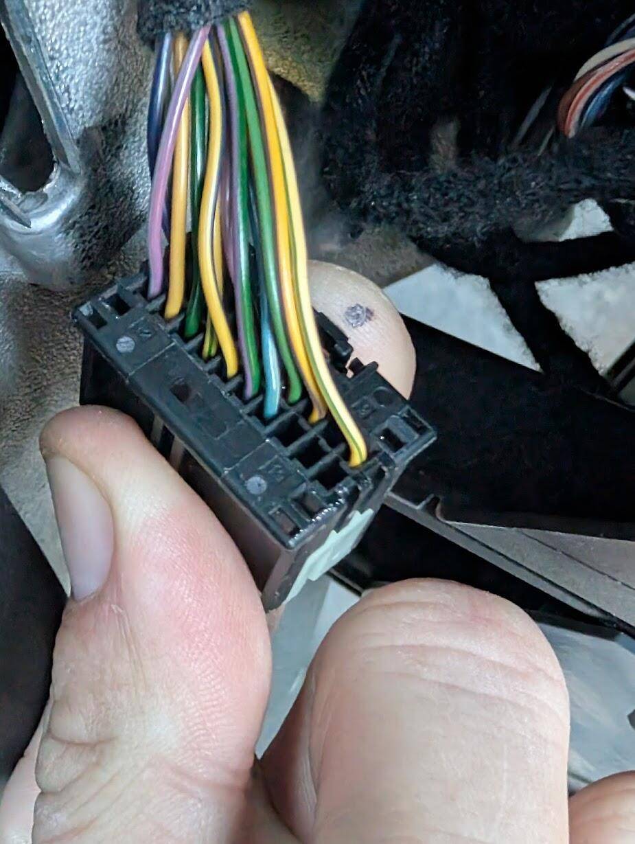

The driver side is where I don't have the wires, hence my sadness lol

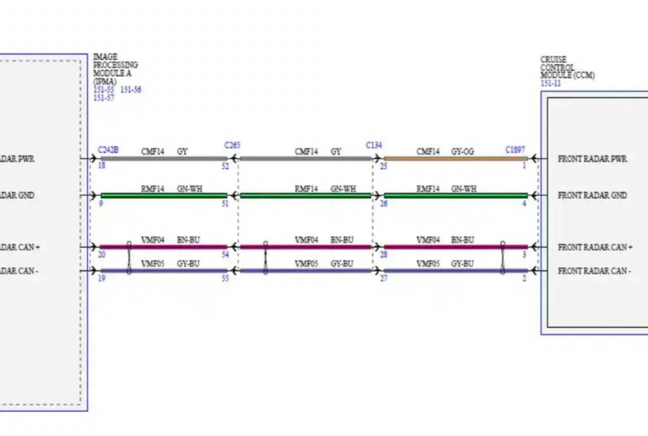

Did you run directly from this connector to the IMPA plug on the driver side?
you can buy the ford pins to plug into where you have no pins thats easier then splicing and then run directly to the ccm. you just have to pop the cover off the clear piece then push the new pin in. its just adding pins
No need to be sad, this is where you are adding the pins and wires, into that black harness. Then you run those wires to the new CCM connector. Add in the deutsch connectors along the way to aid in disconnecting for maintenance. Then Forscan your changes. Then you have ACC/LKA!
that is cheaper, good catch. and then deutsch it and pin it in the back
Yes that's what I did it worked great. Best mod you can do. The pig tail from ebay is made just for doing this. Only has the wires you need the ones you don't are sealed off so it is water tight.
