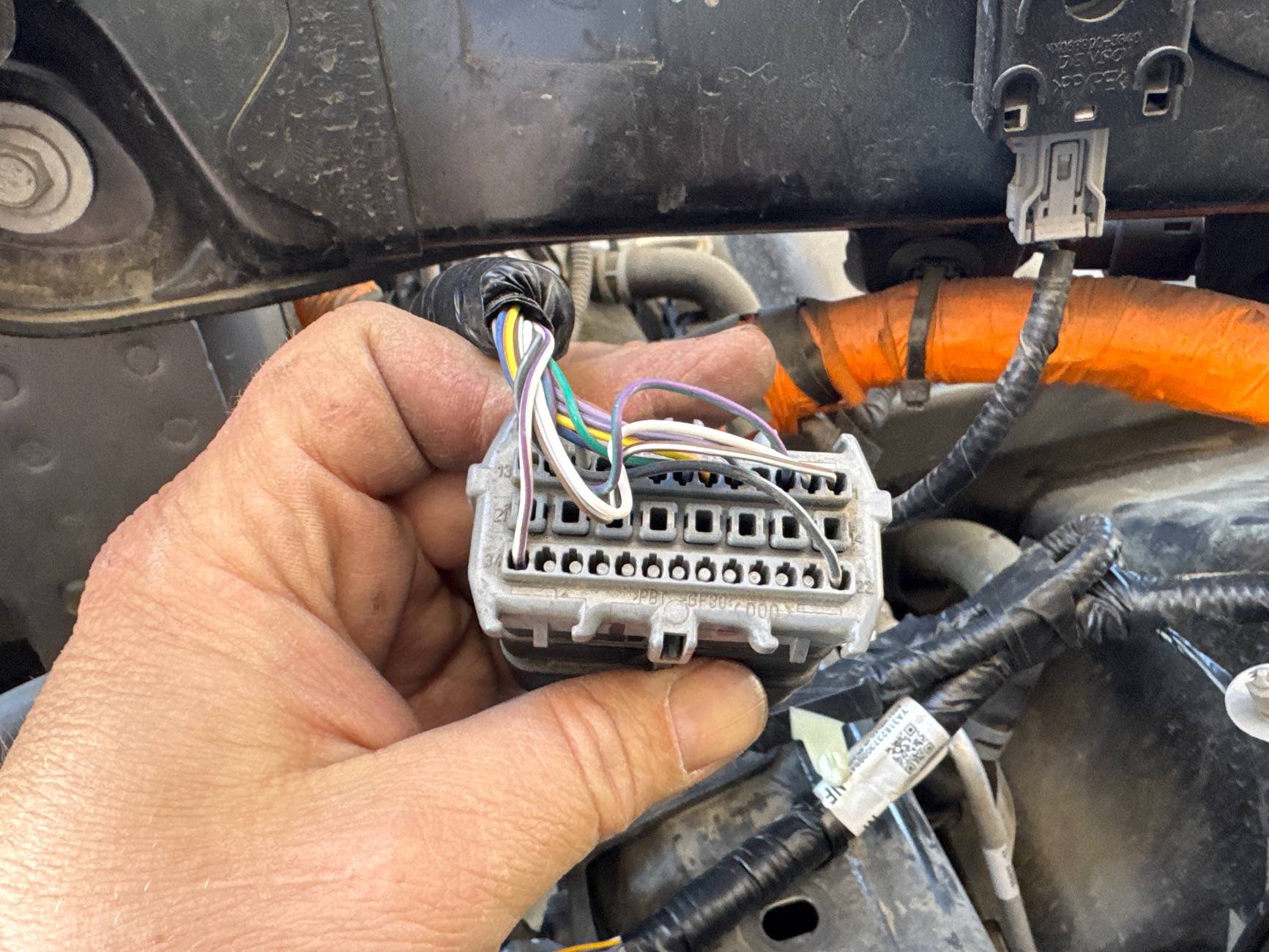

FantastIc work Zach. I have a 23 Pro with tow tech package and have been working with Brotato on getting ACC in my truck. For some reason his 22 XLT 310 package had the correct wiring. We have installed all of the hardware but like most others, we are missing these four wires in my install. Thank you for the video. That is super helpful.
I dug into my passenger side kick panel and want to ensure I am looking at the correct C265 connector. I have attached a photo for confirmation. So you just removed the pins from the connector and directly spliced into them? How difficult was it to remove those pins from C265? Doesn't appear there is a lot of space in there for my hands.
I have ordered wires and pins and hope to have success in the next couple of weeks. Thanks again for all of your help with this.

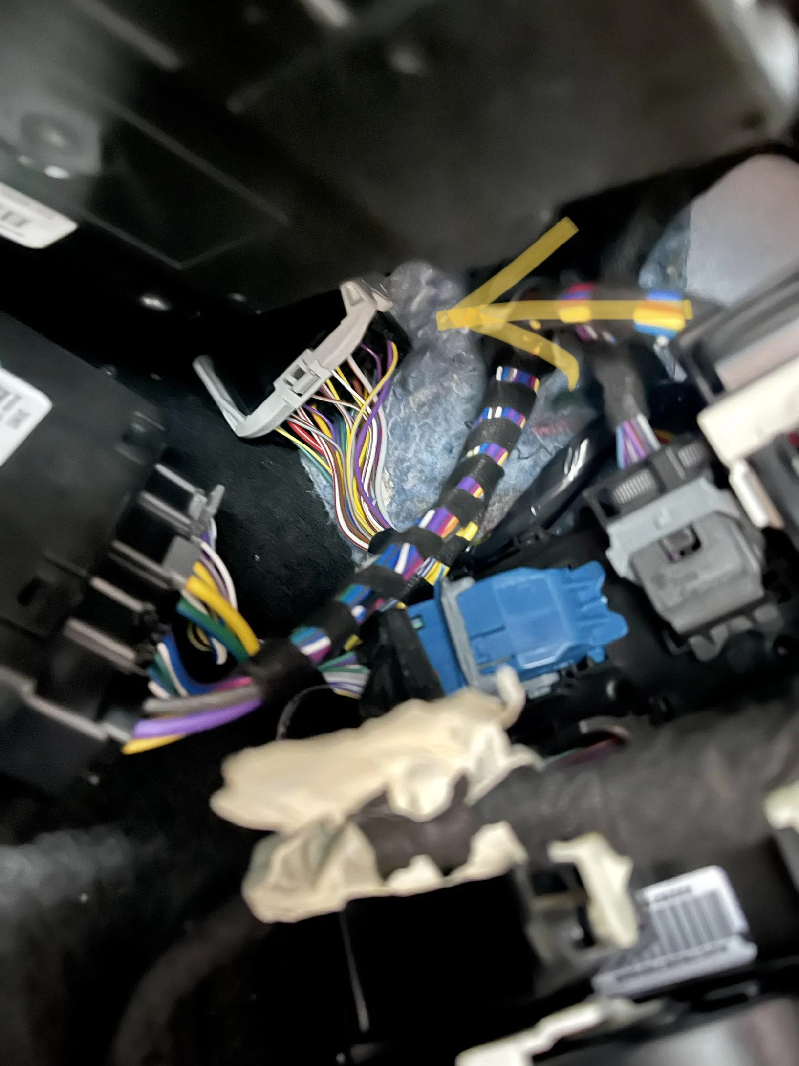

does it matter if you go from passenger or driver? driver seems easier. I just tore everything apart again and found that I was missing the 4 wires at the plug🤦‍♂️22 lightning xlt
watts/up
Apr 2, 2024
58
23 Pro SR
I think you can go right from the IPMA plug (driver's side, right?) to the CCM harness (C134, missing wires, right?). I believe some have done that, bypassing C265 under the glove box. You may want to check this post and read the ones following it. Not the same situation, but I think similar. I believe the part numbers for the connector pins are provided in responses to it if you need them.

I think you can go right from the IPMA (plug driver's side, right?) to the CCM harness (plug C134 missing wires, right?). I believe some have done that, bypassing C265 under the glove box. You may want to check this post and read the ones following it. Not the same situation, but I think similar. I believe the part numbers for the connector pins are provided in responses to it if you need them.
seems like it would work.

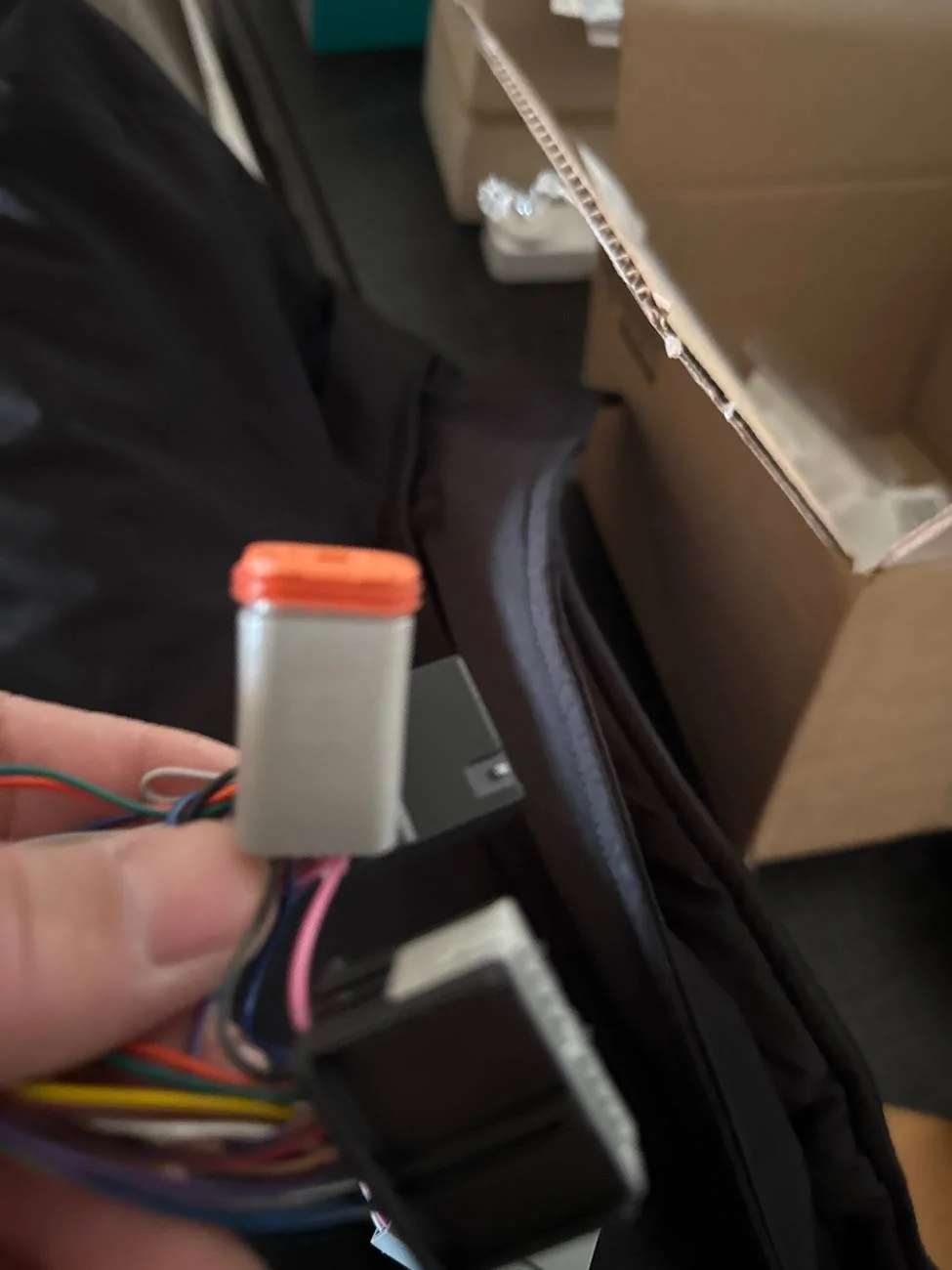

ok I’m on the mends it works, i rewired the acc straight to the plug on the driverside and deustch plugged them. I just drilled a seperate hole put a rubber firewall plug and then ran my wire through that
Ford F-150 Lightning DIY: Installing ACC (Adaptive Cruise Control) and LKA (Lane Keep Alert) to 2022 F-150 Lightning XLT IMG_1519

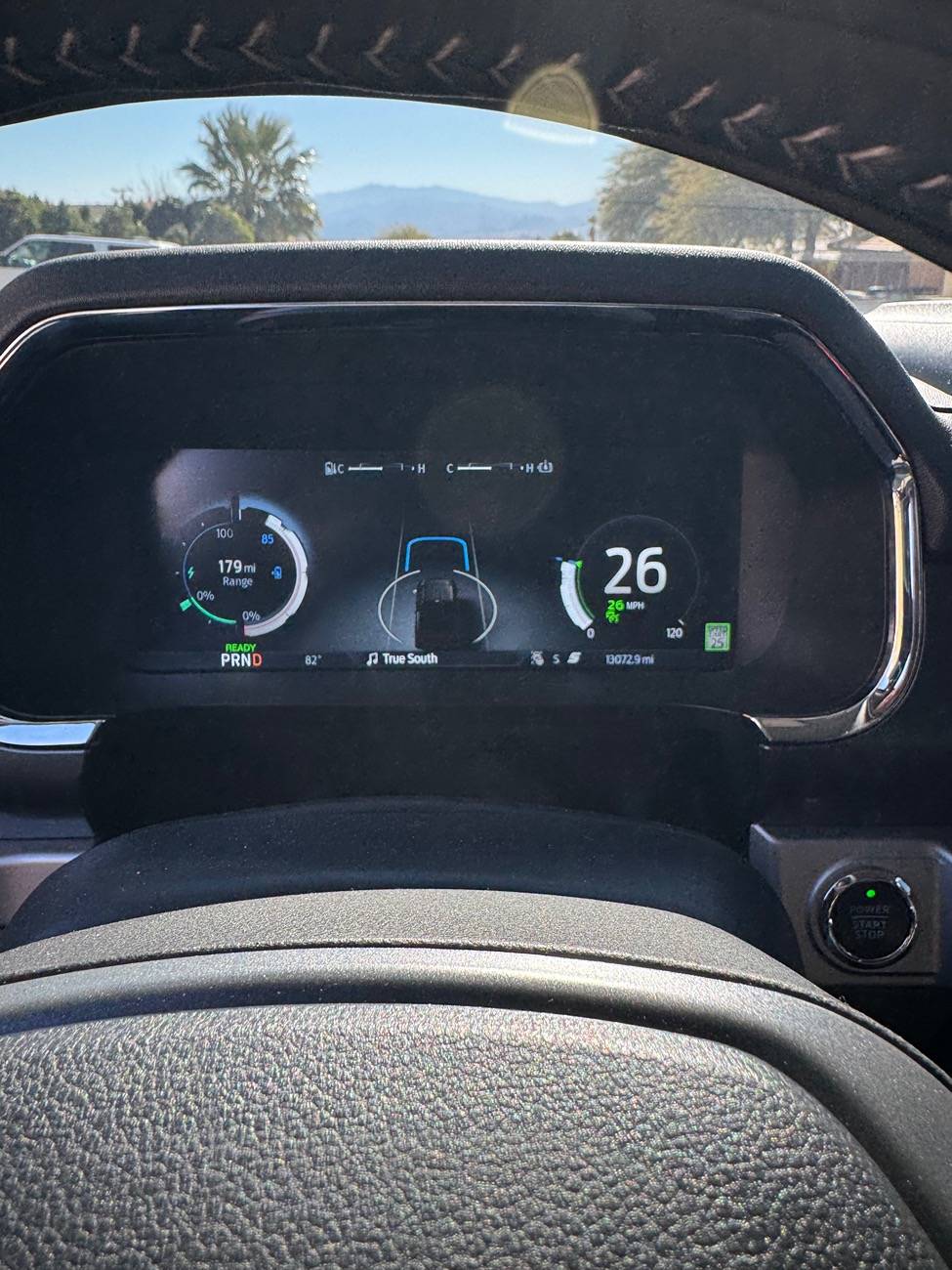

ok now i got the steering wheel switch installed and works flawless
