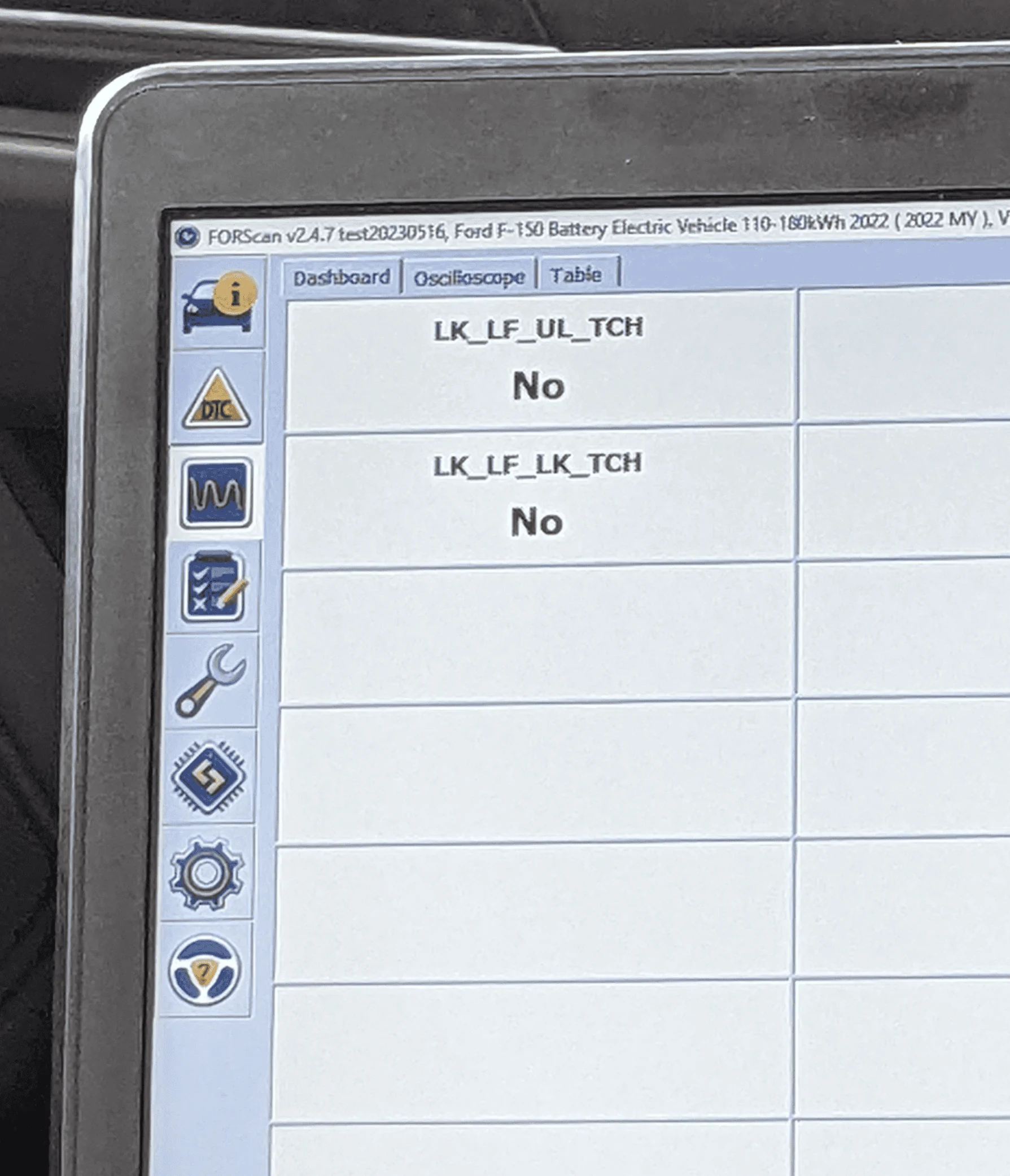

Yeah, on the left, it's the icon that looks like an oscilloscope trace.
Ford F-150 Lightning DIY: Installing Passive Entry To A 2022 F-150 Lightning XLT 1686775949044
You have to click the settings icon at the bottom. Go to the BCM and search for these two PIDs. Once you get them moved to the right exit setup and press the play button at the bottom to monitor the parameters live. When you put your hands on the capacitive buttons of the door handle, you should see both signals respond. When you have this working then you are ready to do the firmware update.
Do I need to do anything aside from hook everything up before doing this test? I haven't made any changes in Forscan or anything, but it doesn't respond to my touch at the moment
Ahhh yes you do need to make the config changes before it will power up and respond to the new handle being there
Ha, yeah, I figured so that's what I just did and everything was working so I'm about to flash the firmware!

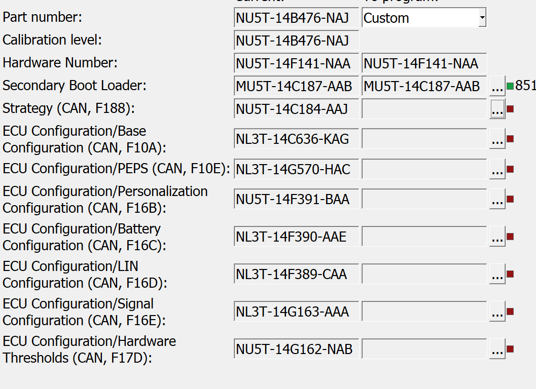

Ok, now I'm confused on the firmware update. Am I supposed to put those values into a file for the system to write? Also, I don't appear to have some of the sections that you had values for, is that an issue or do those values overwrite?
