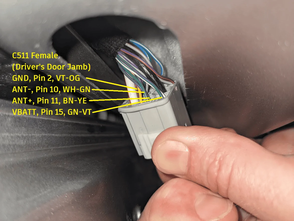

You don't need a dealer if you just order the two parts I listed. So what if you don't use a few of the connectors, just zip tie them out of the way inside the door. Go for it, be the first Pro owner to try it. You can start by checking your C511 Female plug to make sure you have the ANT wires from the door jamb to the BCM.

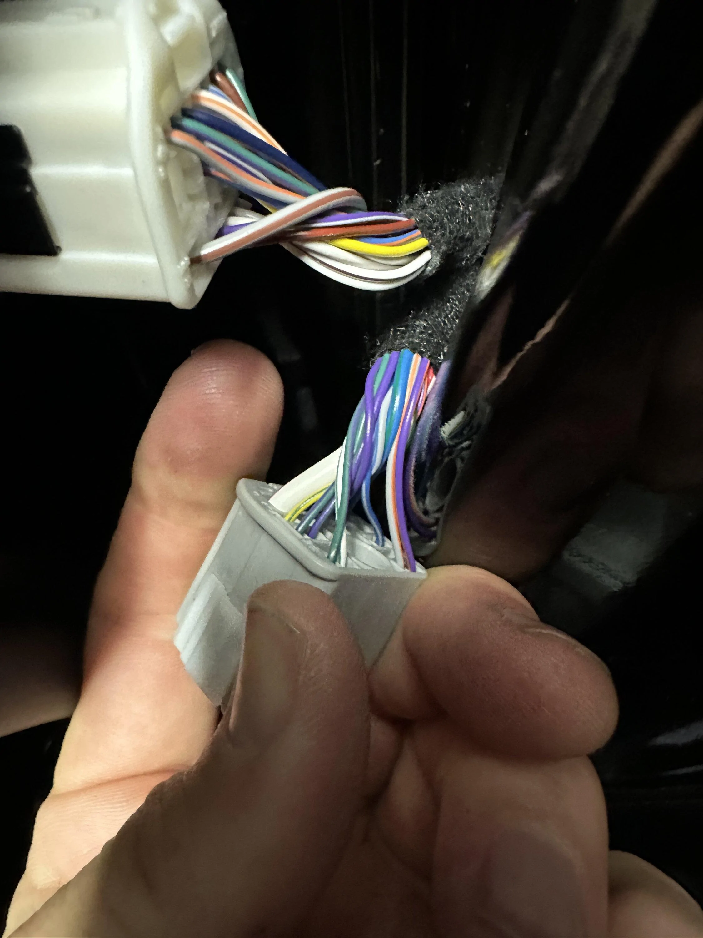

It took me a while to get the door jamb plugs exposed- I went out of town and then had to get the pick set once I returned. That said...I got it open today! It looks to me like I have them. These are the right plugs, right? (see attached)
Also, this part has the passive entry hardware right? Then I use my existing door handle with the insides of this?

Yep, great job,, yes ML3Z 1522405 DCPTM is the correct handle. and yes, you are basically buying it for the module inside.
