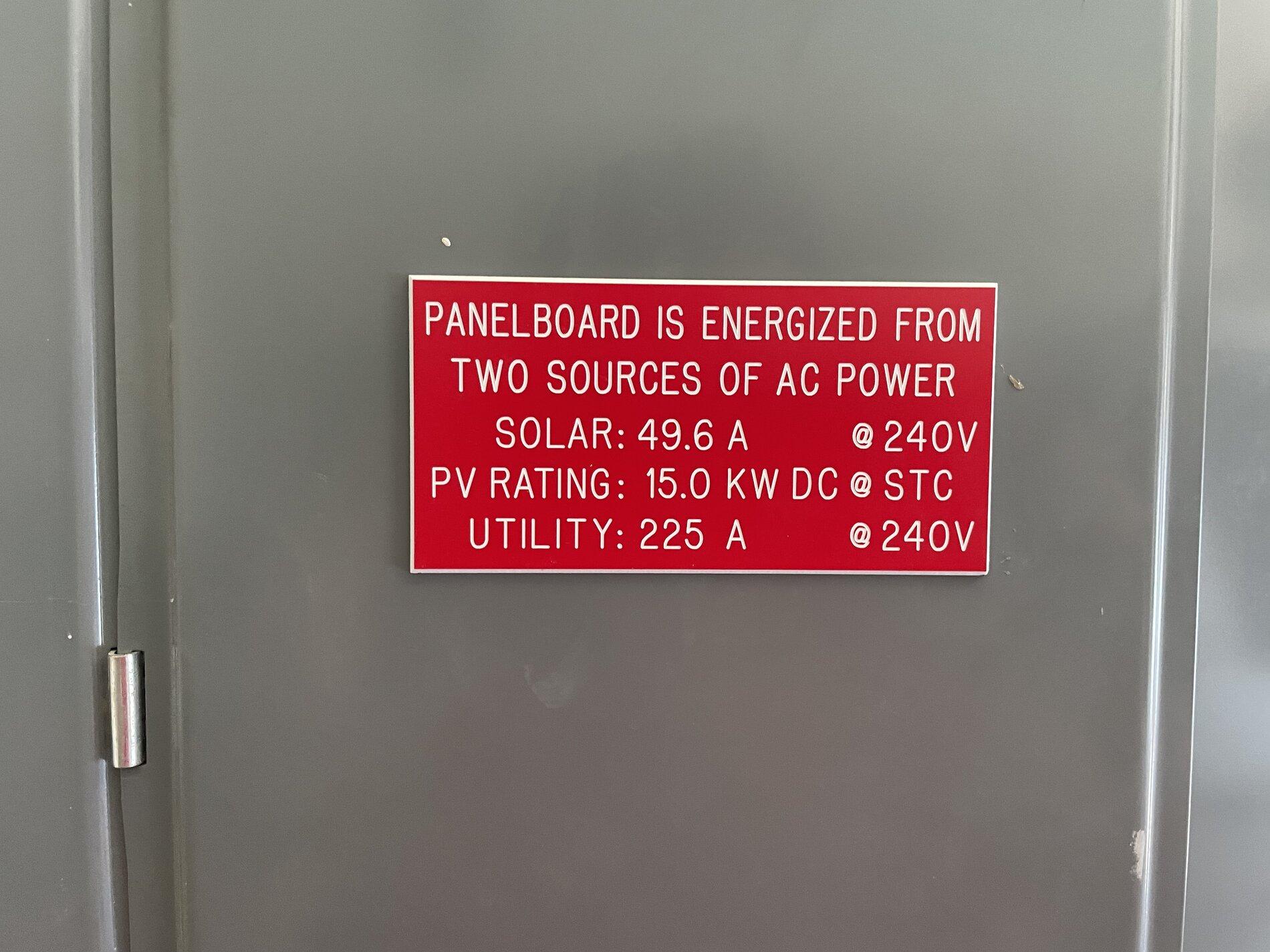

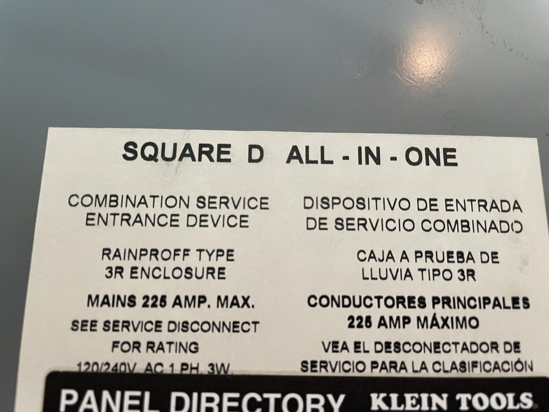

If you give me the part number of that panel, I can check it for you. It doesn't look like an all in one that is printed on the sticker. A 30 space panel is typically rated for 40 circuits. (They don't allow you to twin more than 10 spaces. The bus tabs are designed to prevent more twinned. I have inspected many many panels where the electrician simply breaks out a tiny piece of breaker plastic to bypass the limit).
** 14 years as owner of Winters Electric up the road from you in Tahoe. Sold it 4 years ago and retired. I've seen it all. Thousands of cabins added on and so many hack jobs up there to squeeze in heat tape circuits.
I know everyone up there. What three companies did you use? I did at least 50 panel changes with NV Energy per year. I don't know why you say NV Energy is "strict". They follow the NEC code. I installed a few Tesla 100 amp charges for Ray Sydney, one of the founders of Google. If you really want a 400 amp service, get ready to pay big bucks to NV Energy for upgrade of their lines and get ready to pay a big demand charge.
This is what I have on the panel see attached pictures

Perfect. You have all the data you need. On Sept 18th your peak was 40 amps.
Re-label that panel. That is the most dangerous thing I see with your panel.
Upgrade your 40 amp rv breaker to a 100 amp breaker as you planned to do. You will be perfectly OK. Prove it to yourself by turning on your A/C's, stove top burners, oven pool equipment and run the dryer and report back what your peak is...
