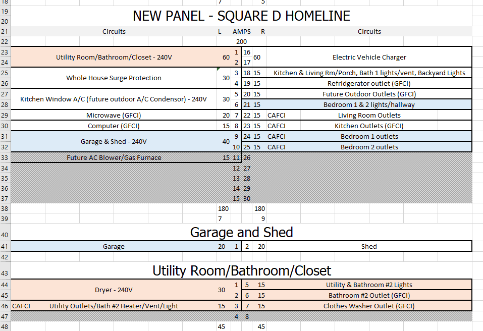

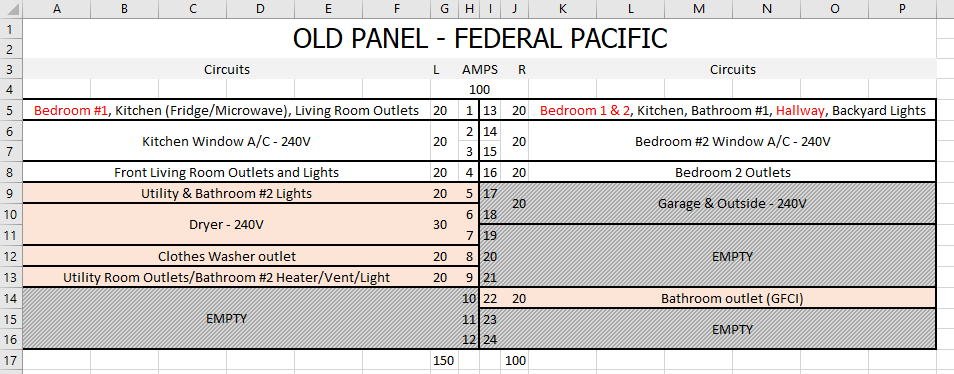

208V is only on three phase if you are in an apartment or commercial building. OP is not in an apartment, so its single split phase 240V with 200A service.
I'm in the slow process of rewiring my house, so I am going from 100A to 200A service
I chose to use a 60A breaker for Ford's 48A charger. Not sure how well a 100A breaker will work in that panel, I'd have to rearrange things. (light blue is things I've completed)
Will be going from.
Ford F-150 Lightning Do I need to run new 400 amp service in my house for the Lightning + everything else? uMVckZl
To this:

thanks for sharing the panel details. I am replacing a square d split bus panel with an Eaton CH panel and planning on a 100a/80a ev charger. Need to more research on available hardware available and costs to decide on final rating but 80a would be the minimum.

IMHO - (I am not an electrician, just been bit in the butt enough with my recent garage remodel to offer my input) If you are installing new wire/breakers for the Ford 48A charger as part of your upgrade to 200A, I would HIGHLY recommend you go ahead and build that run out for 100A. Sure right now you only have 48A. But I do not believe Ford will be the only Co rollling out higher amp setups moving forward. The cost of the heavier wire and breaker now will pale in comparison to having to try and rerun with heaver wire later when the new hotness EV hits the market in 2yrs and requires 70-80-90A. Consider it futureproofing.
Case in point I just rewired my garage 2yrs ago now, ran 30A 230V to a few places, wishing I had run a heavier run for one of them to be able to handle the 48A charger. THankfully I have room on wall under the panel and next to it, so I will just have to have electrician run a new shorty run to connect the Ford chargers
