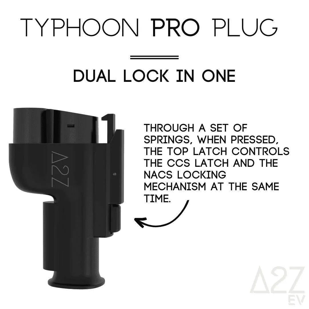

I have the A2Z Typhoon Pro and it works no problem. A2Z just issued a recall on their V1 adapter but they're working on calling those back and replacing with the V2 which is the Typhoon Pro. Reason for the recall was that Tesla didn't like the manual locking mechanism holding the NACS handle to the adapter.

You may also want to consider buying the package of the SuperCharger adapter, Typhoon Pro, and the Destination Charger adapter, Stellar, because it's a great deal. Use code FORDFORUM to get the best price (see below).
A2ZEV makes the Typhoon Pro adapter for Tesla SuperChargers. It sells for $189.00 ($170.10 after using code FORDFORUM). They also sell the Stellar adapter, which is for Tesla Destination chargers (such as hotels, private homes). It sells for $111. If you pick use the dropdown menu on the Typhoon Pro page to pick the Stellar adapter also, the combined price is $270.00 ($243.00 with code FORDFORUM). In other words, it’s only $72.90 more for the destination charging adapter. They are currently shipping quickly. I have both adapters and have used both many times. They work great. https://a2zevshop.com/products/nacs-ccs1?ref=Typhoon&variant=43186507579592
