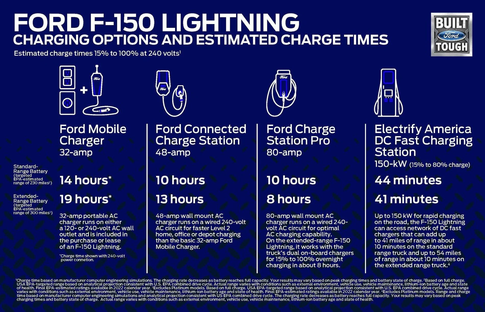

This infographic shows the charge time differences for the 48amp...
If the 80amp comes standard for the Extended Battery, does the 48amp come standard for the Standard battery?
